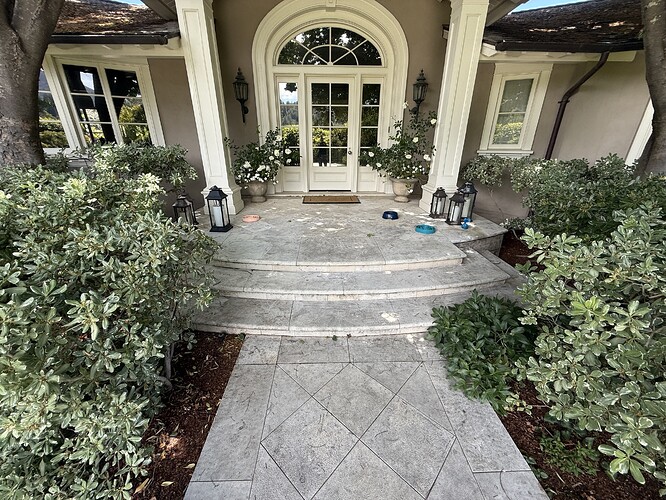

instead of starting a new “clean travertine thread”: I have a client with a travertine driveway and he wants it PW monthly! l will be replacing the guy in the picture. There have always been light tire marks. The former cleaner used Simple Green and an orange degreaser. There is a great deal of landscaping up to the edge of the travertine. It is chisel edged travertine that was sealed about a year ago. I am seeking your wisdom as I do not want to replace $$$$$ of travertine.
Not sure I’d want to work with anyone stupid enough to put down travertine on a drive but if you’re cleaning it monthly, just ds some EBC on it, that’ll get rid of tire marks when you surface clean it.
thank you @Racer I said the same thing to him, super nice guy that worked smart and hard for what he has but I have no response for this life choice! lol
As a window cleaner trying to increase PW revenue I’ve been busy trying to learn this business, I dare not call it an add-on. There is SO much to learn and I want to get it right.
If you’re going to be cleaning it that often, get your surface cleaner pressure down to about 2000 psi. Do you know what they sealed it with?
no sir. He said it’s been cleaned at least 6 times since. I know the GC and will find out who he used.
Just see if you can find out the product they used

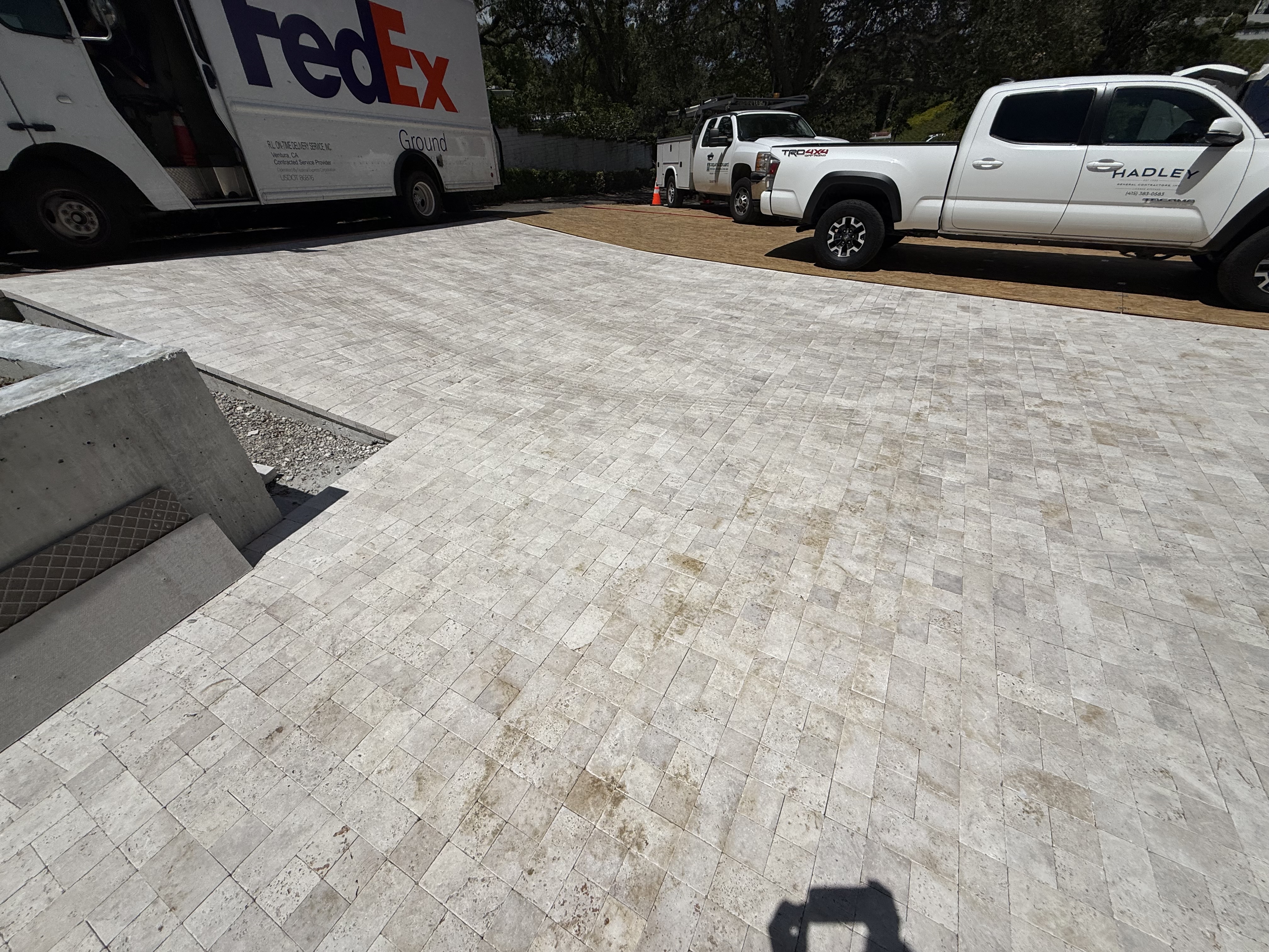

Bidding on a high-end job that has about 800 ft.² of old travertine and they just put in a 3000 square-foot driveway. They had to go to 3 different countries to find matching stone, and the driveway is $180,000. No that was not a typo, $180,000! I’m going to lightly rinse off the new driveway before they put sealer on it but I need to make the older travertine look a lot newer to match the new driveway. Some stones are sensitive, would it be a bad idea to use SH on it? If I can what would be the max strength to use?
