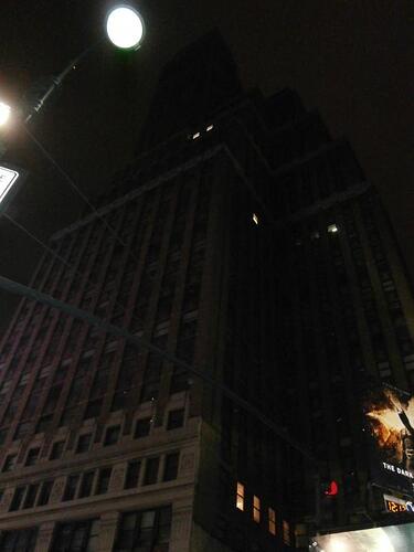

For awning cleaning we used different solutions over the years but we were very impressed by the one that Chris L. co-owner of this site sold me at his barbeque last year. We used them on a bunch of vita shops(we do around 20 of these stores in Manhattan) Look close at this one picture and you will see the Empire state bldg…
