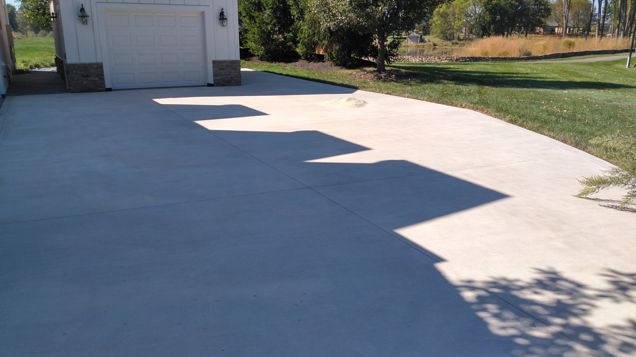

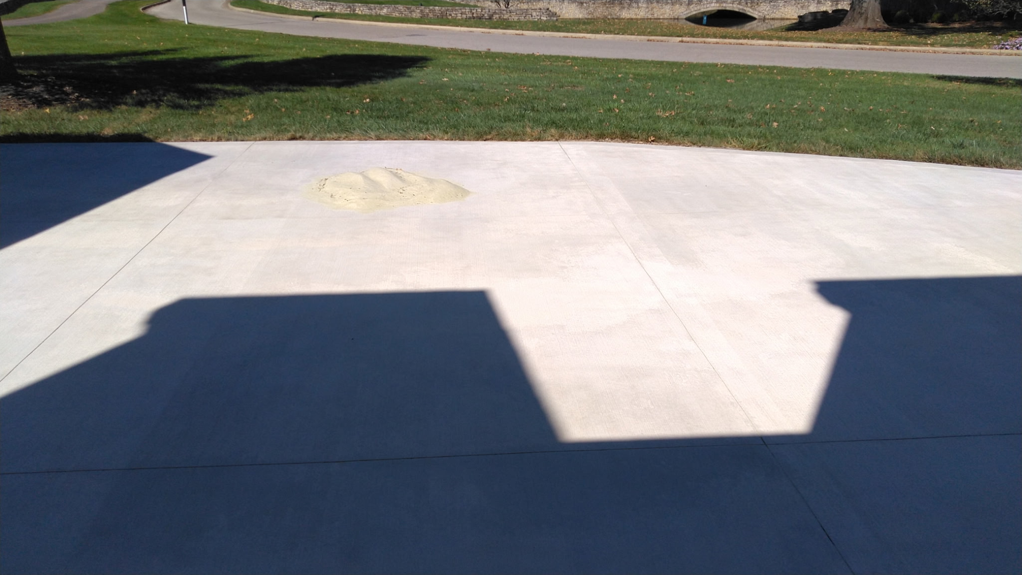

Can you show a pic? Just curious what it looks like after sandblasting.
Doesn’t look half bad. I’ve seen worse new driveways.
I would do a couple water tests on different parts of the driveway and make sure the water is truly absorbing into the concrete and not sitting on the surface.
