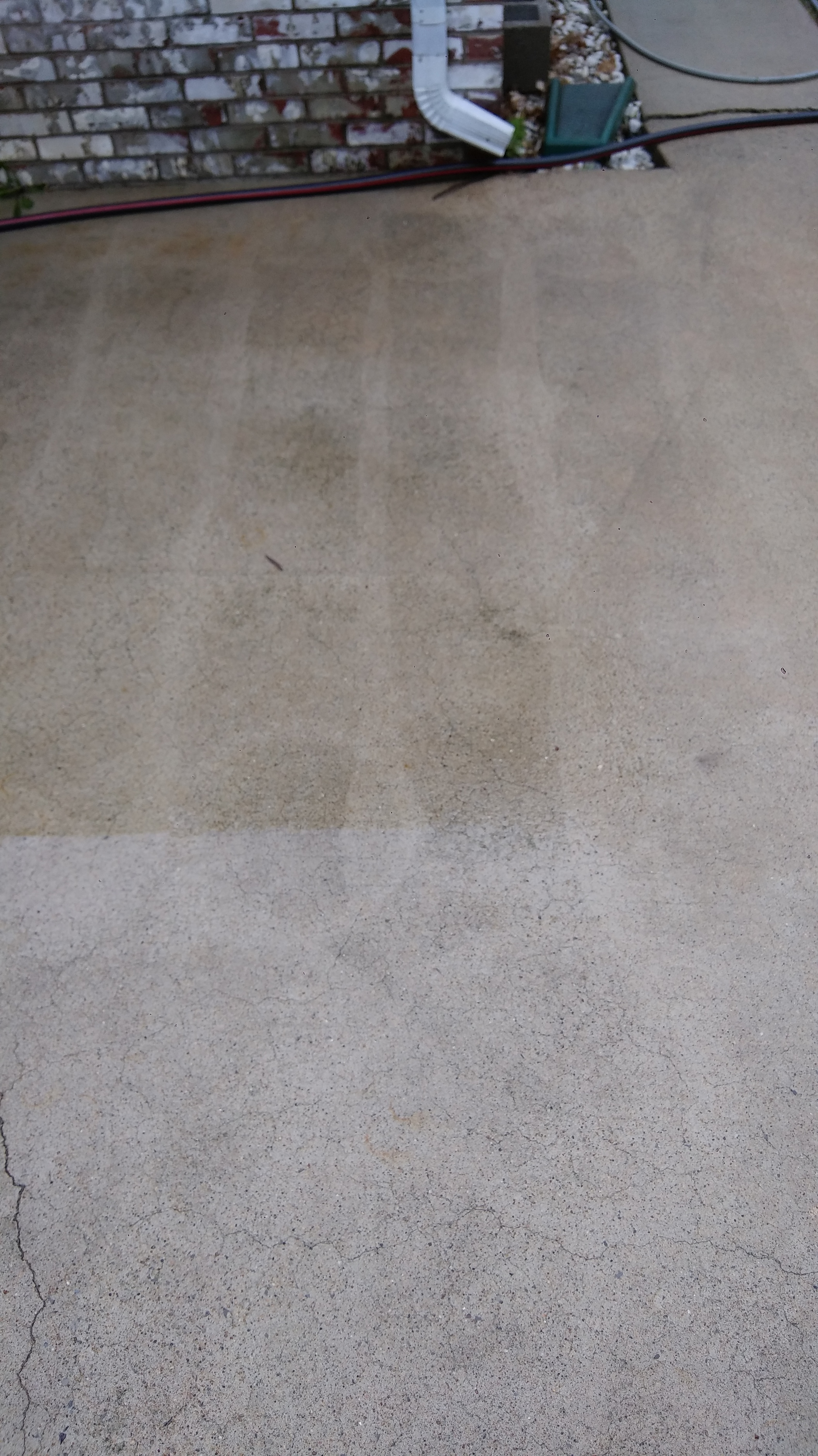

Clean strips when overlapping with surface cleaner
Anyone know of a way to NOT get super clean strips when overlapping with a surface cleaner?
It’s a very slight strip, and yes I know going over multiple times will get rid of them but trying to see if anyone else is having this problem…
Using a 3500 4.0 and a 20inch SC
Just looking for solutions
Thanks a lot
Post treat. It will help everything look nice and uniform.
It kind of looks like it’s drying before rinsing. Rick has a great video on concrete. Try doing small sections at a time. I had to do that this morning because the temperature was so hot it’d start drying within about 5 minutes. In Mississippi during the summer we have air you can wear.
