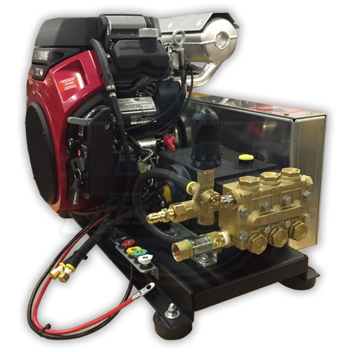

From my reading here, I’ve seen a few machines mentioned, and was wondering if I’m on the right track, or if you could please suggest alternatives? I know I’ll need a surface cleaner, so the last link includes one in the kit, just unsure of it’s quality. Also, to clean the chemical buildup on my PVC walls, is a higher PSI more advantageous than GPM? Here are a few that I’ve seen mentioned here and are considering:
http://www.powerwashstore.com/P/2831/EagleSeriesBeltDrive4.0-4000NoEB4040HA

1st one is fine in my opinion. Even though it comes with an AR pump, I’ve never had any issues with AR pumps.
2nd link —I don’t believe you need all that stuff for a car wash business.
