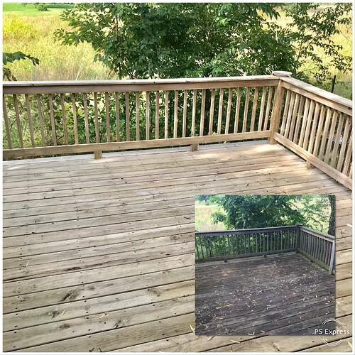

Here’s one just did couple of weeks ago, guy selling house and just wanted it cleaned and it still had remnants of 5 year old stain showing. Still had to hit every board and every picket.

There’s your problem, you make it look too good without stain…
Impressive Rick.
I can go with that as well. I swear there wasn’t a picture when I replied to this yesterday. I must be getting old.
