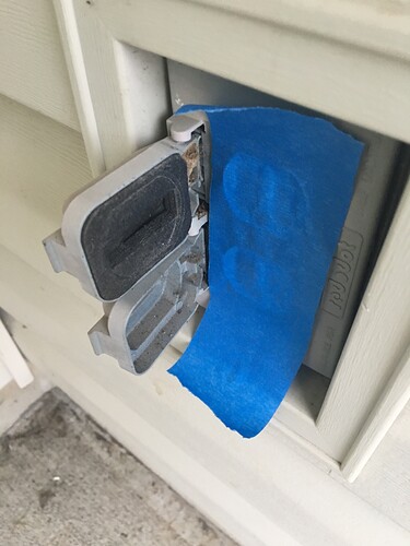

I read once that the plastic kiddie plugs work for keeping water out of outlets that don’t have the covers. Good advice?

I’d have a hard time trusting it. The edges aren’t sealed and could potentially channel water in by capillary effect.

@HookNLadderPW just a wide strip of painters tape. Painters tape is supposed to be hydrophobic.
