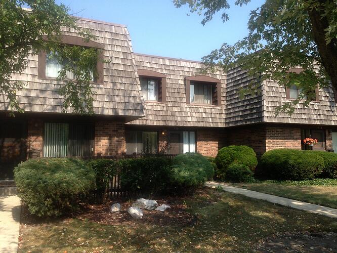

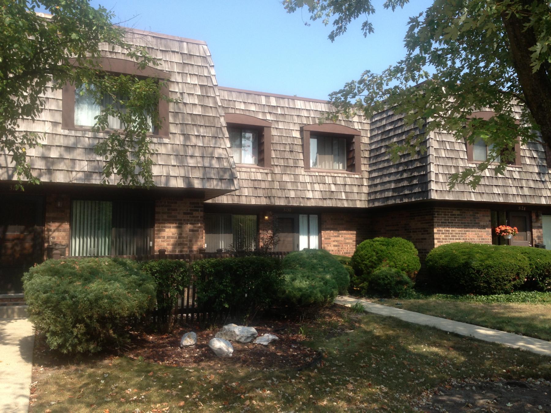

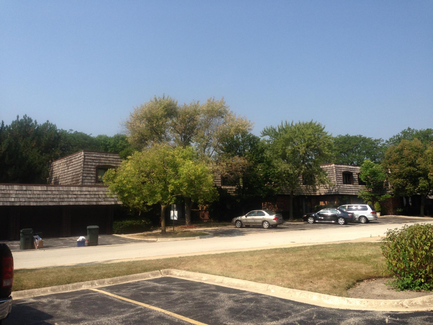

bidding a large townhome association with 10’ mansards basically the entire 2nd story, unit has a flat roof, I have only done and priced out cedar shake roofs before - never done any siding…do you guys charge the same for siding as you do for roofs? I upped mine a bit only becuase it’s gonna be a pain cause i’m either gonna have to scaffold or place stages on ladders… lots of setup work… cant get a lift in due to a ton of landscape and trees.
planning on just spraying with SH, low pressure rinse clean, and applying a neutralizer… no stain or sealer wanted…
total SF 14,280 was planning on being around 0.65 cents per square foot… sound reasonable?

it’s more like cedar siding than roof…more worried about being to high than being to low…It’s a pretty big property management company I do plowing for, they have a ton of properties for power washing work, so getting this job could open the door for a lot more… not to worried about making a ton of money off of it, in my mind my price covers me plus a little… just want to see where everyone else would be at - like I said don’t wanna be to rediculously high… I charged what I normally get for doing roofs - like i said although this is siding, it’s alllllll ladder work… I have stages and scaffold but cant get a lift in so it’s gonna be a lot of up and down…
