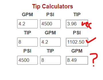

Hey, got the Harbor Freight Predator 4.2 gpm 4500 psi pressure washer last week when it was 30% off (Friday 7/24/26). I wanted to have you sanity check something. If I want to maximize the flow rate of my 40 degree nozzle tip so that it gets as close to the max 4.2 gpm flow rate as possible, can I just use a 8.0 orifice size for the 40 degree nozzle tip? Additionally, if I use a foam cannon with a 1.7 orifice instead of the usual 1.25, would that work to lower the PSI and maximize the flow? I tried reducing the pressure at the pump using the unloader to 1000 psi, but it seems to effect the flow rate which is NOT what I want. I was using this calculator Pressure Washer Nozzle Size Calculator | Find the Right Tip and it gives me a crazy high pressure for the 1.7 tip (24,415 psi lol).
I copied my question into Gemini 3.1 Pro with extended thinking and it seems to agree that increasing tip size is the solution to maximize flow (instead of adjusting pressure at the unloader like someone at Camspray - the website with the calculator said) https://share.gemini.google/LT3mU8FTCuxe
First off, those numbers of 4.2 gpm and 4500 are just the pump ratings, not necessarily what that unit will actually do. Second, it can’t do both of those numbers at the same time, you don’t have the HP for that. Third, larger tips don’t increase the volume, just decrease the pressure. Third, a 1.7 orifice isn’t a 1.7 nozzle, it’s 1.7mm, so like a #7 nozzle.
The pump will only put out some much GPM and that number is constant. Tips correctly sized for that machine and larger just change the pressure. If you have a #4, it will put out (in theory) 4 gpm @ 4000 psi. A #8 will put out 4 gpm @ 1000 psi. Put too small of nozzle in there and it’s going to bog down the engine and dump the extra pressure through the unloader. Don’t do this
Hey thanks for the comment. So I have the Harbor Freight Predator pressure washer connected to a garden hose that is doing >5.5 gpm a minute and a 25 ft pressure washer hose. At the end of the hose is a pressure gauge and then my pressure washer gun.
I was going off the gauge which for some reason was going way higher than 4500 psi (even though the pump and the General Pump PULSAR4KHP unloader pressure is maxed out).
I just want to lower the pressure coming out of the tips to about 1000 psi and maximize flow. But man pressure washing is way faster now. Significantly noticable.
