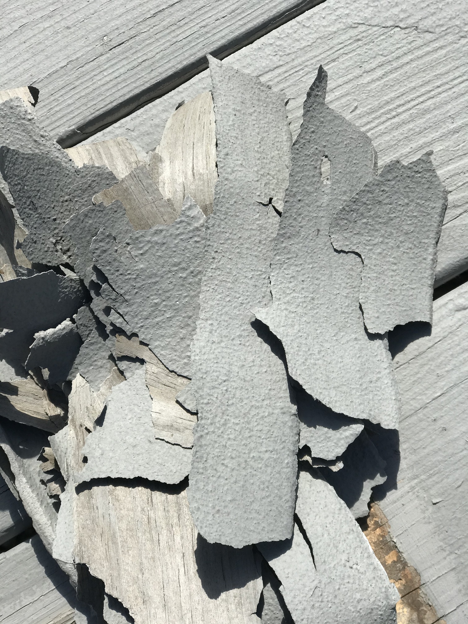

Two days so far, my body hurts, but mostly because I am old and fat. SO this deck has at least 4 coats of deck over and one restore on it.
Here is the beginning so you can see how thick this stuff is. Some of it, not much, peels up in large chunks.

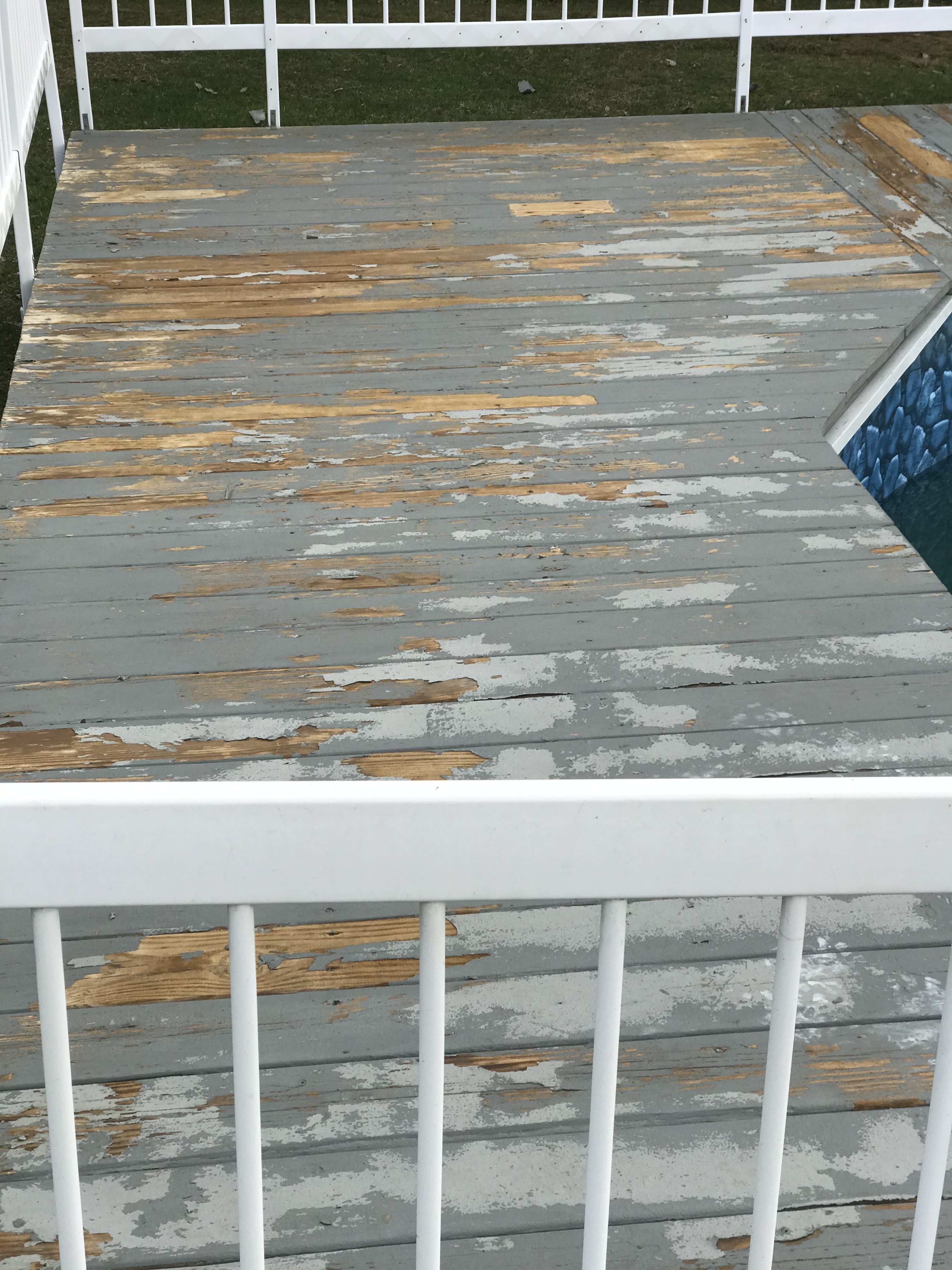

The second pic shows you that this deck has a pool in the center, and what a good dose of hydroxide and a long dwell time coupled with heat and pressure does to remove this surface (I know I’m not supposed to use heat and/or pressure, but it is getting stripped down)

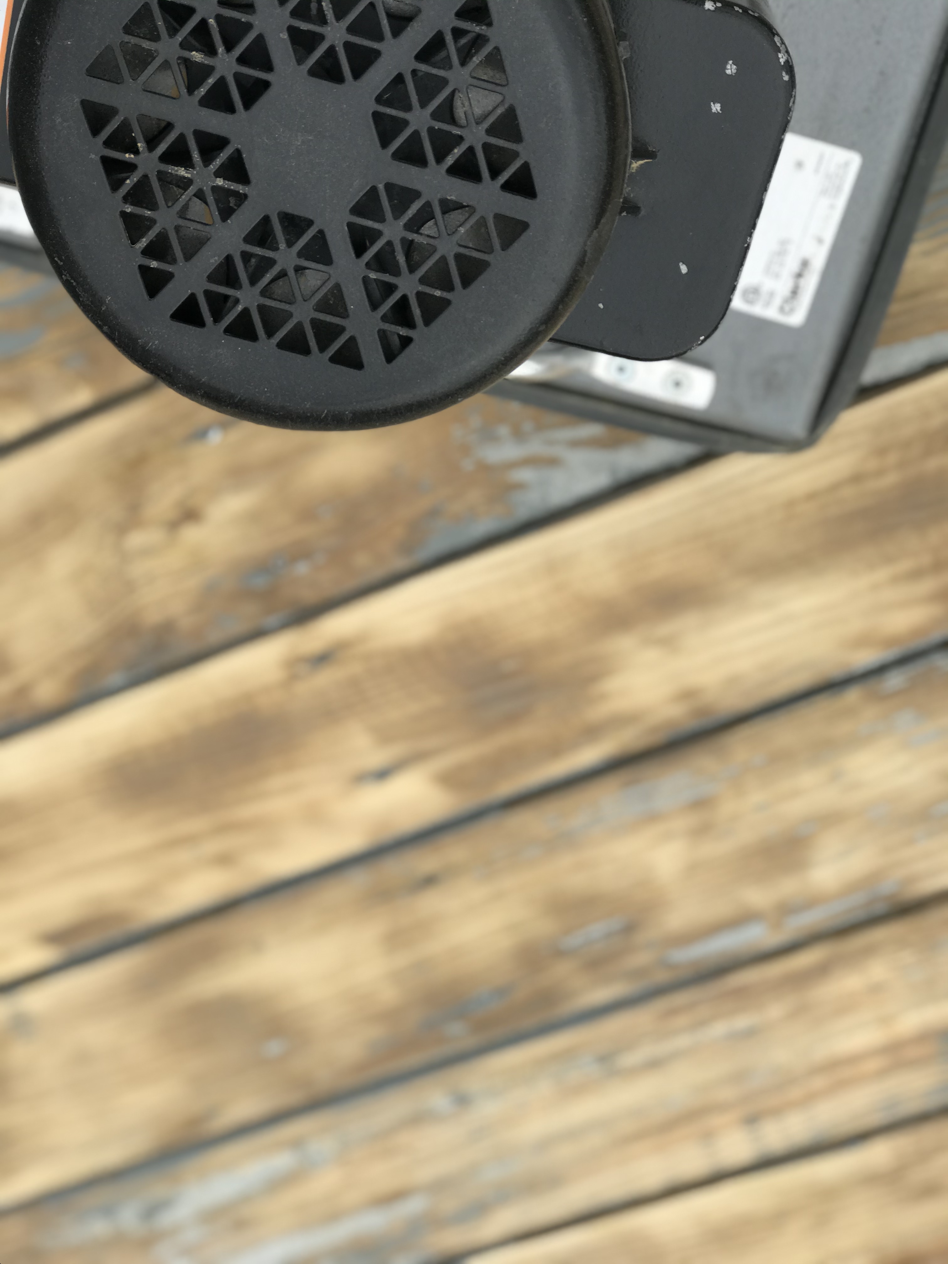

The third pic will show you what a diamabrush and sander has done

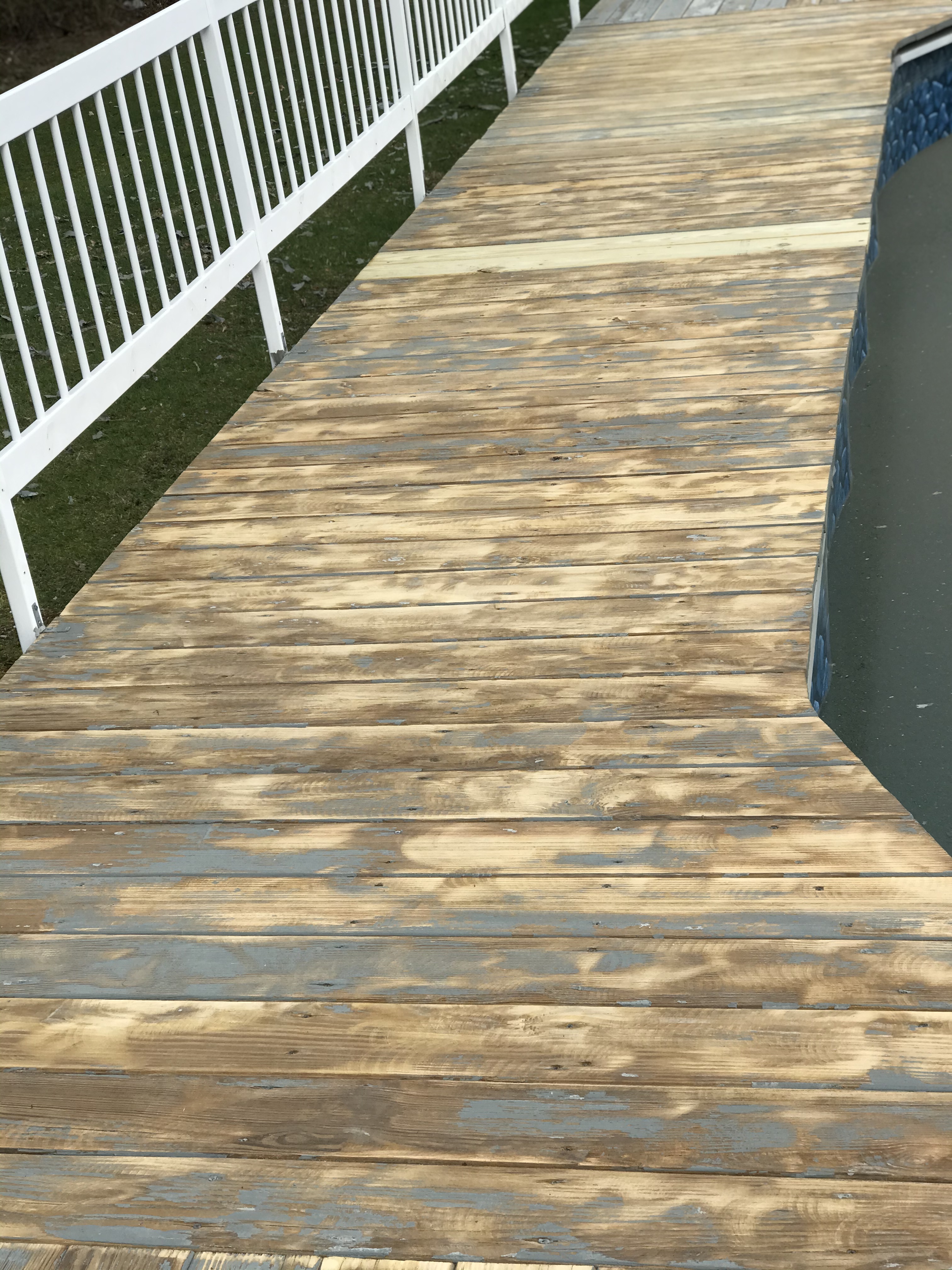

The last pic is what a sander should do after the diamabrush is used (remove most swirl marks).
