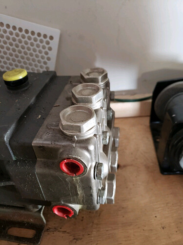

Can you identify this pump?
Found this pump for sale locally but the seller doesn’t know the specs.
He says it hasn’t been used but has been sitting for a couple years. I know it’s a belt drive General Pump TS2011 but I can’t figure out the specs when searching online. I see some that are 2300psi/4.75GPM, and some that are 3500psi/4gpm. Is there any other way to find out?
It’s this one, with the nickel plated manifold, not brass.
Same pump will do both specs, by if your spinning it at 1450 or 1750 rpm based on your pulley ratio.
Although not good, most 1450 pumps you can spin at 1750 and gain a gpm or more
