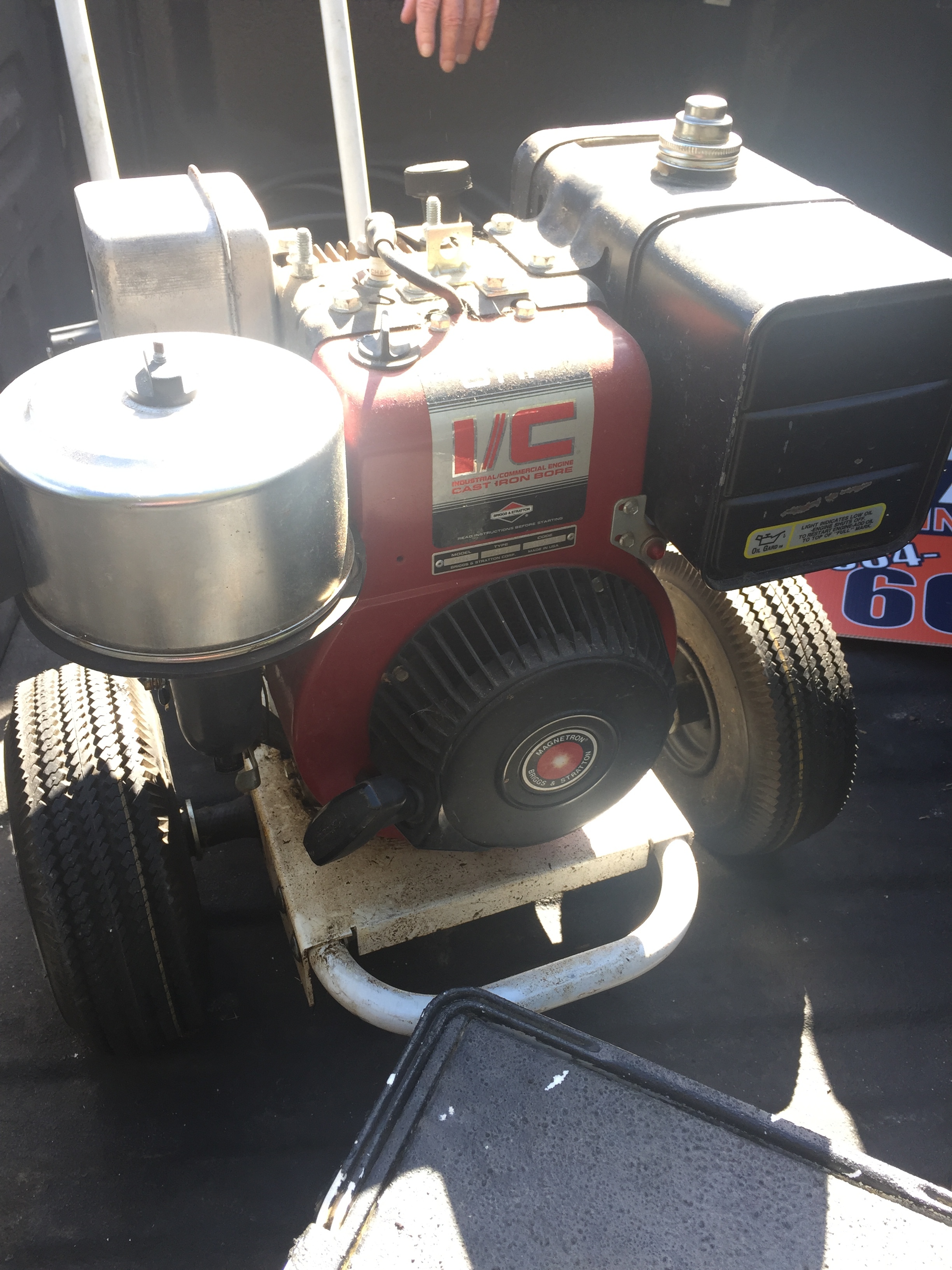

@Steve. Update. So I put a ā€œbrand newā€ pump on my Honda. Still bogged and died under high pressure. So my conclusion is the motor is bad. What could be the problem? I think I’m just going to take both the motors I have to the small motor shop and see what’s up. My grand dad gave me this ā€œbrand newā€ washer today. He says it’s probably 22 years old and he paid $1200 brand new. It’s only been run 12 hours and last ran 5 years ago. I think it’s worth having it fixed over the Honda.
