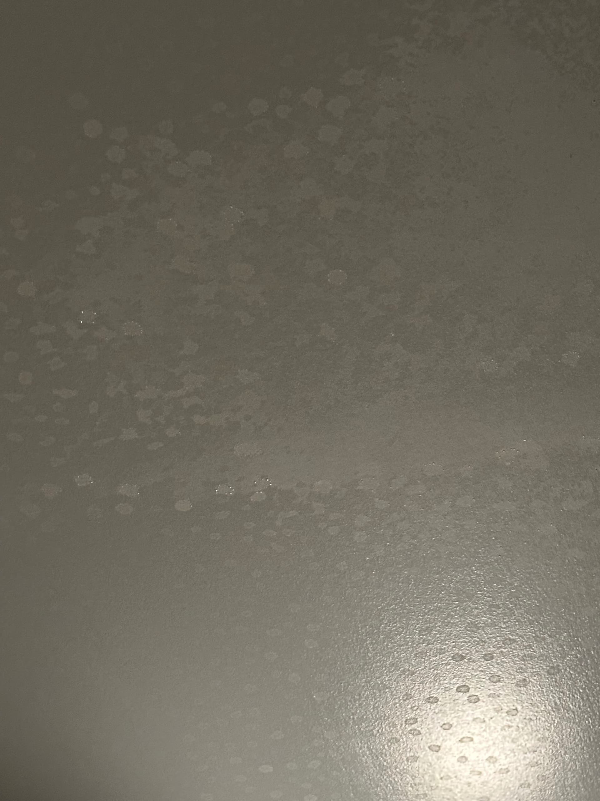

I washed a house and a screened porch about 6 weeks ago ago owner says there is some spotting on the porch ceiling. Pic is below. Everything looked fine when I was done as I check it all before leaving.
I never had this happen ever to me.
Could be several things. Hard to say, so this is a guess. I don’t know where you live or where you wash.
  1. It was a painted ceiling and the ceiling wasn’t’ washed thoroughly enough and the residual chems caused some minor paint damage.
  2. It was washed and rinsed properly, but they are getting morning condensation now in the fall than they did in the summer which is causing water spots.
  3. You didn’t clean the roof and just rinsed it being a cheap contractor and thought you could get one over, the dirt spotted on the ceiling and is easy to see.
  4. the home owner thought you could have gotten it cleaner and hit it with wet and forget and didn’t rinse it, and it spotted the ceiling.
I don’t see them calling you after 6 weeks being the issue, I see a problem that needs corrected. Now whether or not it is your fault is another matter. If I take my truck to the dealer and they work on it and 6 weeks later there is a hard shimmy in it, yeah they are getting called back. If I hire a roofer and 6 weeks later the roof leaks he is getting called back. I think you are picking up what I am laying down.

Could be soapy residue or just hard water stains.
The ceiling was washed and I rinse very thoroughly, it has been damp and rainy here the last week. I’m wondering if it’s hard water drying, I never washed a house in this subdivision before.

Looks like hard water to me. A few years ago I did the same exact thing but accidentally let some housewash mix dry, it spotted the paint up pretty good. I came back and hand scrubbed it off, she was fine with it.

Its not “hard water” from being rainy. By definition condensation can’t be hard water because its distilled water.
It could be a number of things, my guess is you left a film of soap residue on it and with water condensating on it it is collecting the film and drying into more noticeable patches. Either way, I would just chalk it up to one of those things and go back and give it a wash. Won’t take more than a few minutes and is a chance to foster good will with your customer and potentially acquire new customers when they tell people how great you responded to the issue.
While it’s very light , it seems to be a pastel paint issue. The blue color paint is so light you can only see it when against the white trim.
water and scrub did nothing even when
He mix scrub and dry did nothing really. Again it’s light so it’s hard to tell.
Will be offering a refund, or paint allowance or I repaint it myself. It’s a completely flat porch ceiling with two ceiling fans so it won’t be that bad anyway.
