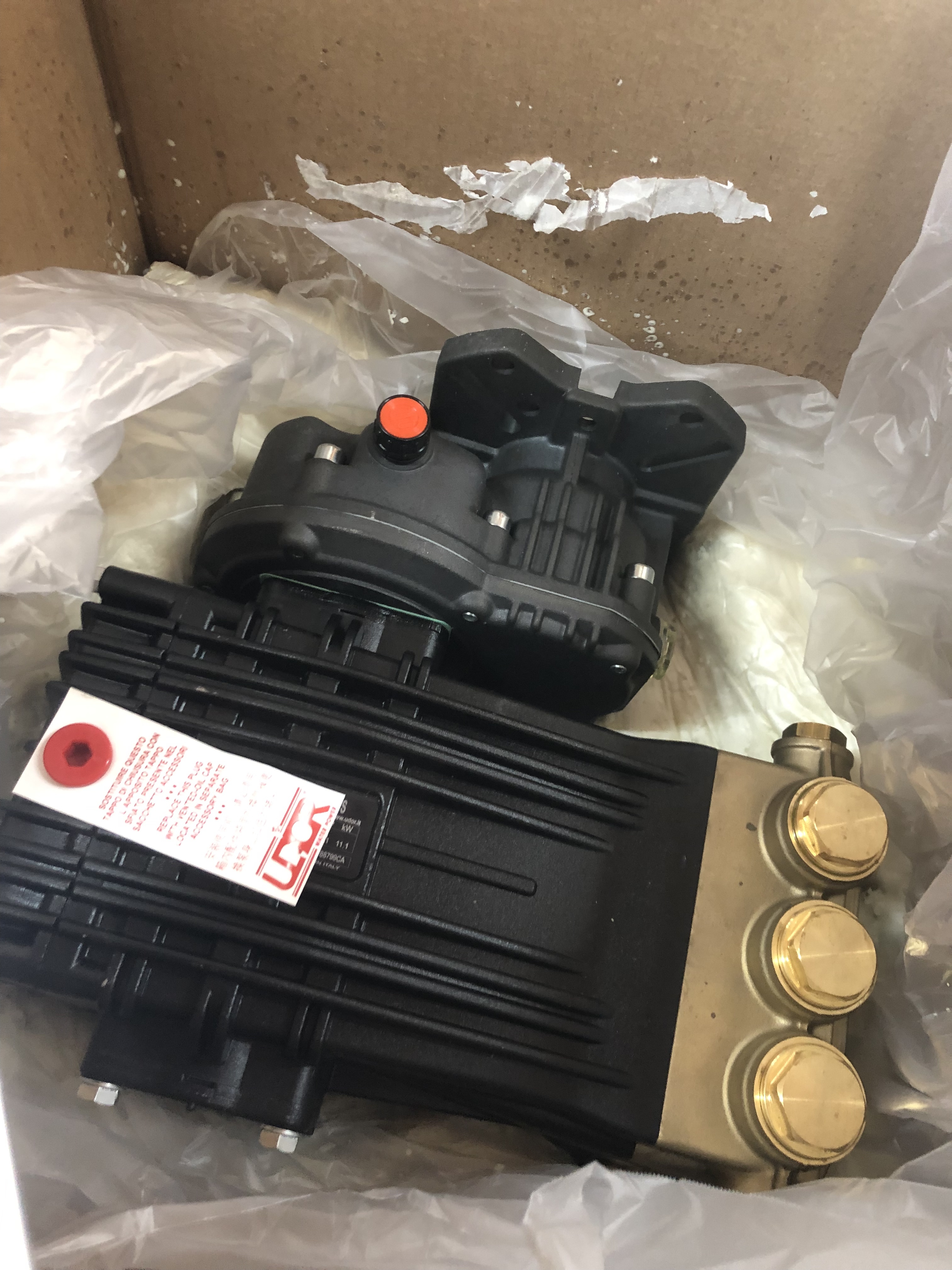

Building a new machine right now and just ordered an udor kc 21-28 gr. $900 shipped and with gear box from Dultmeier. No belts to fuss with and it’ll pull water. The udor will be around for your kids’ kids.
I’ll probably buy it’s slightly smaller brother.
That thing is a beast!
What motor did you put that pump on?
It’ll be on a GX 660 just like the other one.
If you’re asking if it’ll be on a predator the answer is no, because I love myself and this pump too much to do that to either of us.
