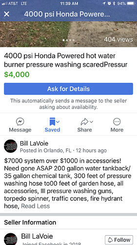

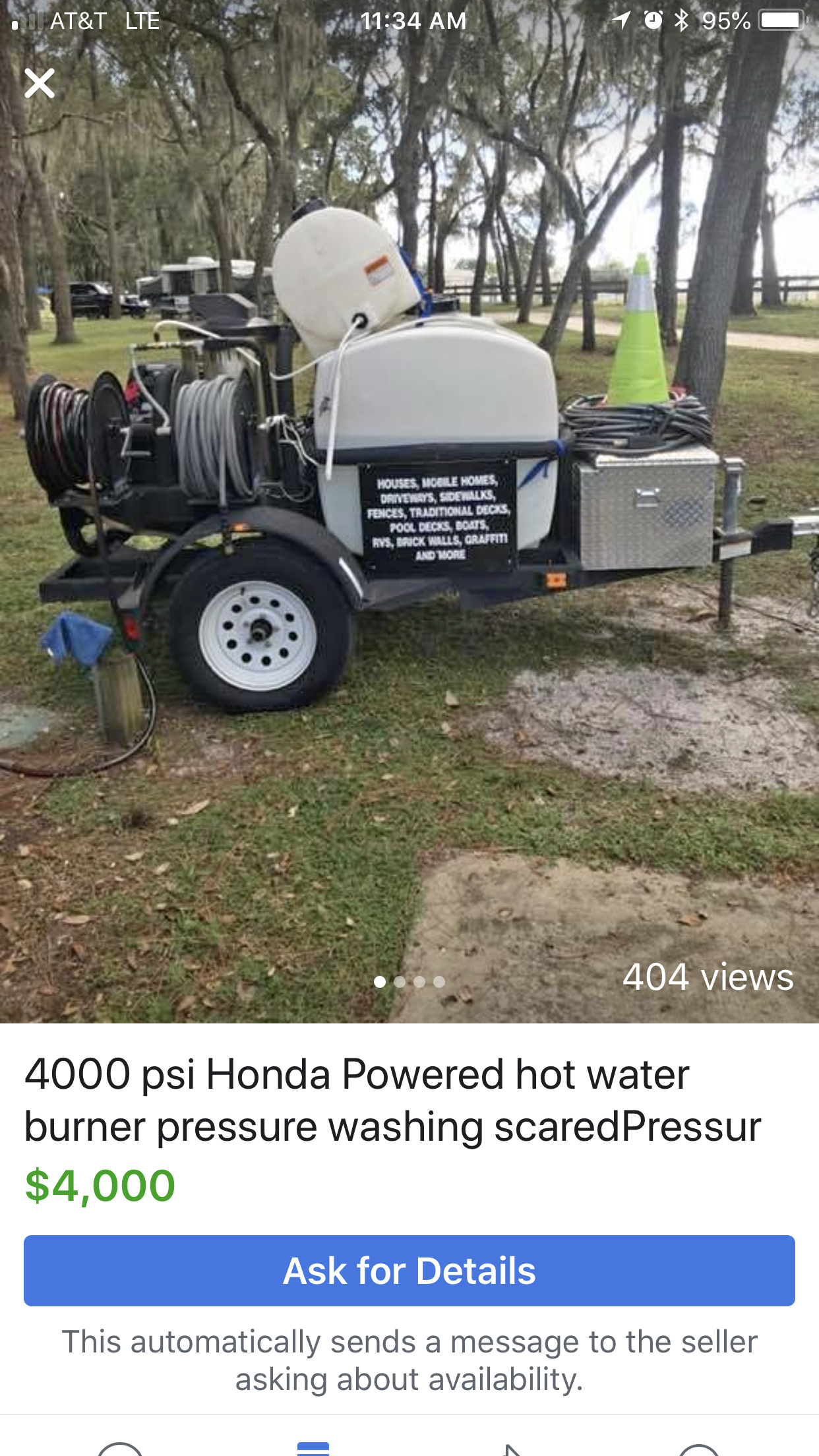

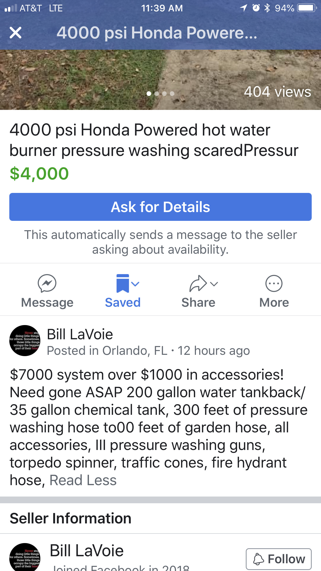

Check out what I found on Facebook Marketplace.
Where at?
I see Orlando, FL.
Looks to me as one of those Northern Tool direct drive washers. 7500 new.
This 9,995.00 is that well overpriced for what they are offering? Trying to get a decent starter rig. Thanks.
That’s for the vanguard 18 hp 5 gpm.
Yes, in Orlando. Not mine but found it on FB.
