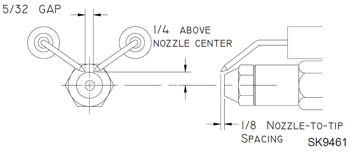

The diodes are 1/4" apart. But I’m not sure on the designed distances for it. I have switched them out with our other washer that works fine and it doesn’t work in it so it has me baffled.
Sent from my SPH-L720 using Pressure Washing Resource mobile app
Here’s what they should be set at…
They are set to those specs just checked them still nothing.
