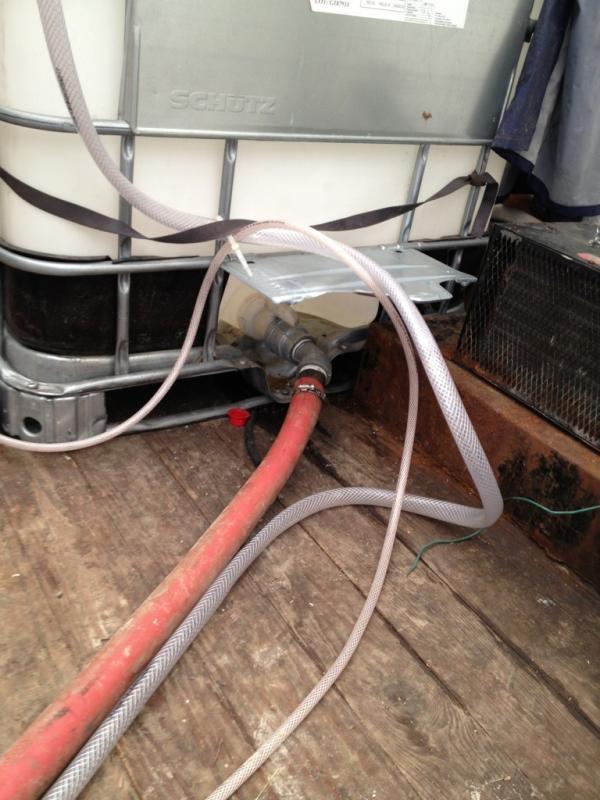

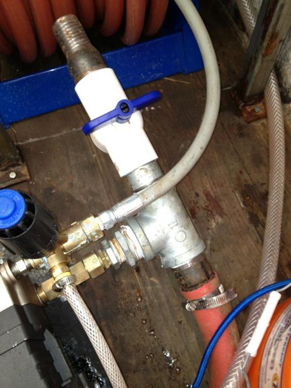

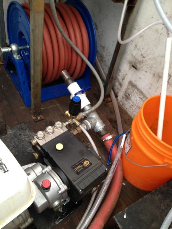

I have a tee right at the pump (11/2") and a ball valve to purge air and drain tank, flush eyes, etc. ill get a pic up soon. Keep your line at least 1" to the pump. I have about 8ft of line from tank to pump. I also ordered one of those tanks and ended up keeping the tote for the pump and using the 55 for roofs since it has gal markings on it. Hope this helps.

Thanks Mike for the input! That is helpful. I am interested to see what you’re doing with that big tee at the pump, so if you do have a photo, I’d love to see it.

The tee does sound like a good idea if you don’t have a manifold at the float tank. An extra source of instant clean water “just in case” is always highly recommended. Plus, with a short hose on it, you’d have a handy source to mix that next batch of simple cherry.

Keep in mind I got a new pump and had to reroute everything so it doesn’t discharge out the back yet. But when I need to purge air I just open the ball valve and let the air out. I kind of have the valve tilted up for this reason.
That’s a clever idea. Thanks Mike for posting those pics!
