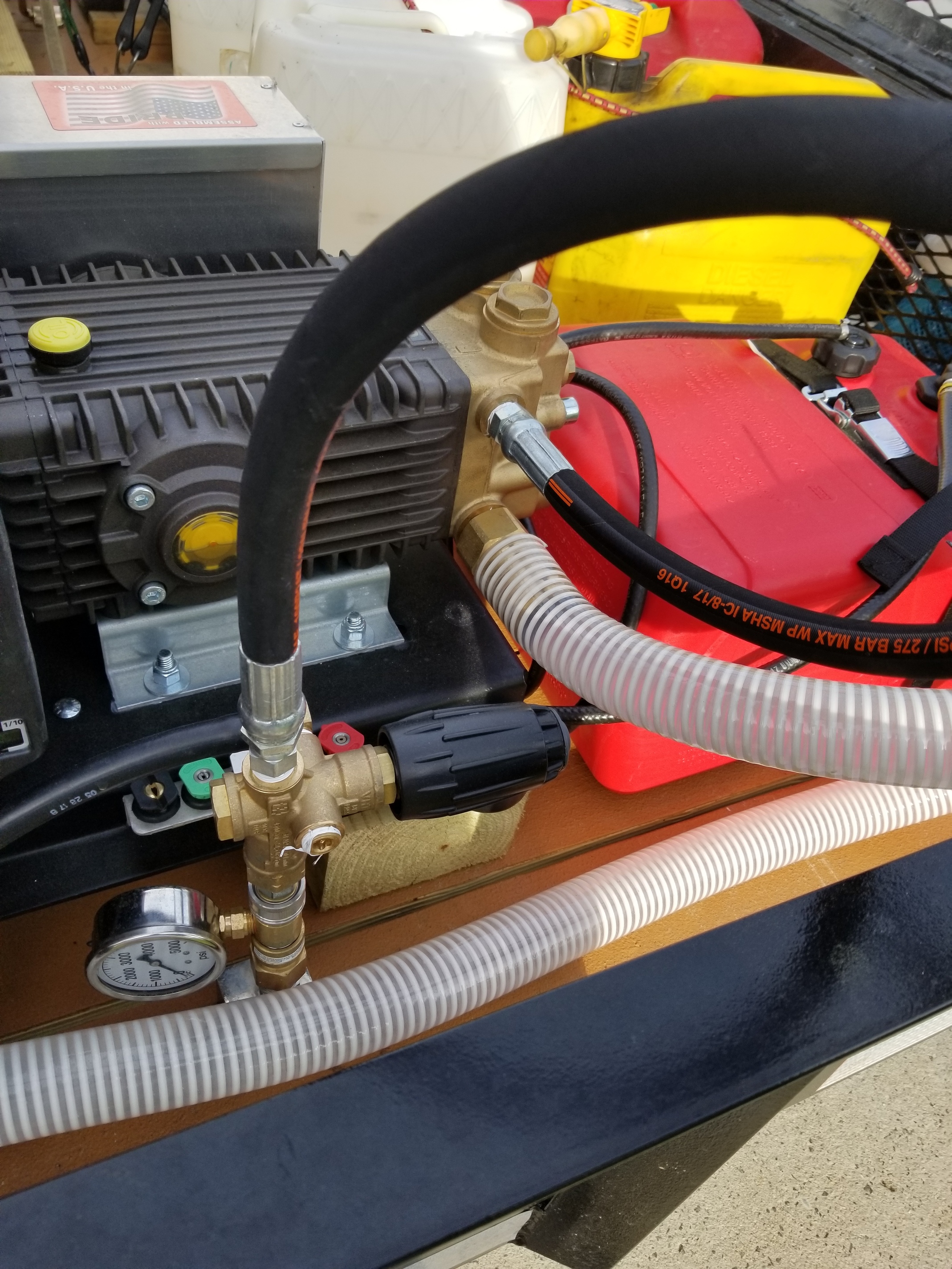

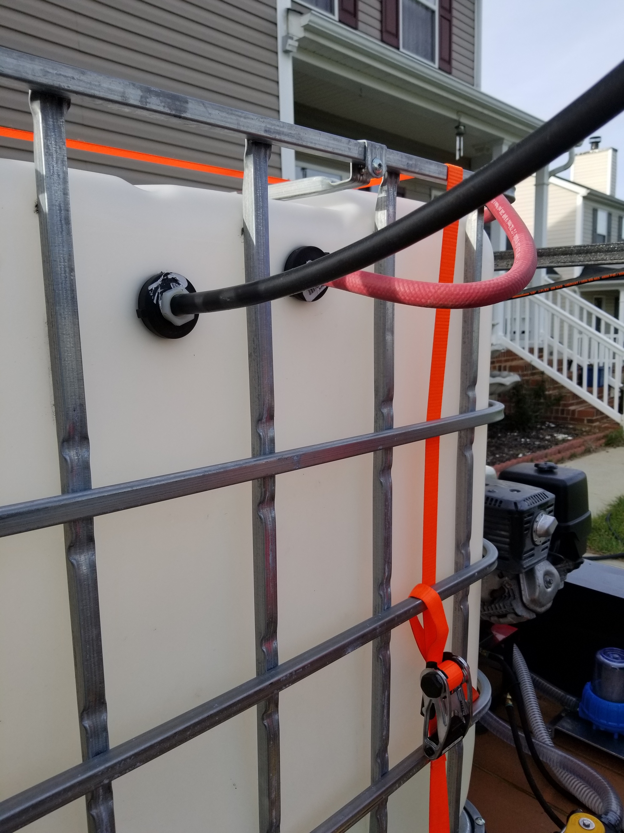

That hose that goes from the unloader out, you extended to the tank.
If water keeps circulating it heats up, then you release valve kicks in, but if its not working you are screwed
So you extended to the tank.
Extending then to the tank. Small 1/2 hose on the side
So it’s best for me to run one from my unloader to the buffer tank if I haven’t already? What’s the benefit?
Yes run bypass to buffer, it keeps water circulating when you are not squeezing the trigger. Water flowing will keep your pump cool when you are not flowing water
