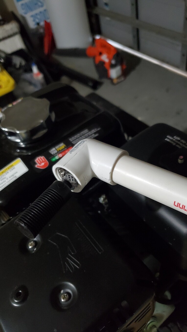

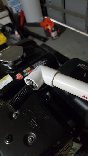

Bucket test check valve 4gpm
Normally i use a 2.1 hi draw that pulls 10:1.
Check valve on same injector 6:1 ! I normally ran 80/20 or so batch mixing sh to water im start running 50/50 should stil put me at close to .9.
Well see how it performs out and about but it def pulls !

Next time you order injectors, try a 1.8 on that 4. It’ll pull about the same as the check valve one. I got one to try on my 4 about a month ago and was amazed. Pretty amazing on the 8gpm too. Liked it so much ordered 2 more of them.

I started with 4gpm using the 1.8 injectors. It was drinking my 5 gallon bucket so fast I switched to a 2.1. It definitely pulls soap well & I noticed a little better flow. This little ball valve was a game changer for me. I only DS straight SH nowadays. You can adjust the mix as you go with the twist of a knob. Hit the brick steps wide open, close it 70% for the vinyl siding, then close it all the way & rinse with soap tips. You won’t have to refill the soap nearly as often.

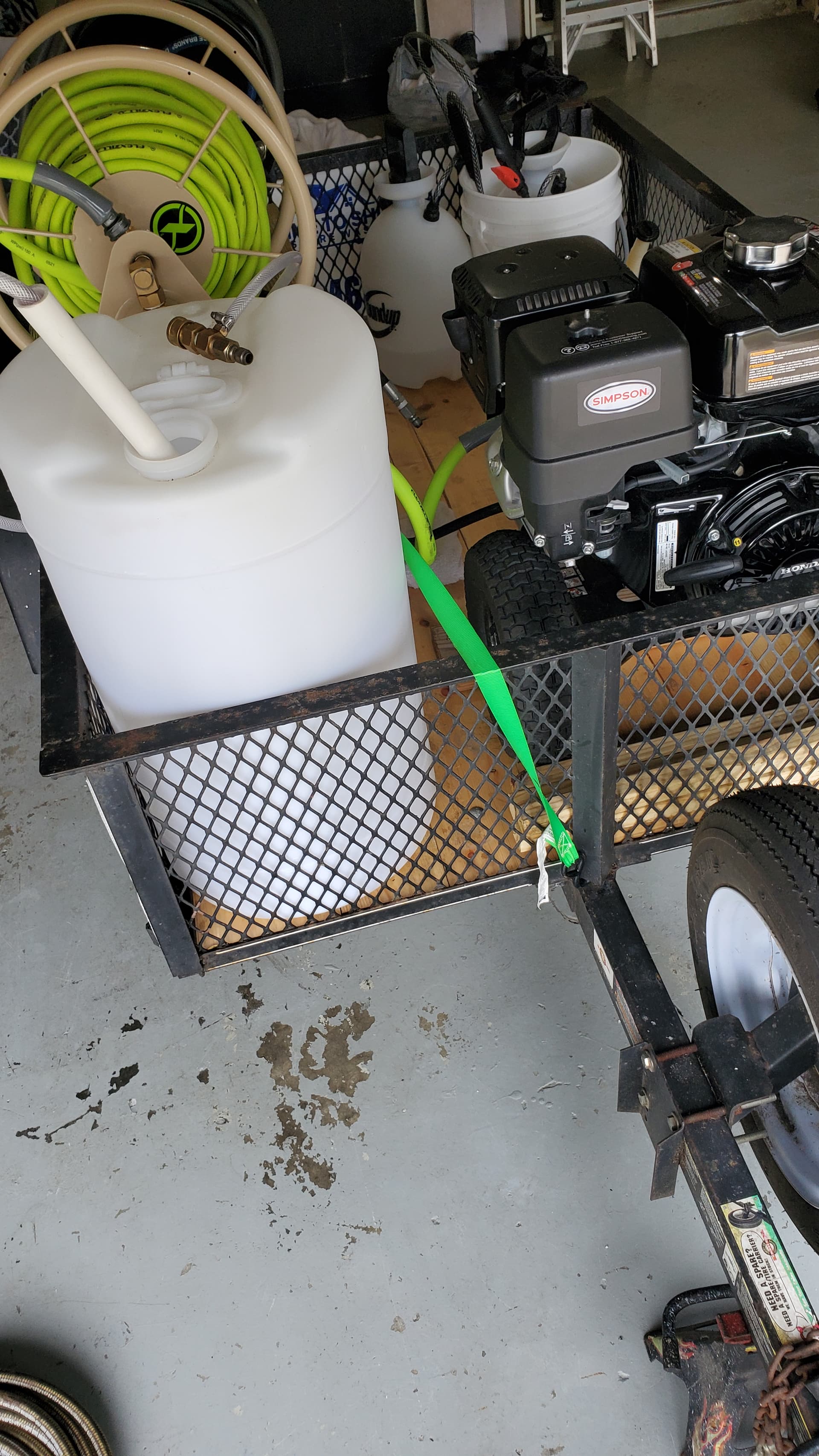

I’m not sure how the 3 way operates but I run 3 singles with a poly T in the middle from Lowe’s. One turns everything on / off. One goes to the SH tank & one goes to a water tank for rinsing out the injector at the end of the job.

Roget that! Sounds like adding a 2 way in between the 3 way & the injector will give you the same functionality. Let us know how it works. I originally added the poly T before adding the valves so I could run a water bucket & an SH bucket without having to refill as often. It pulled 5 gallons of water to 2.5 gallons SH when totally unrestricted. The 16 gallon tanks came a little later & were a great investment.
I hear that ive been using the Xjet 5 gallon as my downstream container so the refilling i hear you on that but i just bought 2 15g tanks for 10 bucks each off facebook and replaced the 5 with a 15

Little steps add up. I used bulkhead fittings at the top with the PVC pipe glued in so there is actually no tube at all in the tanks. The pipe is essentially the tube. They’re cut to length where they are always 1/2 inch off the bottom with no slotted filters. I learned that hack from @Innocentbystander He’s got more tricks up his sleeve than David Copperfield.
Yeah thats what im gonna build up to but with itlike this i can easily pull it to rinse in a 5 gallon of water until i get the 3 way basically or if i need to downstream a differejt chemical just drop in
