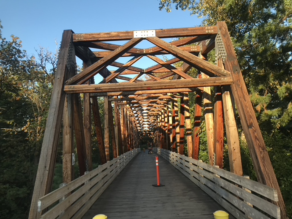

I have a project that hopefully I can get some help brainstorming a bit. It is a timber truss bridge, PT doug fir with Alaskan cedar (non-treated) railings. I’m going to do some test spots first using house mix, citric, and sodium percarb. to start. I have 8, 10, and 5 gpm machines and a softwash setup. I’d like to just run the 8gpm and downstream if possible. The problem is, reaching the outside of the bridge. Weight restrictions will allow for only a small scissor or a tow-behind art. boom (which I think best bet). I’ve overthought this to death, just wondering if y’all may have ideas I have overlooked? Reaching from below isn’t an option. They want uniformity on the color, and the deck is being replaced.

I admire you for even trying this. First thing I’d do is run by there and try a couple of those posts, timbers or whatever with your hw mix and see if that works. Once you determine what it’s going to take, then get back to us and we’ll figure out how to do safely.
I’m thinking you run a safety rope, attached every so often to the vertical posts all the way along. You, with a safety harness on, stand on that outside beam ( the ones posts sit on) snapped on to your safety rope, and just walk the outside shooting it. With your 8 you can do a pretty good ways in front of you, and just work your way along. If you’re into climbing or rappelling, it’s easy. If not, see if you have a shop that sells that stuff near you, or post locally for someone who does it, to get you the right equipment. You might be able to just lean over railing and get it, even then though you may want a safety rope.
Hmmm, I’ll have to noodle this idea for a bit. Pretty sure my insurance would drop me for even asking about coverage, my wife would for sure. Thanks for the idea, lemme’ see what I can figure out.
The bridge looks plenty sturdy to handle a small man lift. But that’s money you don’t want to spend. Interior side you could probably use a sturdy Baker scaffold. For stability you could clamp or strap off to the upper section of the bridge truss. The suggestion of repelling is very plausible. If you want to use ropes use top quality Equipment and be sure to locate a comfortable Bosun’s chair. West Marine supplies the industry down here. As far as moving laterally, I suggest a two pulley system mounted on a well anchored and drawn taught 3/8 steel cable. One for the lateral movement the other for travel up and. Suggest a good winch with remote control attached to a vehicle bumper. Rigorously examine your rigging or have someone with knowledge inspect. Check the nuts and bolts on the winch if you have to. Help on the ground would be nice but not completely required. You could and should already have a PFAS, Personal Fall Arrest System. Especially if you have been doing roofs and other similar locations. There are plenty on Amazon, but be sure it comes with a really good clevis hook. A short 10-ft length of rope, such as a dockline or lifting strap, can be supported over an upper beam. It’s quickly and easily moved. Small but strong anchors can also accomplish this. The cable supporting the Boson’s chair is impractical to attach the PFAS. Think about it? :thinking:. It only looks to me about a 40’ to 50’ drop. Remember it’s not the fall, but the stopping that hurts. Call the Aflac duck.

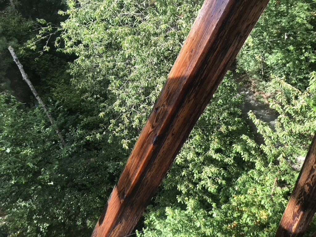

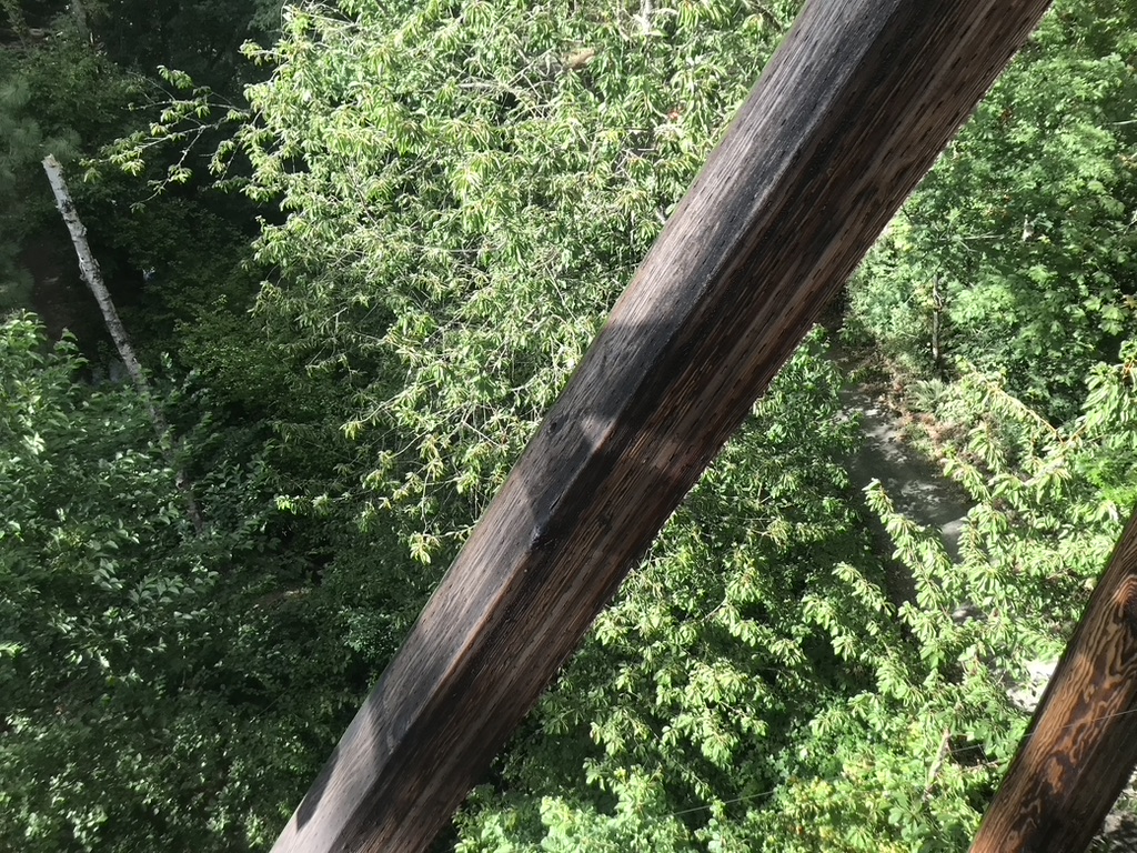

Wow, my apologies! Tested with all chems I could fathom, nothing really made a big difference so I just got it done with cold water. Thankfully, they opted to not clean the outer faces of the bridge.
Awesome, nice job. I enjoy reading through the old forum posts and it’s nice to hear about how this worked out well for you.
Thank you. There was a little pucker factor 5 at the beginning, being on a lift - on a bridge - but I got over it at powered through.
