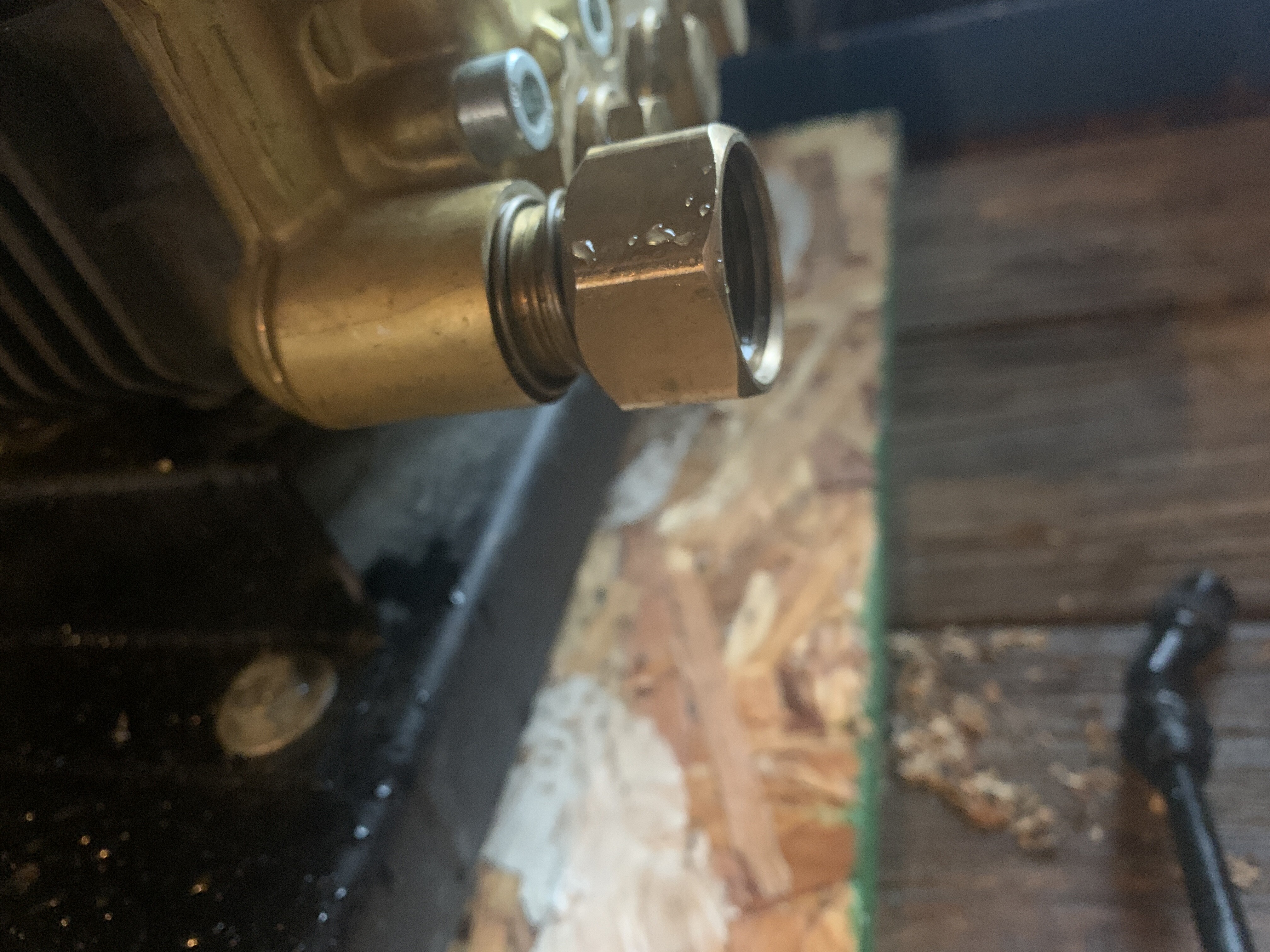

Brass inlet on pump leaking - video inside

I have a strange issue. The inlet on my pump has a spring tensioner. If I screw in a garden hose it will totally snug up and there will be no slop in the fitting. Yet, since I am running a 3/4" line into the the inlet from my buffer tank I needed a brass 3/4" with 3/4" barb as seen in the video. This connector will not screw in enough to take out the slop and the fitting wiggles around. I honestly can’t figure out the difference in a hose end male connector and this brass male connector.
I think I can either replace the brass inlet on the pump and hope the new connector accepts the brass barb fitting OR I can somehow figure out how to run a garden hose connector from the filter (downstream of the buffer tank) into the pump.

The fitting on the pump has a garden hose thread adapter on it, the only pipe thread on it is on the male side. You went and threaded a pipe thread into the side that’s threaded with garden hose thread.
If the machine is not going to be force fed with a garden hose than that fitting needs to be tossed.
You’ll like need a 1/2’'MPT x 3/4" hose barb adapter
Don’t do that, if you are gravity feeding it will pull air into the supply and the pump will cavitate and chew up the seals. That fitting is for a garden hose

No, not at all. The fitting you have hose clamped into your supply hose is called a hose barb adapter. It is sized 3/4" NPT x 3/4" hose barb. You need a 1/2" NPT x 3/4" hose barb. This will thread into your pump and you can eliminate the GHT adapter.
