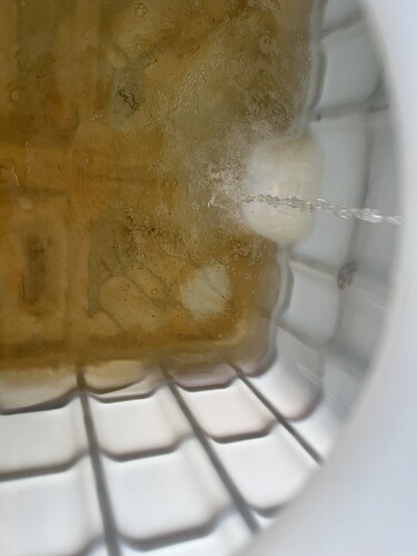

Now I have to ask, where is your bypass fitting aimed? If it’s straight down near the tank outlet it may be getting air sucked in that way. Mine shoots straight across.
I think you’re onto something here. It faces straight down out of a bulkhead. I’ll go take a pic in a couple minutes
Put a 90 degree elbow on it, divert bypass water spraying up against side wall not straight down.
I just did some testing and this is definitely my issue. My water feed also sprays right down toward my tank outlet, so both of them attribute to the problem. I’ll need to put a 90 on both of them. Is there a way to put a 90 on a Hudson float valve?
You’re spot on. I was able to run my water all the way down because I just left the trigger open without going into bypass at all. My water feed and my bypass both spray right toward my tank outlet. Only when I had my water feed turned off and I didn’t go into bypass could I empty my tank
Glad I could help, easy fix.:+1:
I have my Hudson mounted vertically, you may want to just relocate it to the other side, and shoot the bypass horizontally if that plastic can take the pressure.
