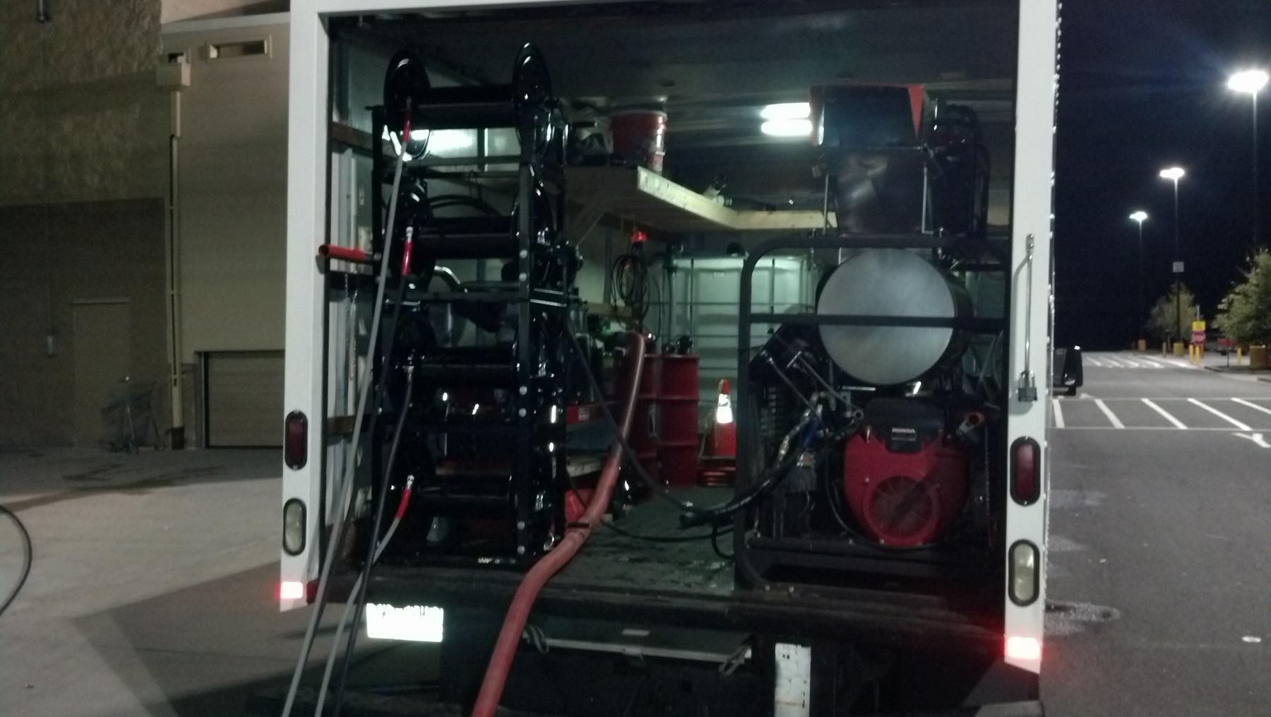

We have 16’ GMC Savana 3500’s and they fill up pretty quick.
Seems to be the ideal size for both of our companies though. We can get in and out of residential easily yet still

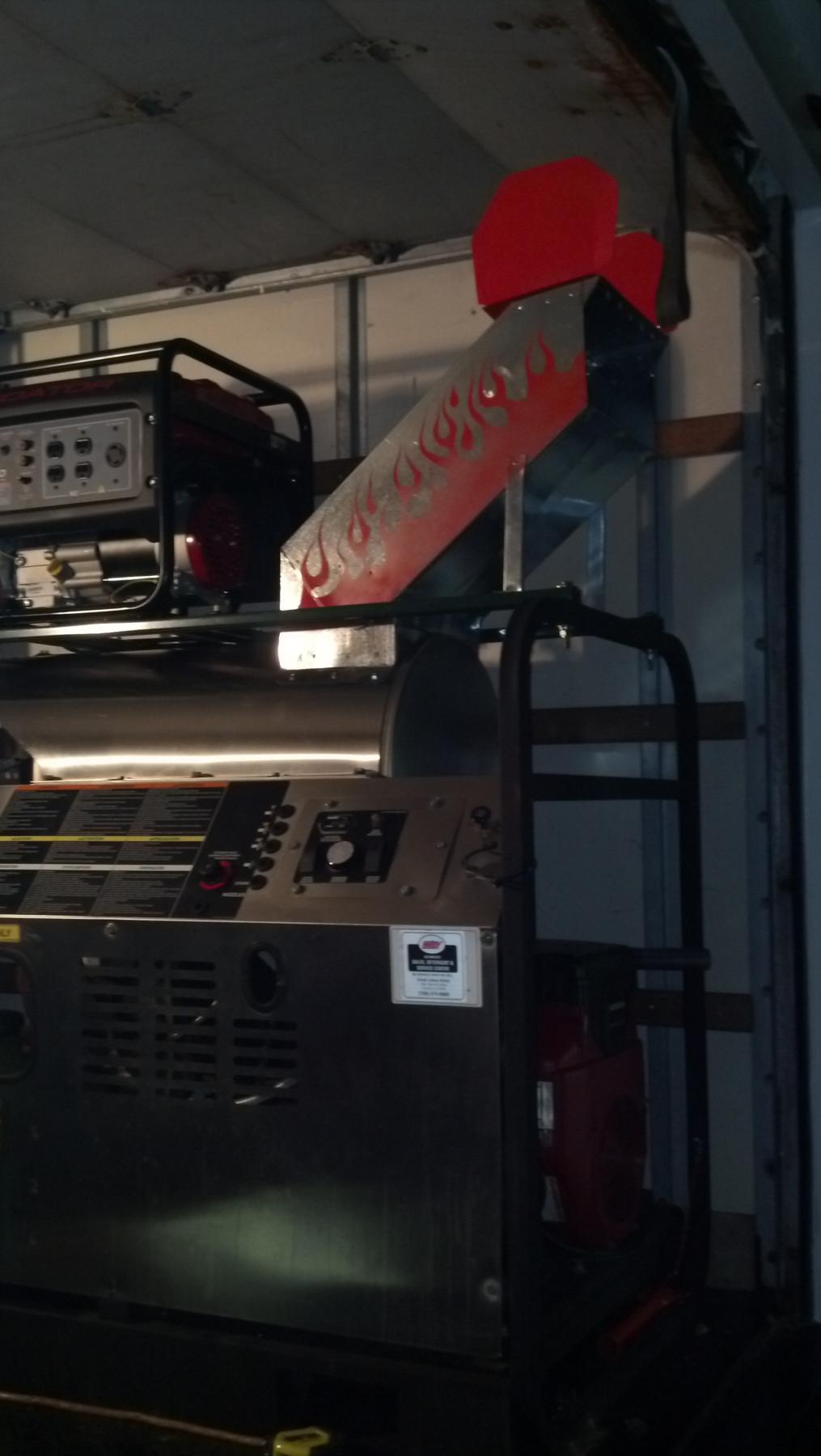

setup the truck to do commercial with no problem. Below is the inside our our most recent build.
Is that two hot water units?
Timber seal, did you make that exhaust on the burner or buy that somewhere. I run out of a box truck also. I like what you have there compared to my exhaust stack. Thanks
I made it. It has a fixed pipe to the door and an extension that flips down when in use to divert the exhaust out. Our exhaust for the engines are extended out the same way (to the door with an extension).

Little of both but mostly it’s bolt on. I used to wrench and weld for a living years ago so I can weld up nearly anything but don’t do much anymore. Reels are all summit stackables and the exhaust is all sheet metal duct riveted together.
