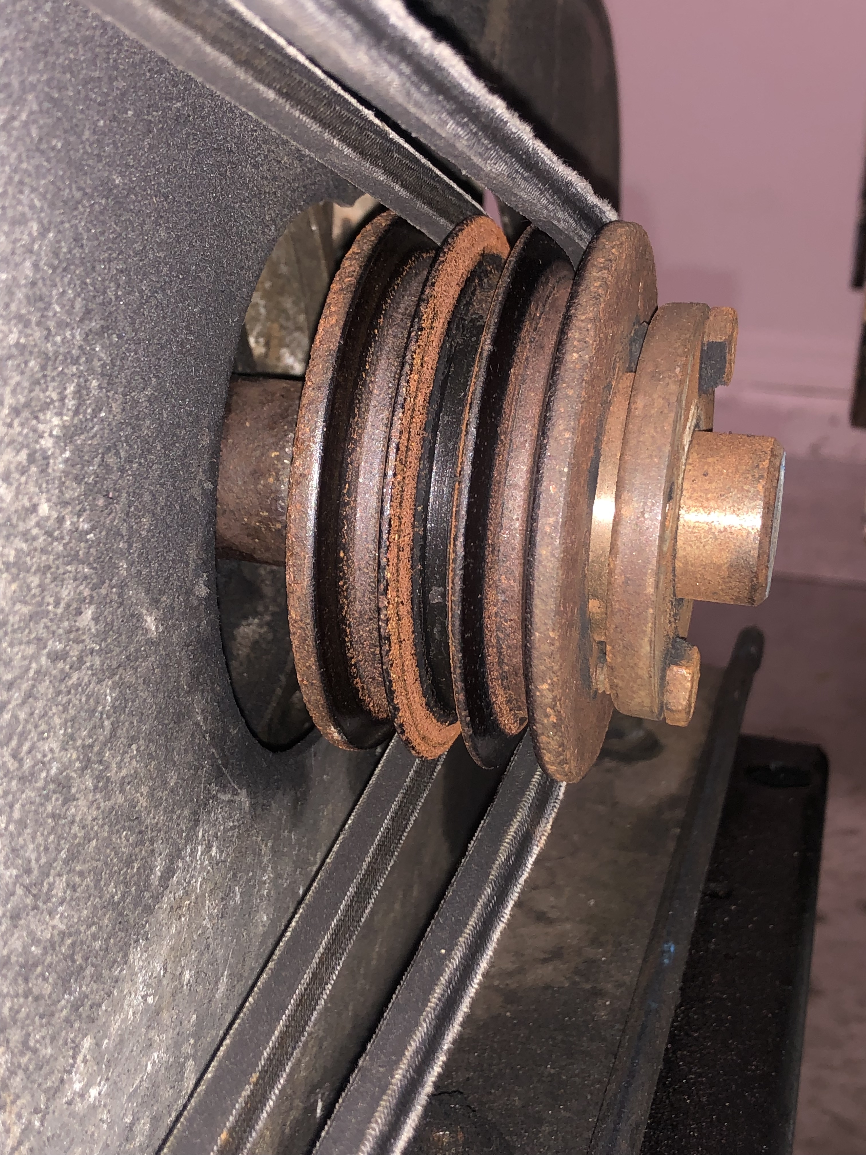

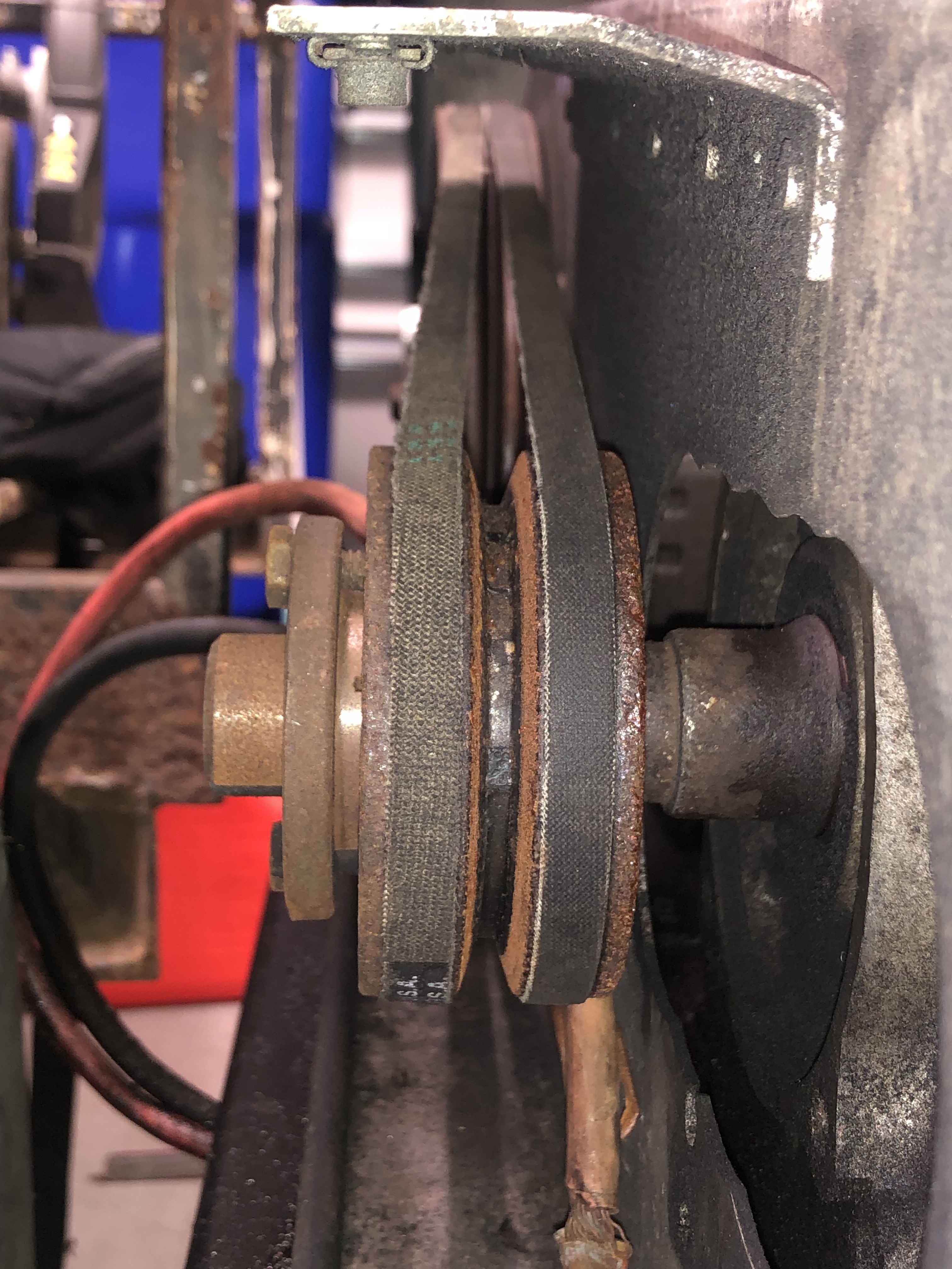

Meanwhile I’ve been through a lot, never mind, missed this place and you guys, glad I’m back here reading, learning and preparing, now @Dtejada, before replacing the belts, looks like you need to align them first, belts look like they are 1/2 in away from one another on the driving pulley, where as they almost touch each other on the pump pulley, I’m not sure, but looks like it’s not right, and I’m not sure why.

I Saw that to,good eye @Fat-one . Put a straight edge on the pulleys to determine if it’s out of line
Holy schnikes good looking out @Fat-one! I skimmed right over that belt pictures and yeah they’re definitely way off.

Those wires running inside the belts sketch me out in a major way. That was just temporary, right?

Just tucked them in there for now
Small pulley has 3 grooves big one has 1 where the belts run on. Is it suppose to be live that or both running side by side?
Side by side,you should be able to roll it over clockwise with a pipe wrench on The sheave and a screw driver to catch that middle v groove,the belts don’t look bad,check for dry rot,and at least get the numbers off them and write them down in your log and get new ones for back up on your rig.
