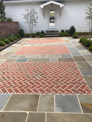

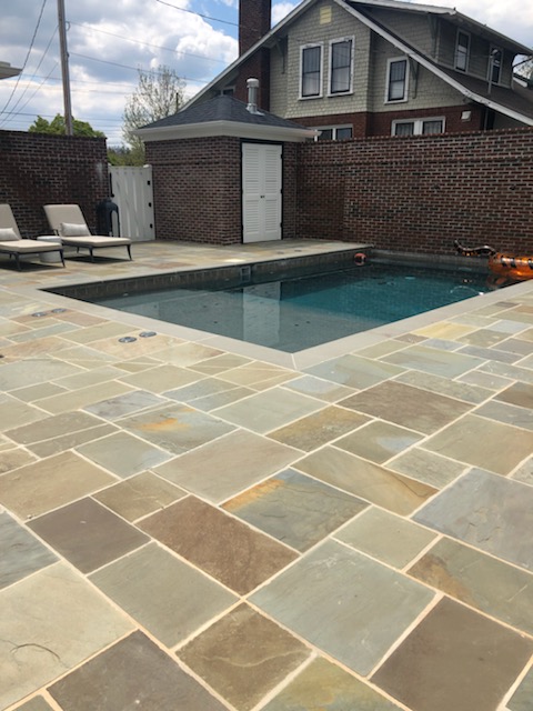

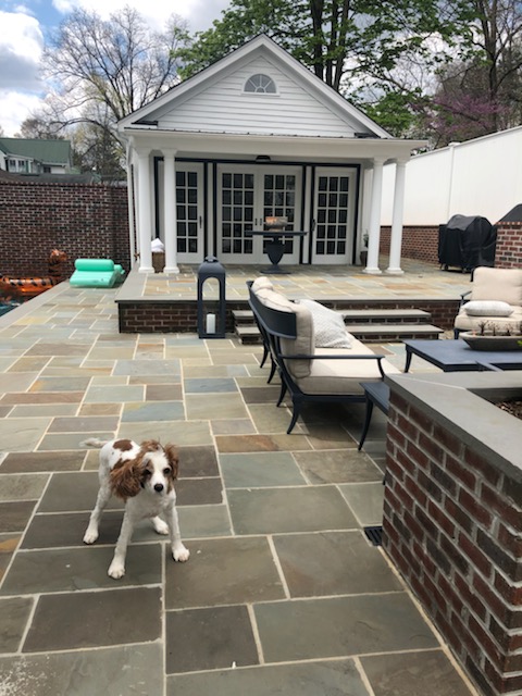

I’ve been researching and im getting conflicting answers about cleaning bluestone. I’ve read that people can etch it with as low as 900 psi and racer saying using a light commercial mix (ebc) with low to medium pressure (assuming 1200-1700 psi. This stuff is a couple of years old and from the pictures she sent is barely dirty at all. I guess the only way to really tell how easy it is to etch is to test it but wanted everyone’s opinions first to help make it more concise for people in the future

Yeah that’s interesting and all but there’s more important things to tend to here…what’s the dog’s name???
If I ever end up at this job I’ll make sure to ask but for now would you rather go for spots or scrappy? I’m leaning towards scrappy that dog probably has some good fighting tricks up its sleeve
That dog looks like he’d just as soon lick you to death as bite ya. I’ve always heard that dogs only bite bad people. You’re not a bad guy are ya?
I like Ringo. He looks like a Ringo to me.
That’s Oscar all day long, I can tell by the outdoor furniture.
Dang. You’re right. That’s definitely an Oscar.
Or maybe it’s a girl and her name is Luna like every other female dog in the U.S. lol
Not a bad guy, at least my dog seems to think I’m not haha was looking for a picture but I dont seem to take too many, mostly videos
@DisplacedTexan @MuscleMyHustle What are ya’ll talking about? Thats a Roscoe. (Note-I’ve only named one of our 5 dogs that we’ve had.)
