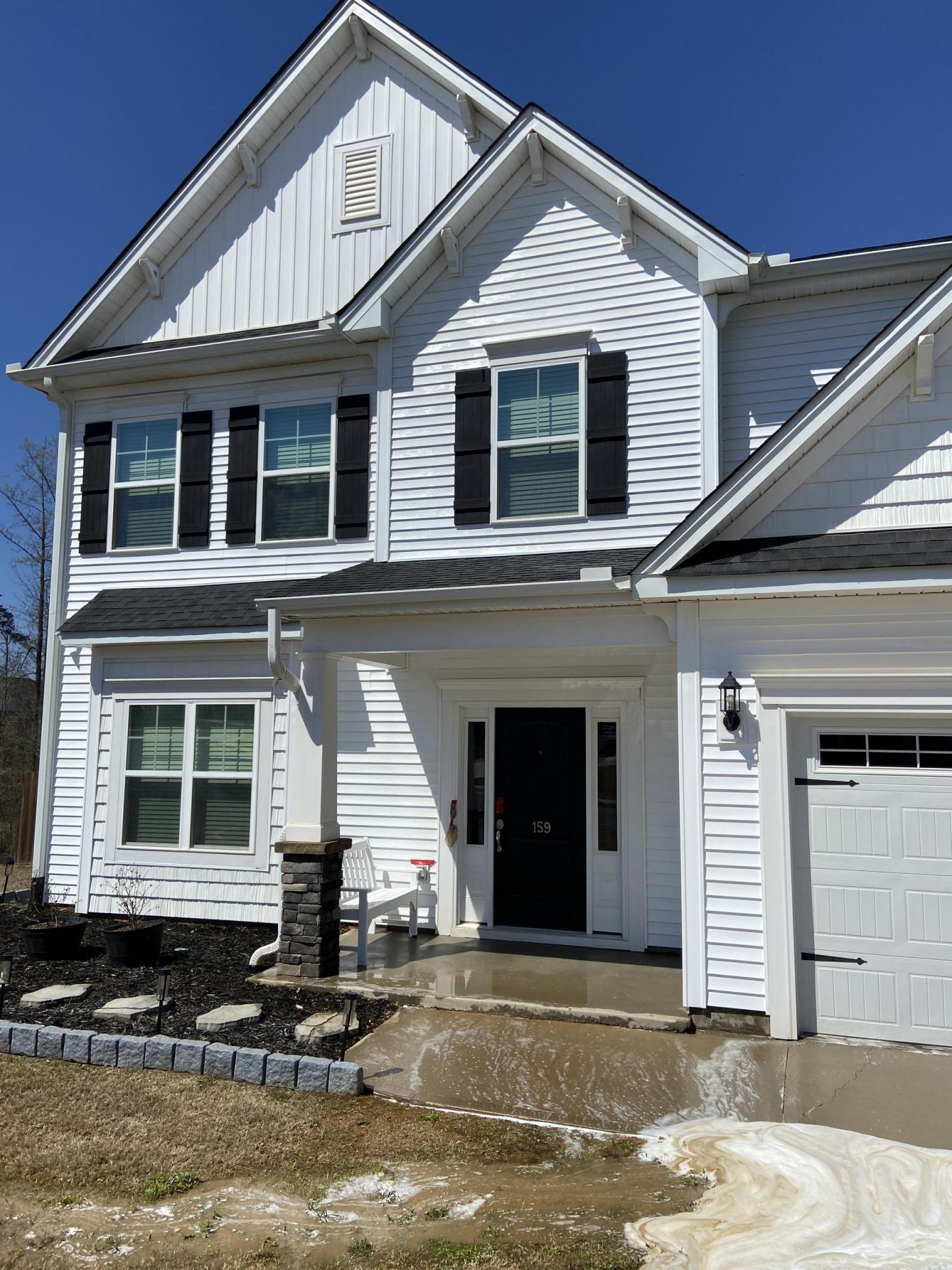

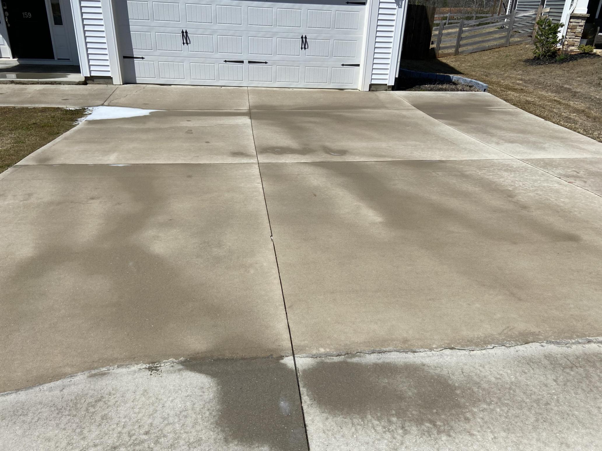

The SH not as much as spraying acid 30’ up in a 20+ mph wind I had this afternoon. White vinyl siding house in a newer subdivision. It makes them shine. I did a lady’s on the main road which was almost orange a couple of weeks ago. Used 5 gallons of acid on just the front and back. Everyone in the entire neighborhood talking about now. Have picked up 4 jobs in there past 10 days. But it can be brutal in the wind.
First pic doesn’t show how nearly the entire front was orange from 2+ years of baked on red clay dust
Pretty amazing….never had to do that to that magnitude. Don’t have red clay like that around here. Did you downstream the acid I imagine. Was that the wheel acid?

What’s the process for that clay? Just the acid and rinse?
yes, it’s 6% hydroflouric and 6% phosphoric acid.
No, I don’t use ox. I wash it first, that will get some of the dirt and of course organic stuff. If it stioo has the reddish tint, then I hit it with the wire wheel cleaner
Did you DS it at 100% strength? Or any dilution prior to the DS injector?
