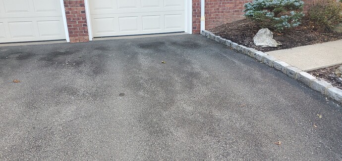

Can I use a 5% roof mix on an asphault driveway that have black streaks running down it like a roof does? Will that be enough? I’ve surface cleaned a few driveways before but I need to get larger orifice meg nozzles because it’s alittle to rough. I have a 4200psi 4 gpm and a 20 inch cleaner running stock 25 degree 2.5s should i get 3.0? 3.5? or higher
No Unless you rinse it right away it will leave marks where the bleach was. I had to almost repave a commercial lot one time because I’d been doing their stucco building and I flushed out my system in the parking lot and didn’t rinse it nearly enough.
Usually on asphalt you just apply a sealer top coat. Provides an almost like new appearance.
so just use straight water to be safe?
On asphalt, dragon juice and water is a safe cleaning method or just water alone
there is also moss and other crap on the driveway
Do you have any pictures ??
You can use some SH, like a real strong HW and even go to about 2%, just don’t let it dry. Get it washed and rinsed really well.
today I can get them
I’ve had too many bad experiences with asphalt, so we don’t wash them at all.
Why would you use sh. Is the streaks on the asphalt organic?
Oh wow someone destroyed that driveway. Pressure wash it and call the seal coat guy
i didn’t wash it yet . it just looks like the dark stains you see on the roof .
That sucks for that guy. Good lesson learned
In another video he said it cost him 400 bucks to have it resurfaced. Ouch.
