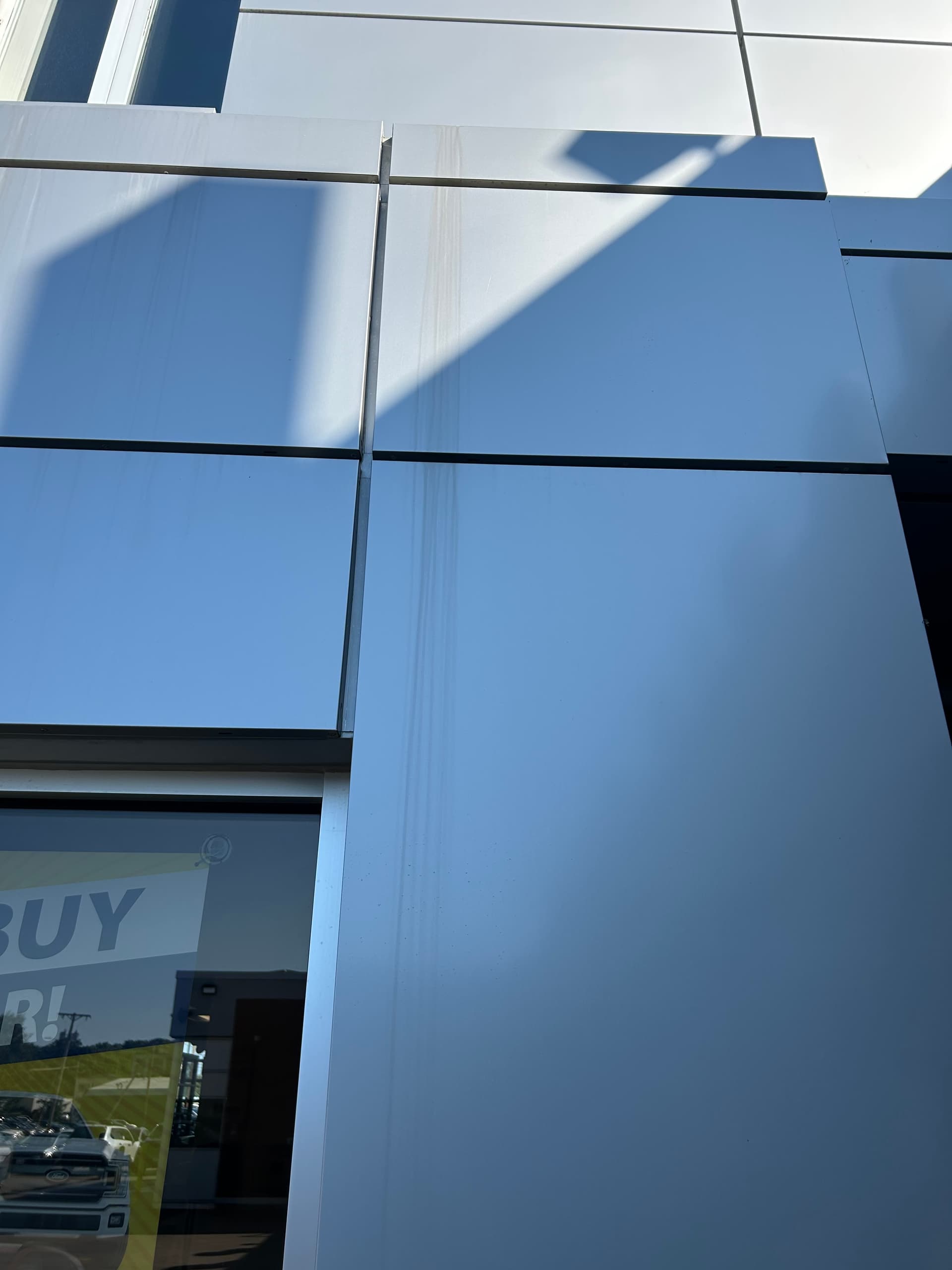

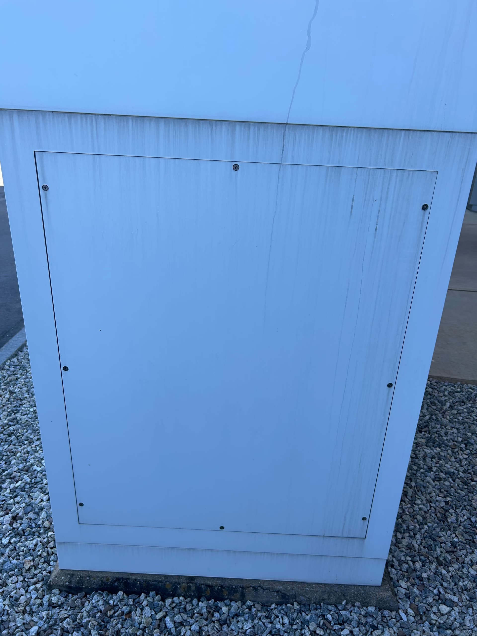

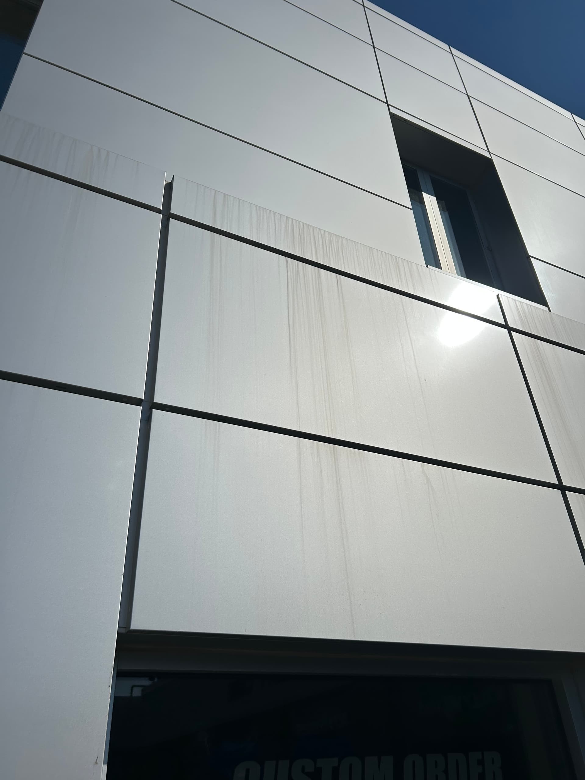

Black streaks on aluminum and ACM panels at dealership. Client asked us to remove them. Any ideas on how to tackle this?
I did a bunch of ACM panels at car dealerships a few years ago. I used cleansol BC, downstreamed in sections then brushed it and it worked
cleansol BC……
