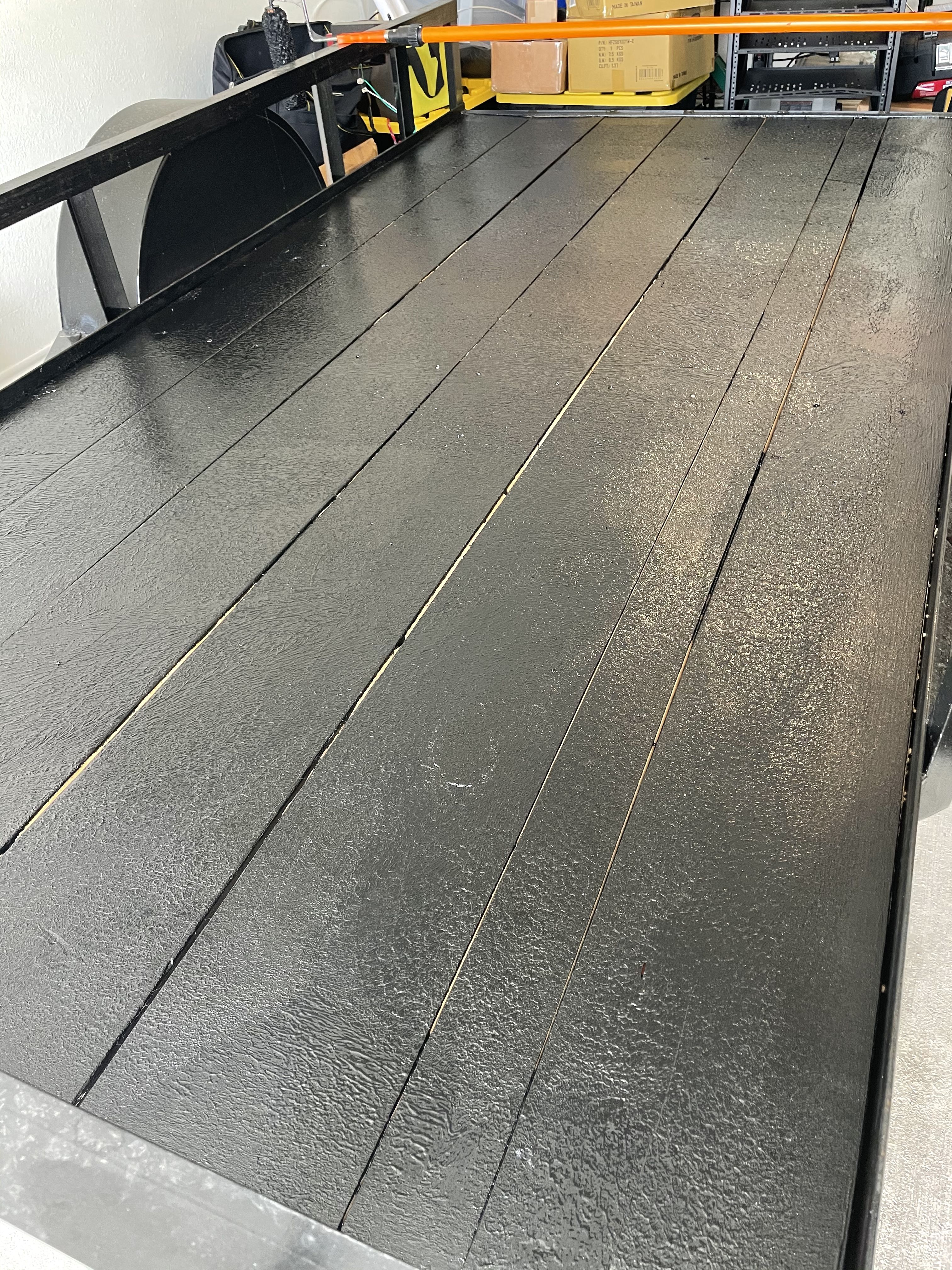

To treat the wood and protect against SH I looked at different products and settled on a gallon of bed liner from Harbor Freight. It took to the wood fairly well and I’m happy with it. We will see how it performs over time. Application was easy and I as able to build it up to a decent thickness.

Looks good! I’m not positive why people like to put wood down, but i simply put a 3/16 diamond plate sheet down instead.

@Redjess Does the diamond plate handle the corrosion of the SH well?
I looked at the MSDS for SH and found some plastics online that are resistant and came in sheeting. I can’t remember at the moment what the formula was but it was out of my price range for this build.
Its the same thickness as the trailer frame, but you do want to coat it. I have yet to coat it with anything, but I will. RAPTOR liner is my choice of liner. The plate should last as long as the trailer.

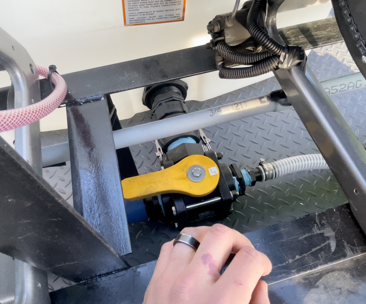

I chose to use a 2 inch 3 way banjo valve. One end reduces to 1 inch for my 8 gpm feed line and the other goes into the 2 inch dump. The 2 inch discharge hose isn’t working as well as I thought it would so I plan to change that to a simple PVC pipe with a 90 to dump out on the ground. You can do a second bulkhead if you really want to for dumping water but it’s honestly just another hole in the tank, more parts, and you still need a valve to keep it closed anyways. Might as well just do the 3 way.

@DJPWS Thank you, I now have a banjo V200SL on order for pick up at Grainger this week and am planning to work on plumbing with weekend and will take your advice on the PVC drain.
I ended up putting pvc in. Much happier with it.
