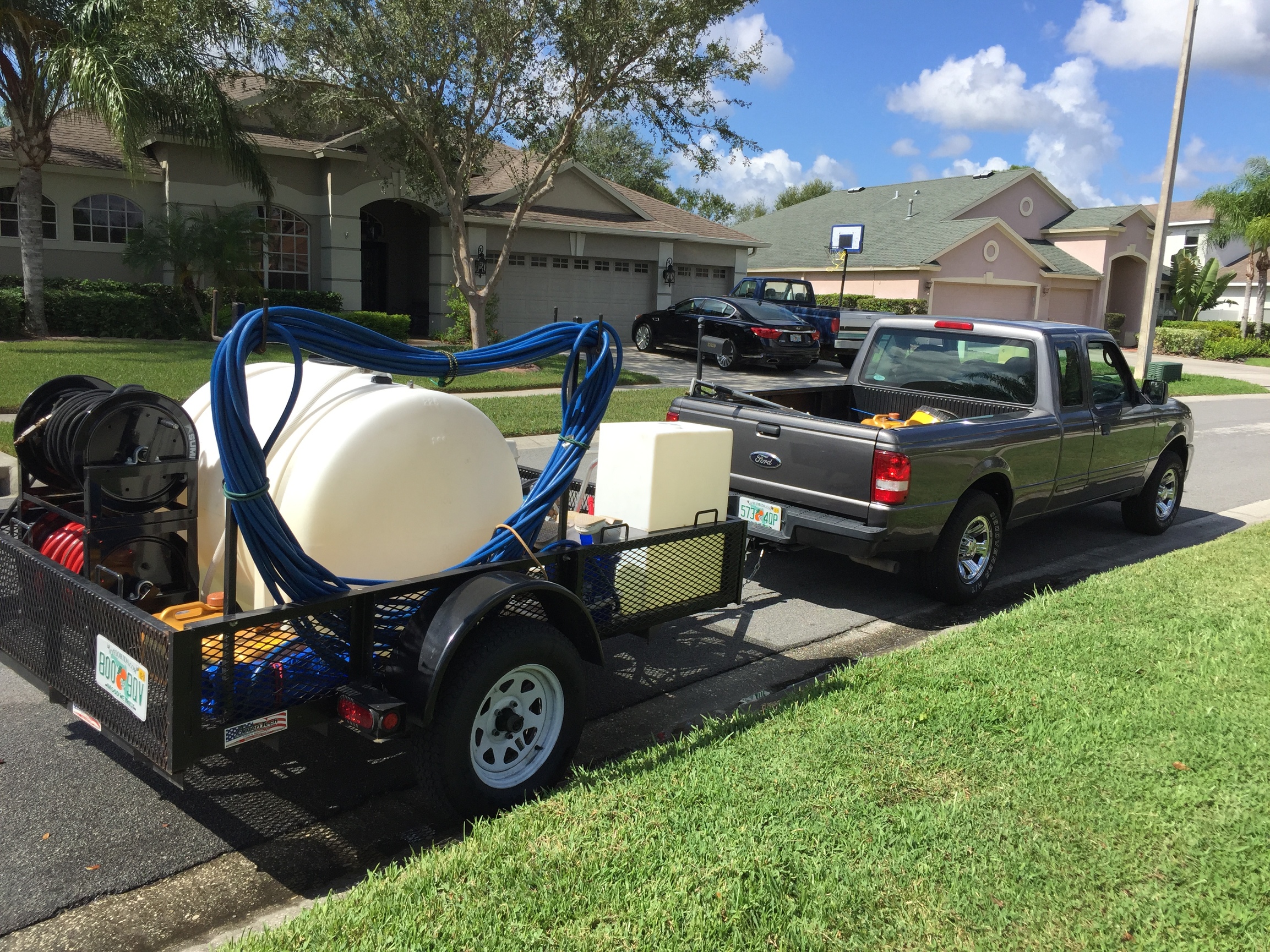

Below if it I did it right should be my set up if anyone has an idea they see that stands out to help me out!

Nice clean setup.
If you weren’t in florida i would agree with squidskc, but florida has a lot of stucco and that 12V will come in handy. You dont really need it for driveways but if your ok with unrolling 2 hose, that so be it.
If you dont already have it, get a binder and get your SDS sheets in order, also get a fire extinguisher if you dont already have one.
Good idea with the used reel idea, I just want something to make it easier to get that low pressure hose rolled up and then I can get the second part of my ladder rack back.
I’m thinking of attaching the reel right over the trailer fender where the blue hose is rolled up now.
So far I haven’t run into too much stucco but mainly brick, wood and vinyl. I’ll keep the pump as long as it works and might find another if it dies for the right price as everything is already wired etc but I’m leaning towards just a 2 gal pump sprayer.
I don’t have a fire extinguisher so that will be added to the list. Didn’t even think of it.

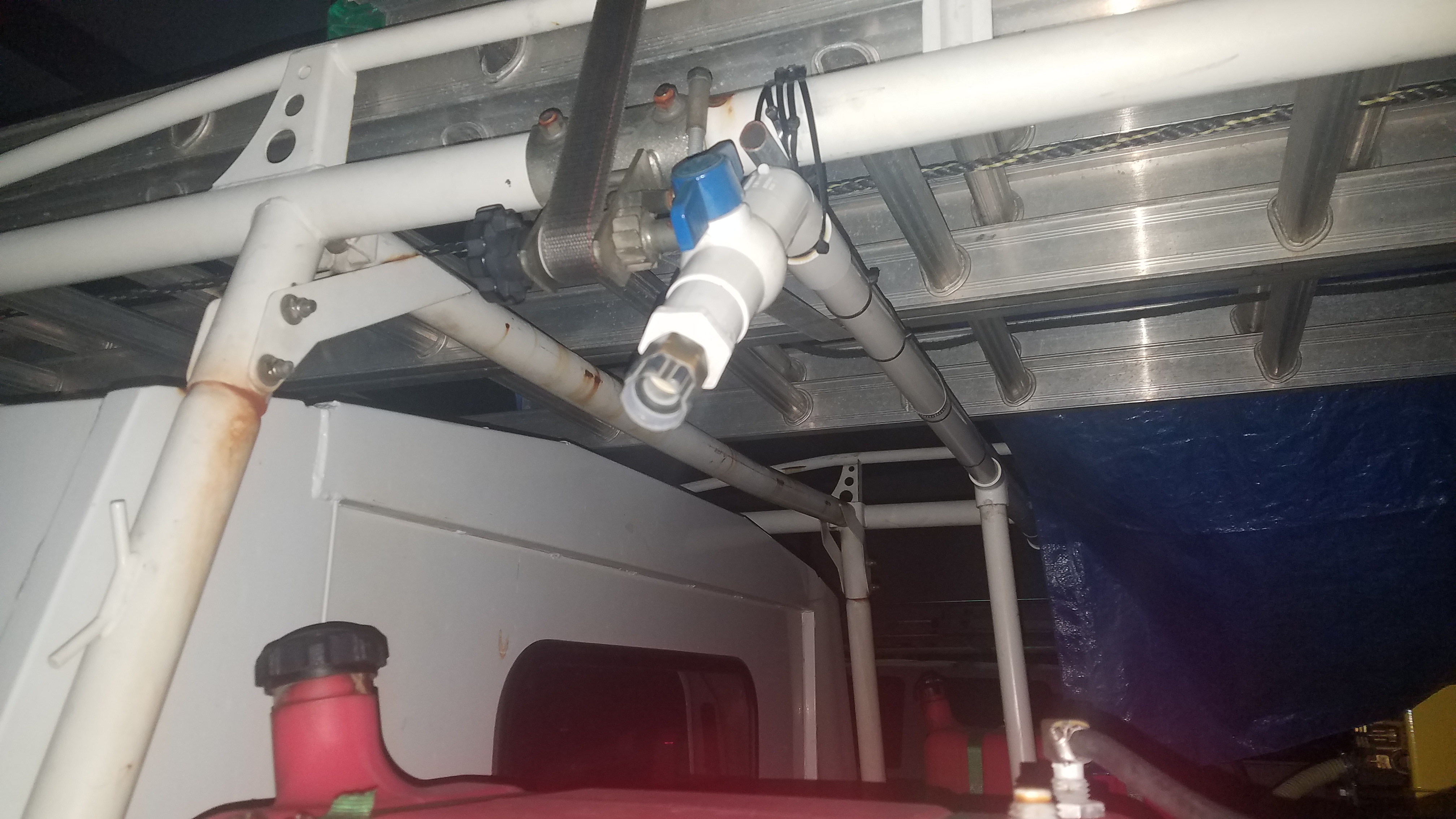

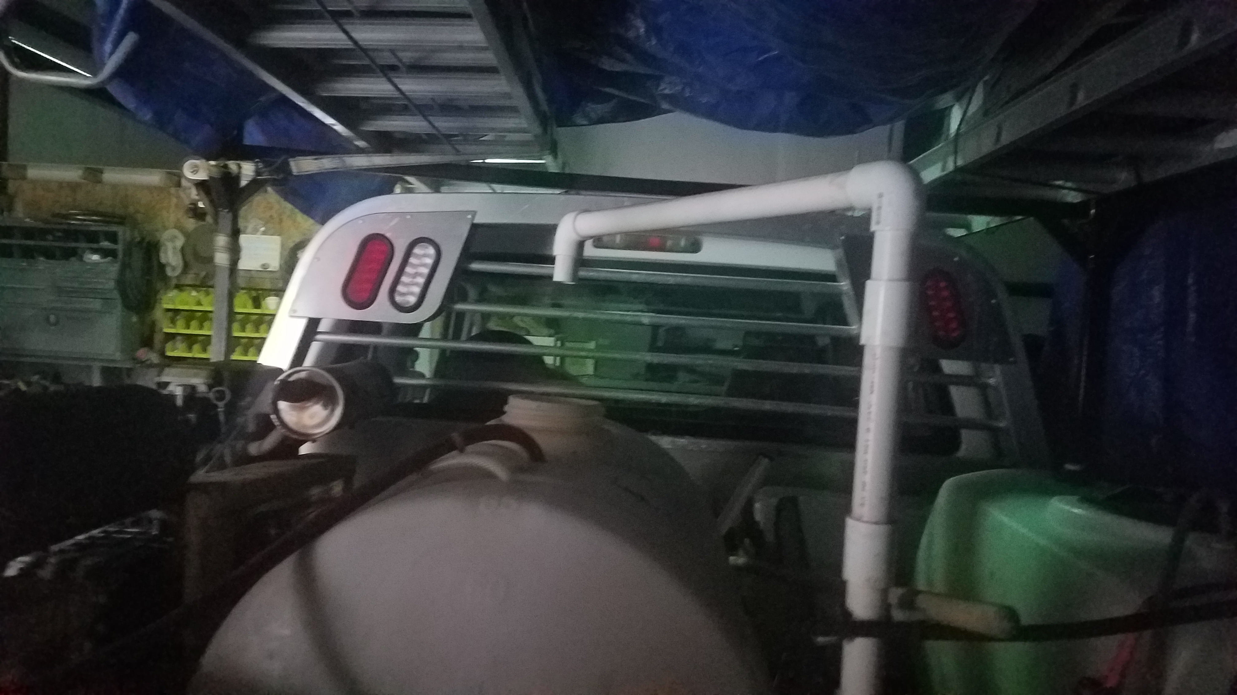

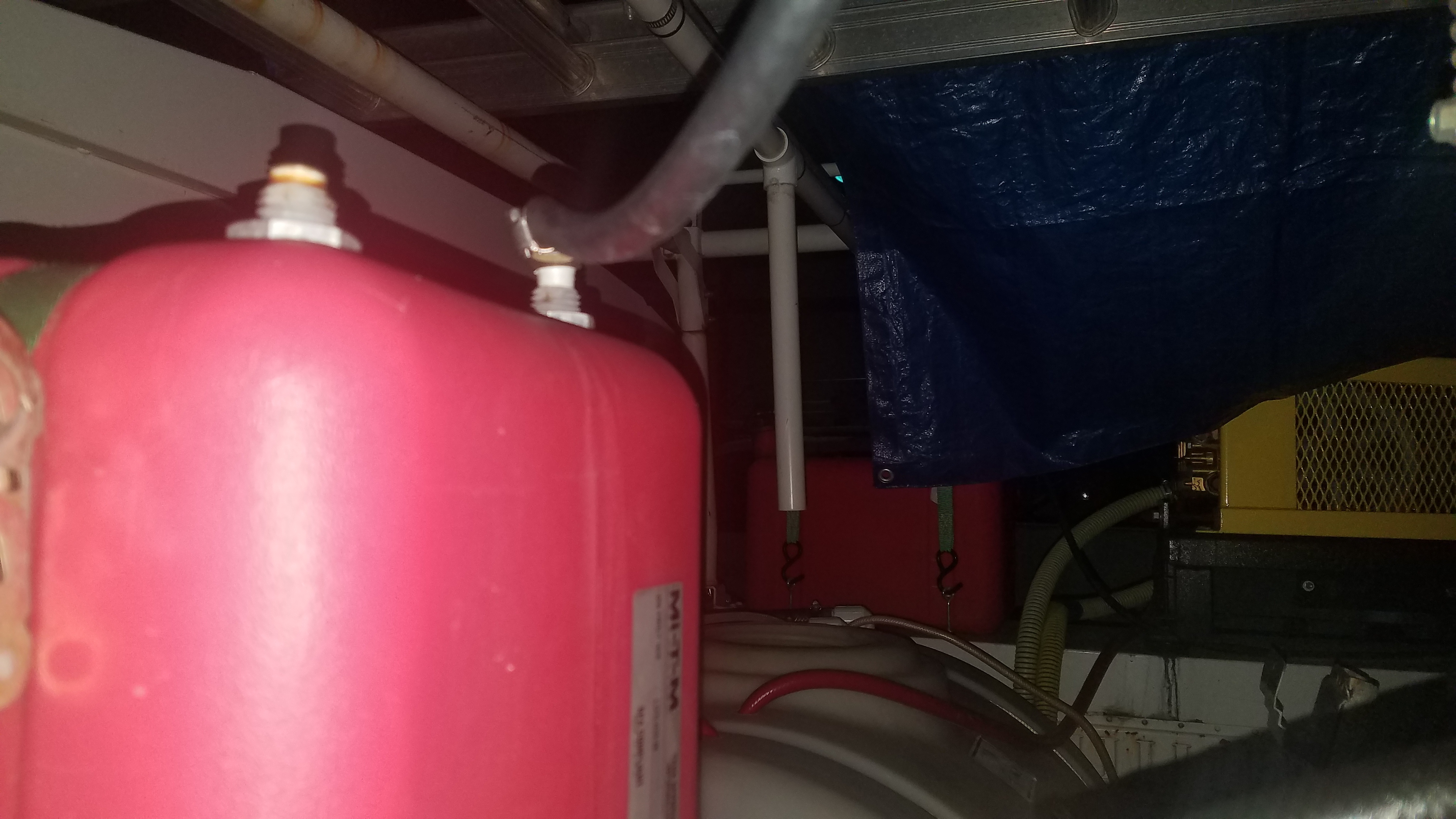

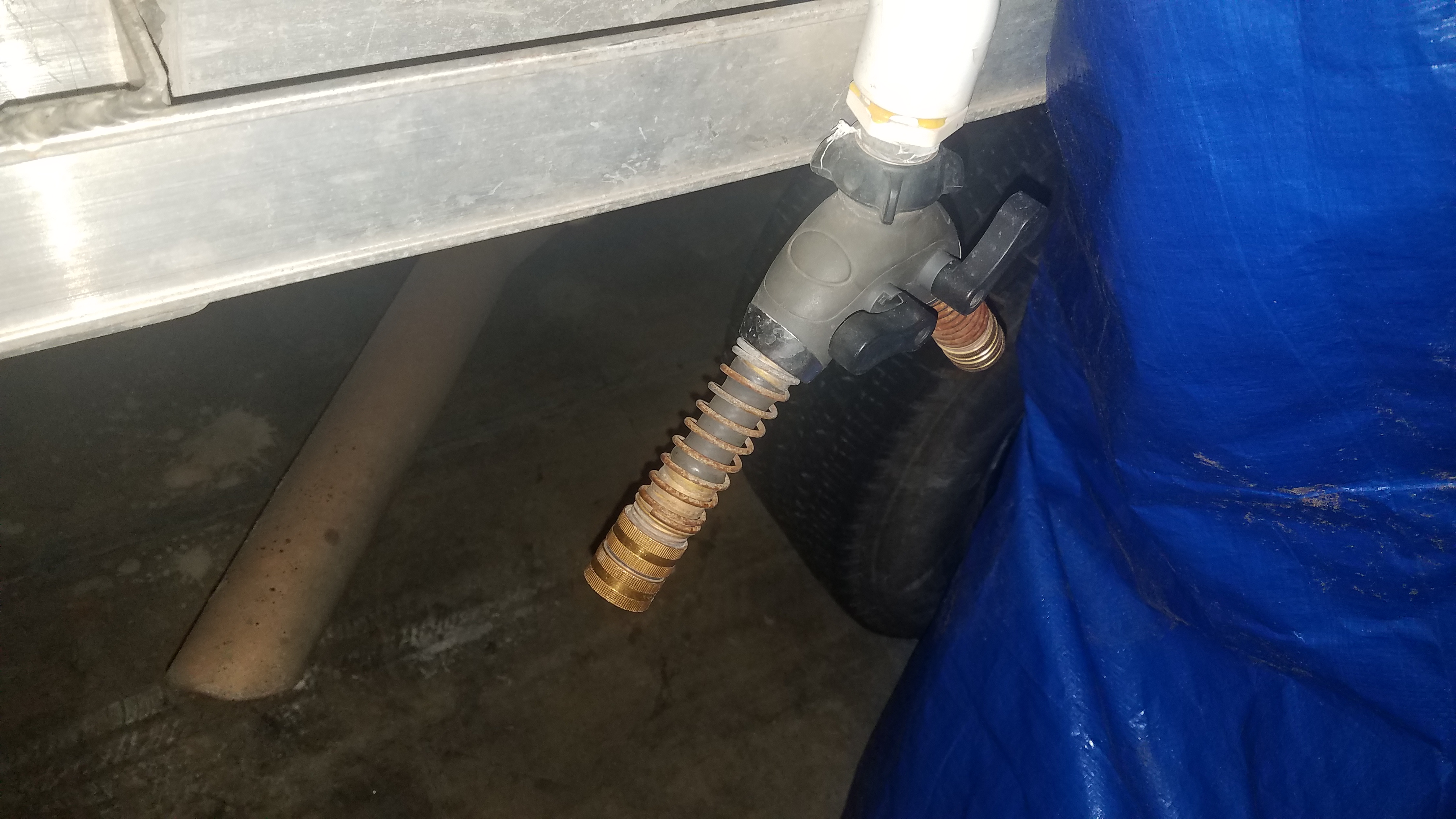

Sitting above tank doesn’t slow water down. Mine are 3 feet above bottom of tank. I was referring to keeping the tank filled though wirh my comment about removing filters before tank
just reread it, my mistake.
But what hose reel do you have for inlet?
Im using a 3/4 metal garden hose reel but i cant stack it. Cant find anything larger than 1/2 in reel/manifolds with Hannay, summit and titan.
I just use reels to hold garden hose. I disconnect hose and run it directly to tank
@Racer
I know Titan has a 1" manifold available.
Thanks, What size PVC is that? Looks like 1.25.
