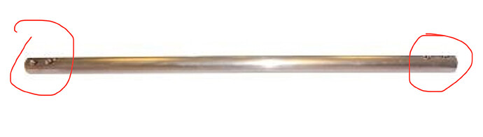

Oh that’s pretty awesome, I didn’t know that that it was an actual bar with four sides. On my Hydrotwister the two tips are right next to each other which effectively doubles the width of the spray pattern. My service cleaner is in storage because it’s currently not working but I found this picture of a replacement bar online and I circled where the two tips are next to each other. My guess is that because it is 28" they are like this to cover more area in a single pass. Thank you for the photos, it’s hard to tell, are two of the tips a little closer than the other two, or are they all the same distance out? Did you notice an improvement with upgrading to this bar?
Tips are all the same distance and angled the same. This 4 bar you get 2 passes verses the one with the old bar. I notice a difference, so much so I bought another for my Ground Force. It’s just a quality bar and it works amazingly well in my opinion. I like the stainless ends as they will hold up way better than the aluminum ends. If you look at an old bar like 3-5 years old, the ends get deformed from all the debris kicking around under the SC at a high rate. I feel the bar gets out of balance slightly and can cause some vibrations…..the 4 bar is really quiet and I feel will hold up well in the long term. We will see as the years go by…..also if need be you can change out the ends if you damage one for some reason. Well worth the upgrade and no I don’t get paid from Whisper Wash, no affiliation what so ever. But they build solid products and need to get credit for that. Makes my job easier for sure. Hope that helps, but if I were in need of a bar, I wouldn’t think twice to get the 4 bar WW one. Worth just upgrading too.
