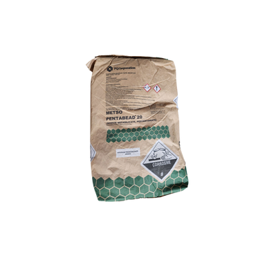

I’ve been searching for the best price for sodium metasilicate pentahydrate. Found Level7 as a supplier, never used them, anybody else?
They have the best price, 50lb bag for $150 (includes a $98 shipping charge). That’s $3/pound, I typically use 8-16oz on a deck so its $1.50-$3.00 in chem per deck which is great imo. I can’t find a better source but I’m all ears if you have one!
I’ve heard of Level7 but haven’t ordered from them myself. Make sure you look into the purity of whatever you are buying though as it impacts the price.
For example, the Pentahydrate version you’re looking at for $45, is only about 58% sodium metasilicate. If you go with the Anhydrous version for $80, you’re getting 100% sodium metasilicate… more expensive overall, but you’re also getting more of the active ingredient you want without paying for water.

I think after some thought yesterday about electric kettles and mini tank heaters and such I’m back to wanting to test the pentahydrate out. Its just weaker ounce for ounce compared to the anhydrous, the pentahydrate has water molecules attached to it that increases the molecular weight but once mixed in water we’re talking about the same molecule, we could call it aqueous sodium metasilicate. if you just increase the amount per gallon of the penta to account for the “waste” water molecules you’re adding then you’ll achieve the same cleaning effectiveness and if I can get away without any warm water shenanigans even if its a bit more expensive compared to anhydrous, then it won’t really matter to me given that we’re talking about the $3-$5 range for chemicals for the deck and the deck prep/stain jobs are almost always +$2,000.
The pentahydrate also has the added benefit of being less caustic in powder form, there’s less chance of it getting in the air while working with it and in your lungs (not that you shouldn’t be wearing a respirator at all times when handling these types of chems but the point is still worth making that a less caustic chem is a better chem all things else equal)
I’ve used them. They’re legit.
