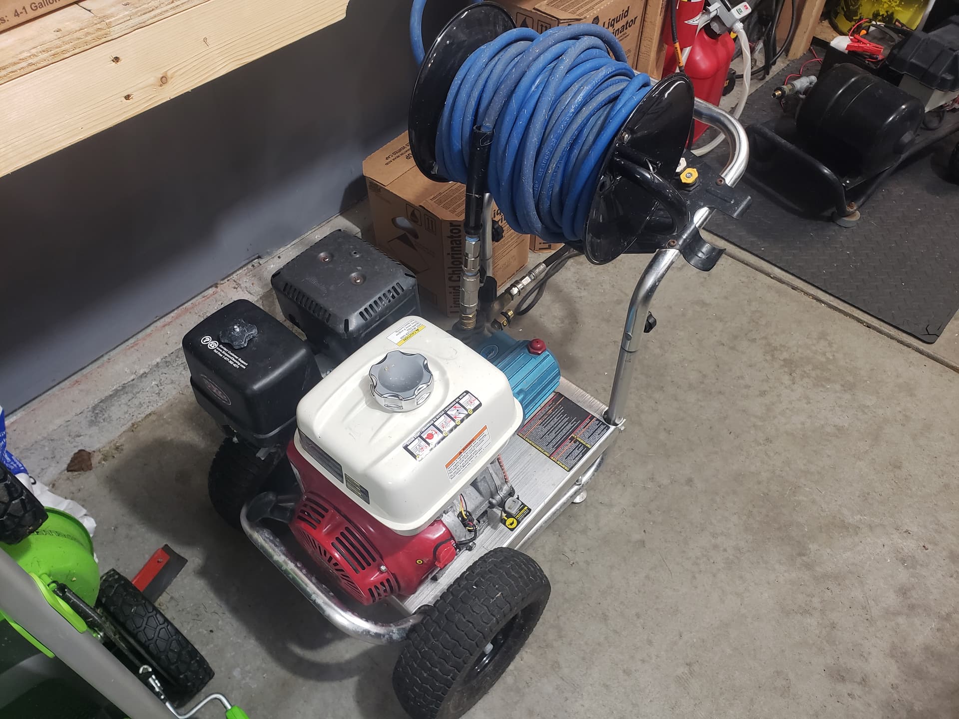

Genuinely did not know that you even owned a pressure washer. Let’s see that rig!
Lol, maybe 10% of my jobs do I use it. Rather not, but a lot of people want the driveway done with a house washing. It’s just a 4 4000 Simpson with a Honda 390 and Cat pump. Going on 3 years and it still runs great!
