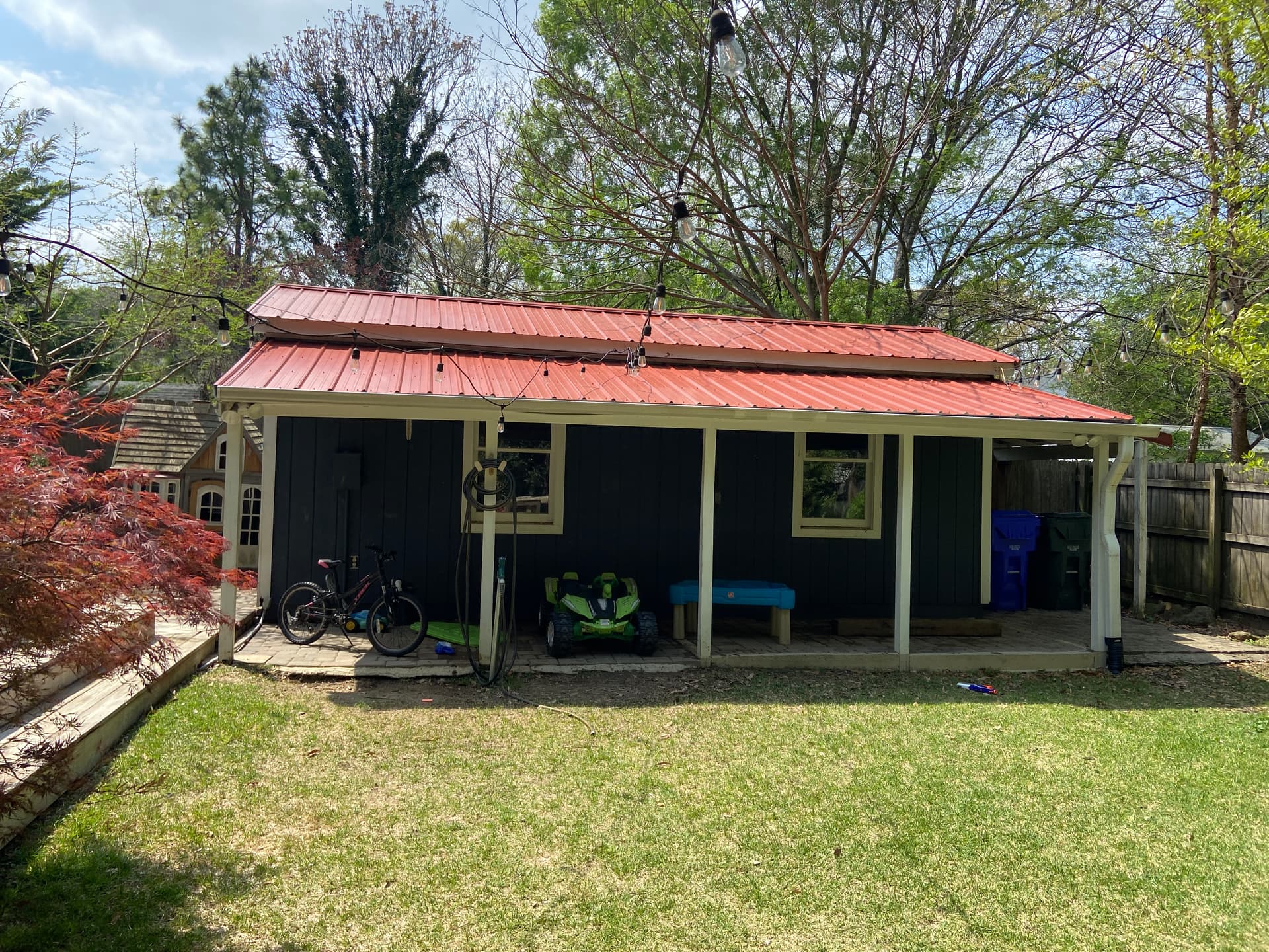

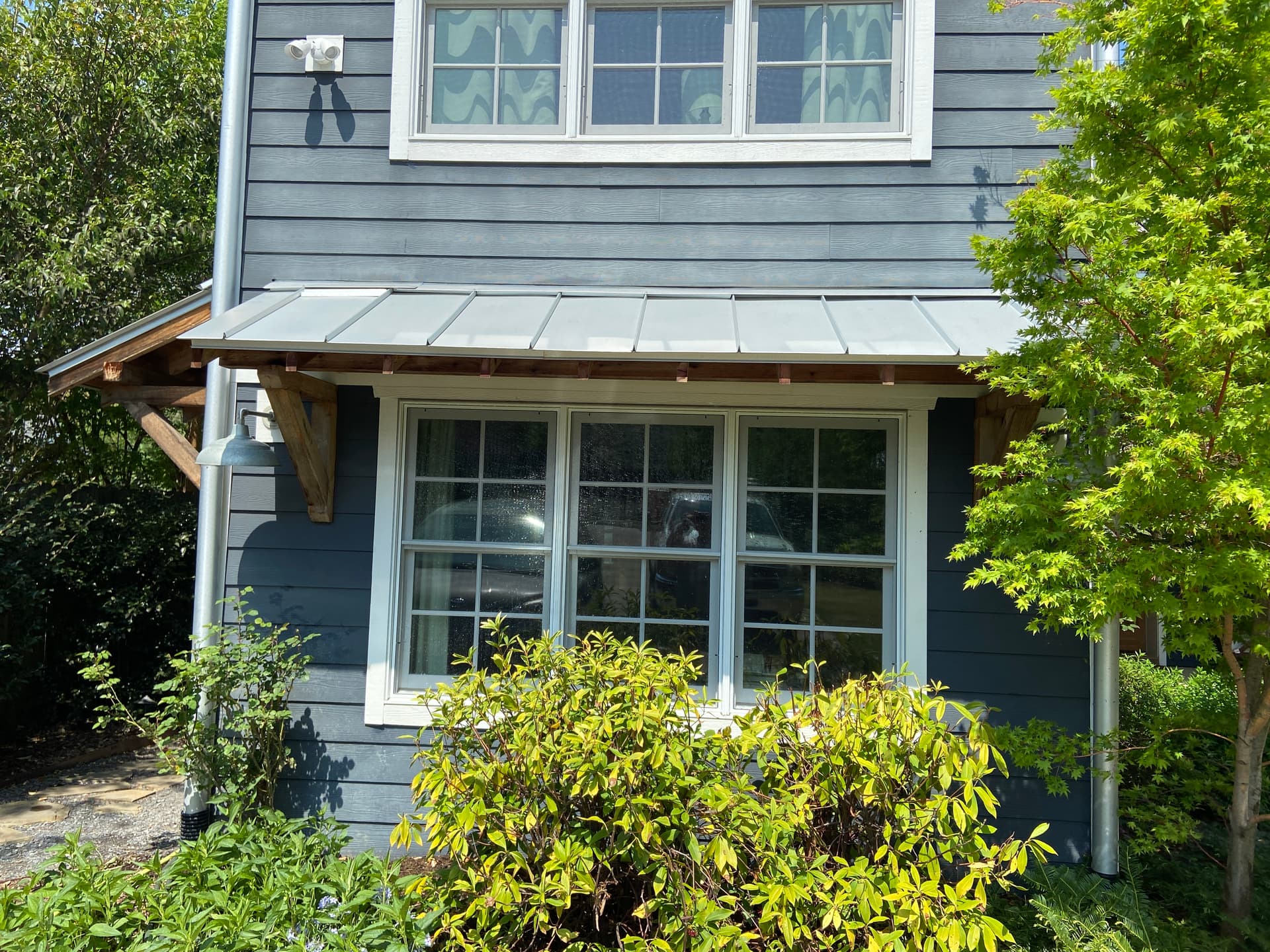

Did a galvalume roof a few weeks ago that was pretty dirty. 2 coats of hw mix about 5 min apart and about a 600psi rinse cleaned it pretty good. However both on painted and the galvalume have found that just running a soft brush over it, not scrubbing, just stick up there and pull it down, improved the results.
Looks good. Any rinse in between? Or just 2 coats 1 after the other?
just one after another, may not even be 5 min. Don’t let it dry on there and if it’s hot, pre-wet to cool it down.
