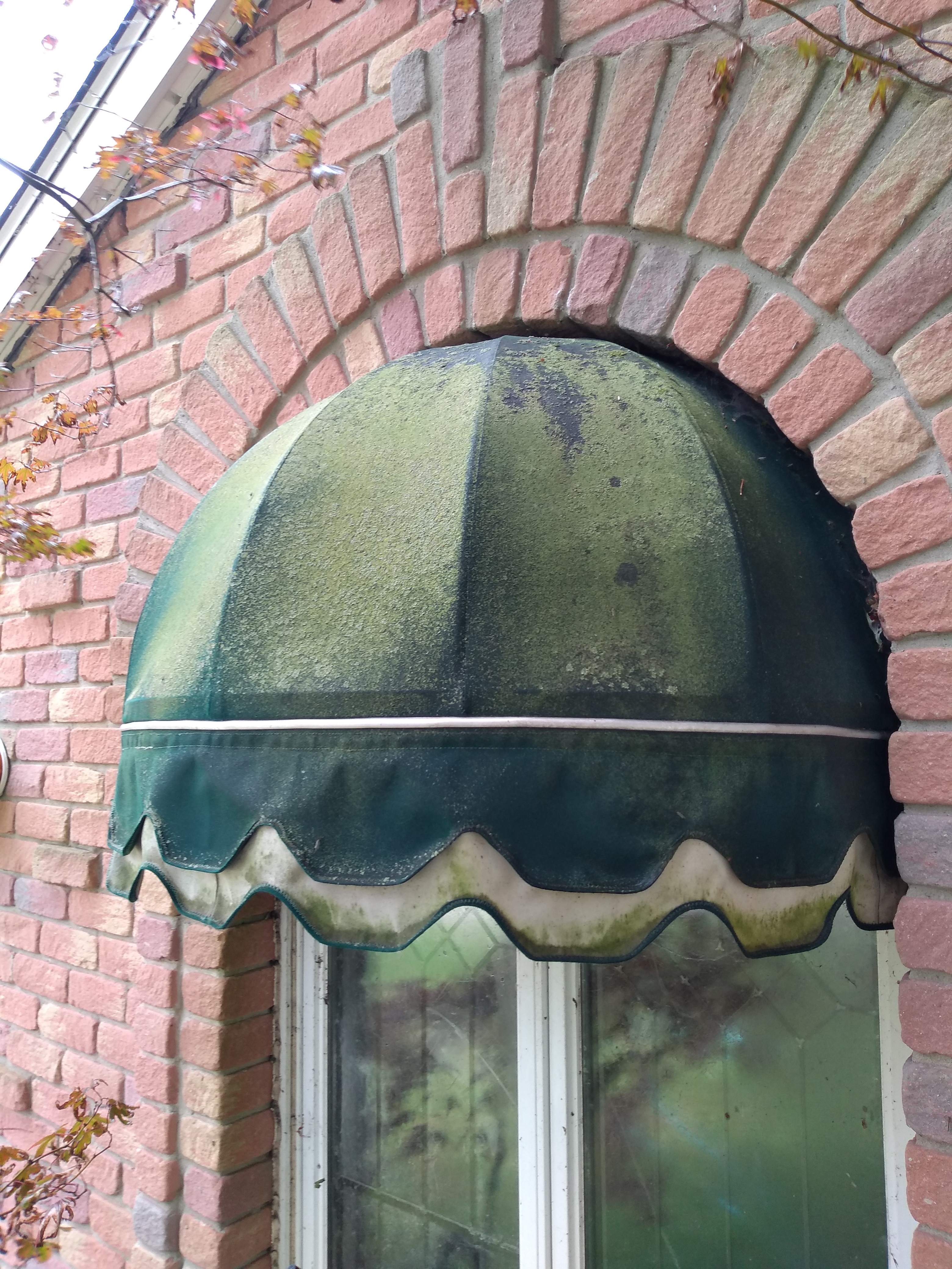

What do you use to clean awnings ?
Bleach oxygen, bleach .
Any suggestions
Depends what’s on them…

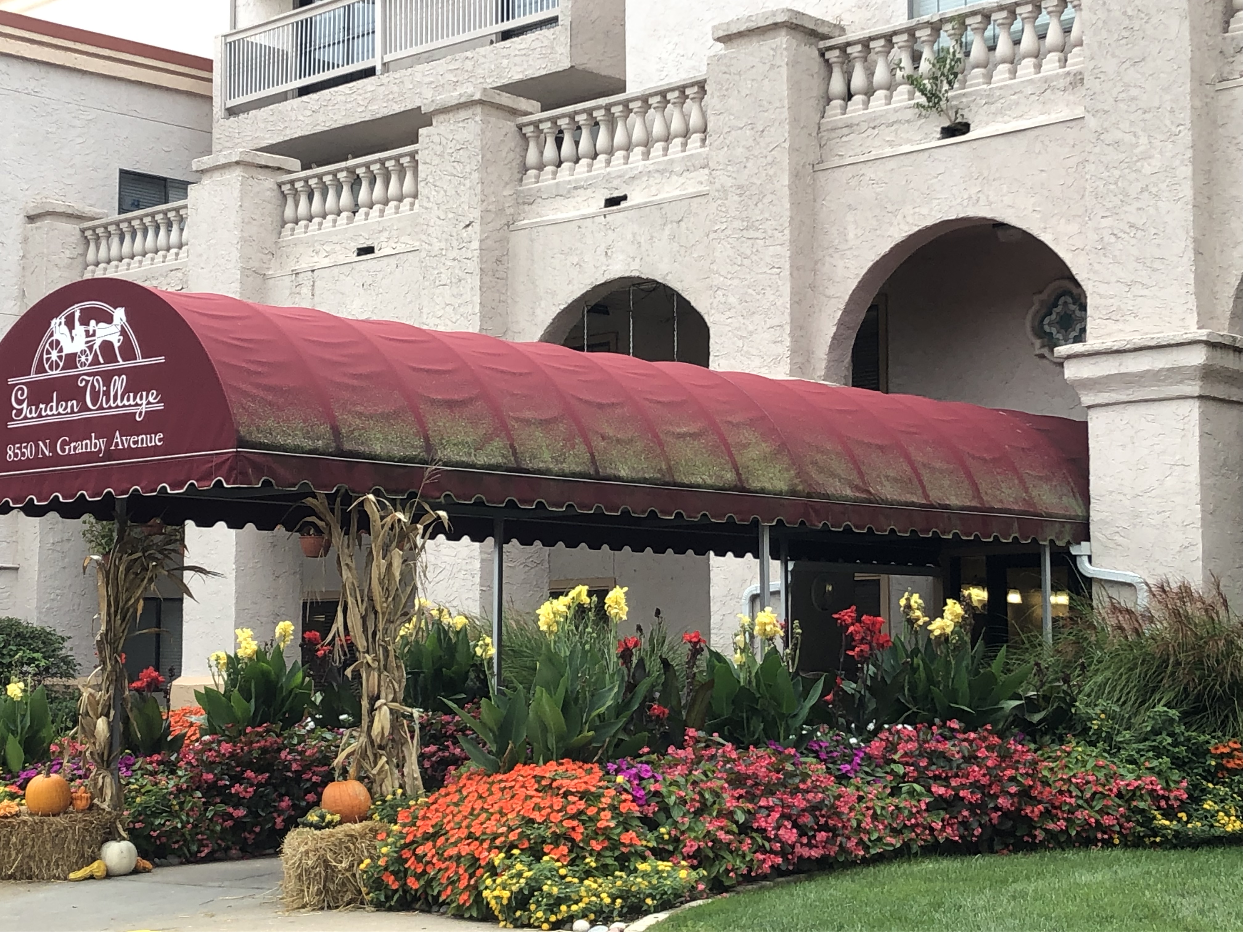

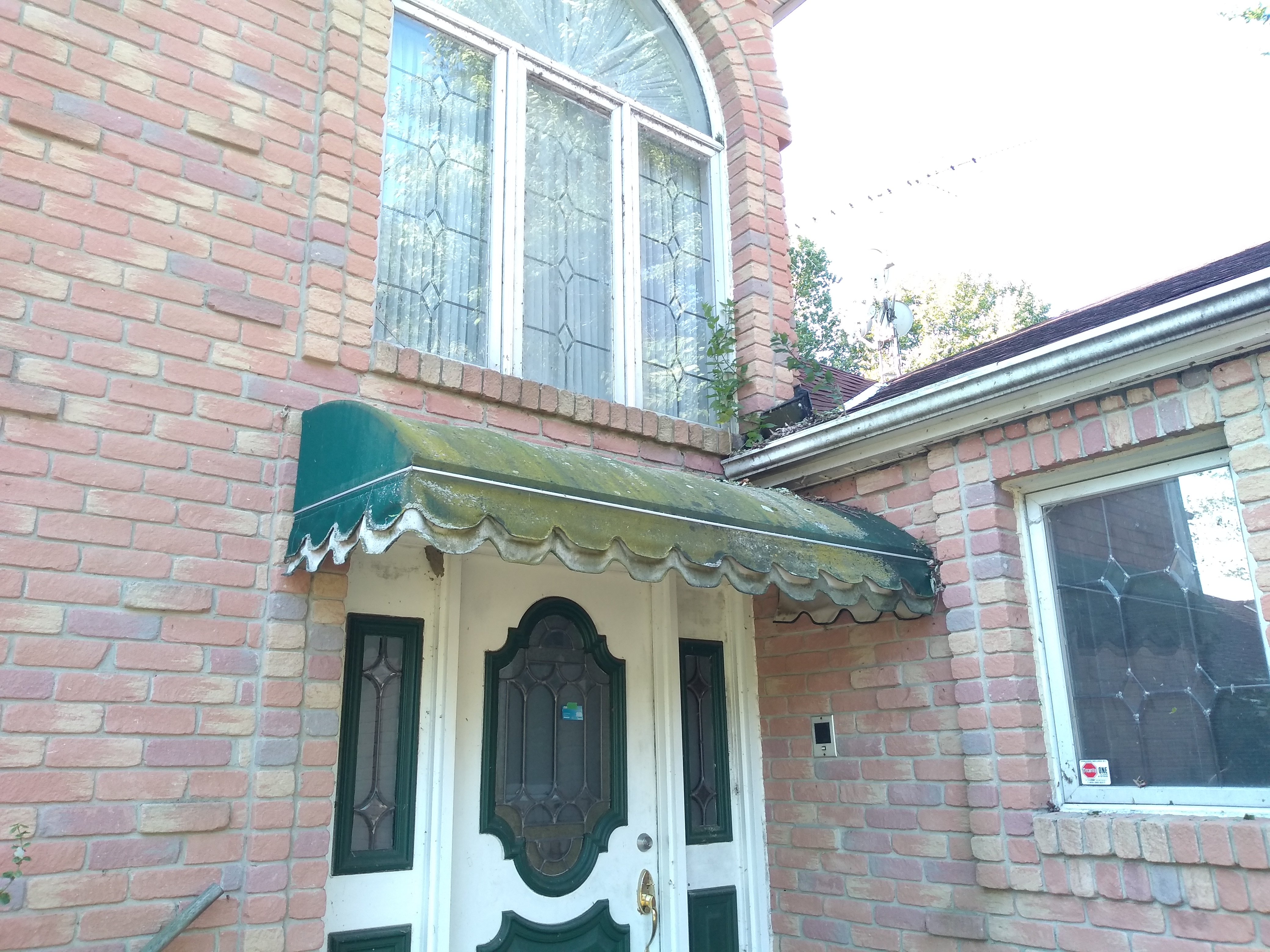

I have a customer with the same exact awning issue, I don’t think she’d go for $100 each though.
This awning was a test for the main awning. Same process. No shadows.

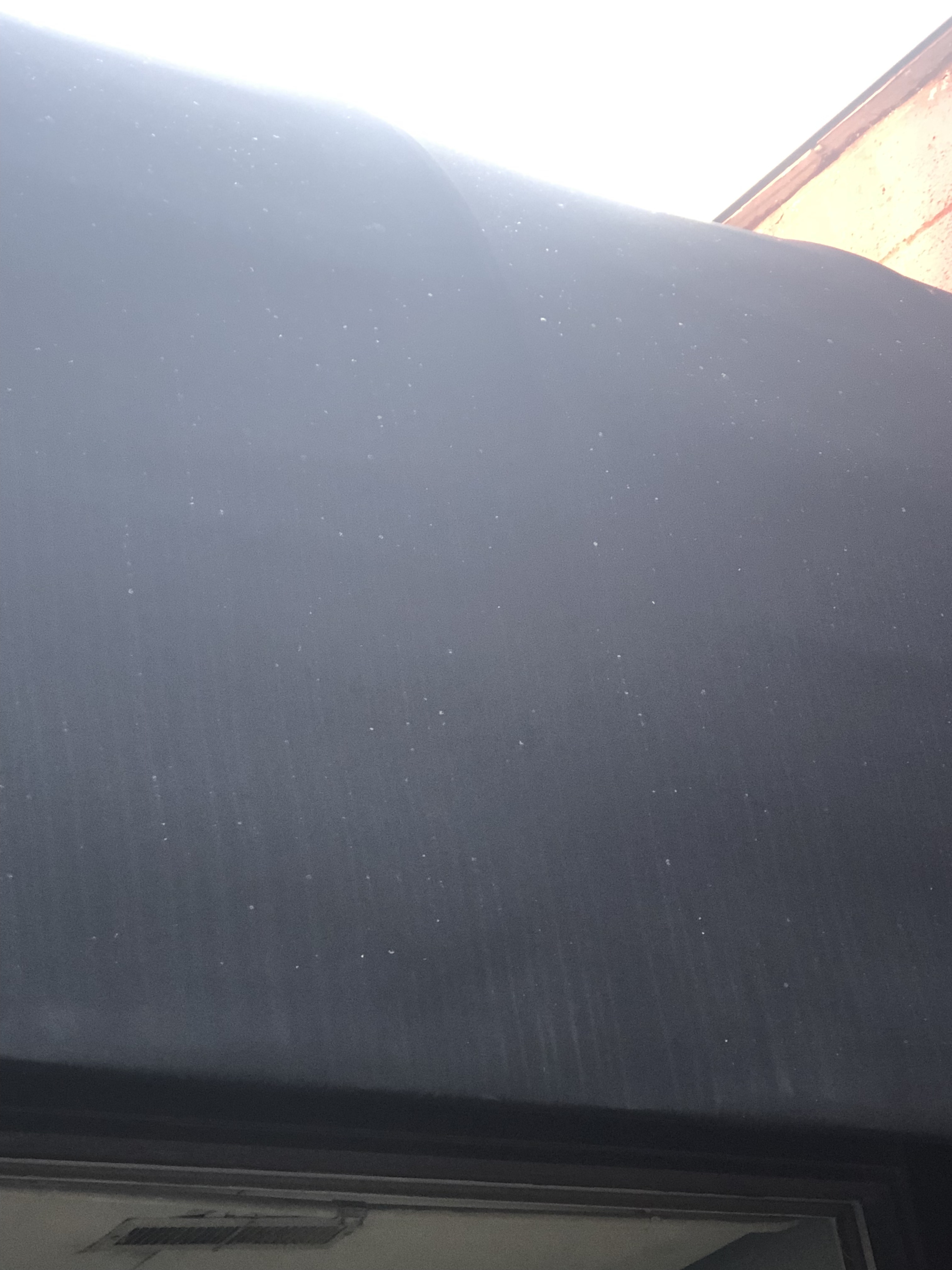

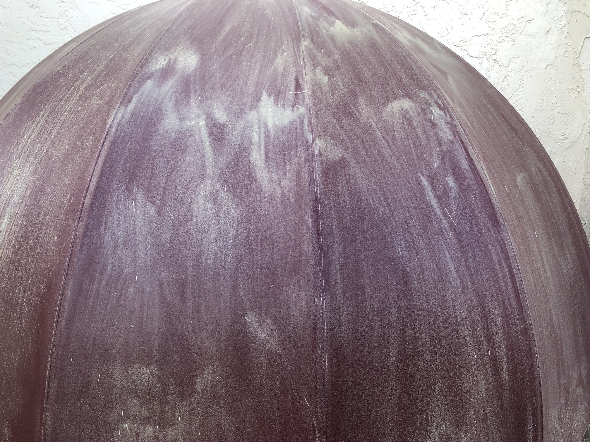

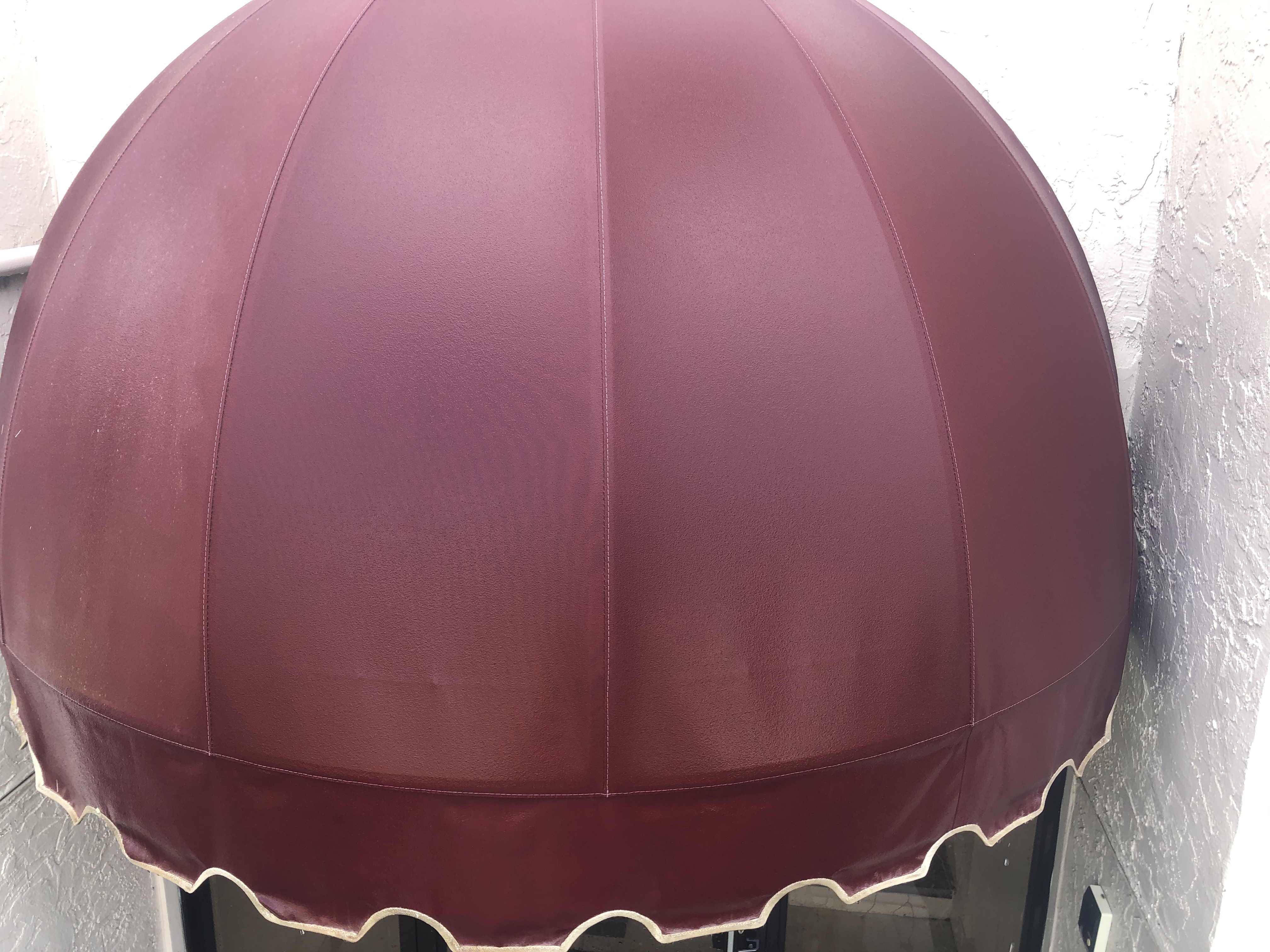

Cleaned a couple before with no issues but this thing is driving me nuts. Hit it with 50/50 twice, scrubbed, scraped. Looks great from a little distance and before and after looks awesome but up close you can still see this. My next attempt is dragon juice at 10/1 and see what happens. Any other ideas?
Try one more time with the 50/50 and a splash of EBC. If that doesn’t work the streaks might be metallic and I wouldn’t dare use F9 or oxalic on them. Might be baked in the cake.
Sounds good. Yeah hitting with an acid never crossed my mind lol

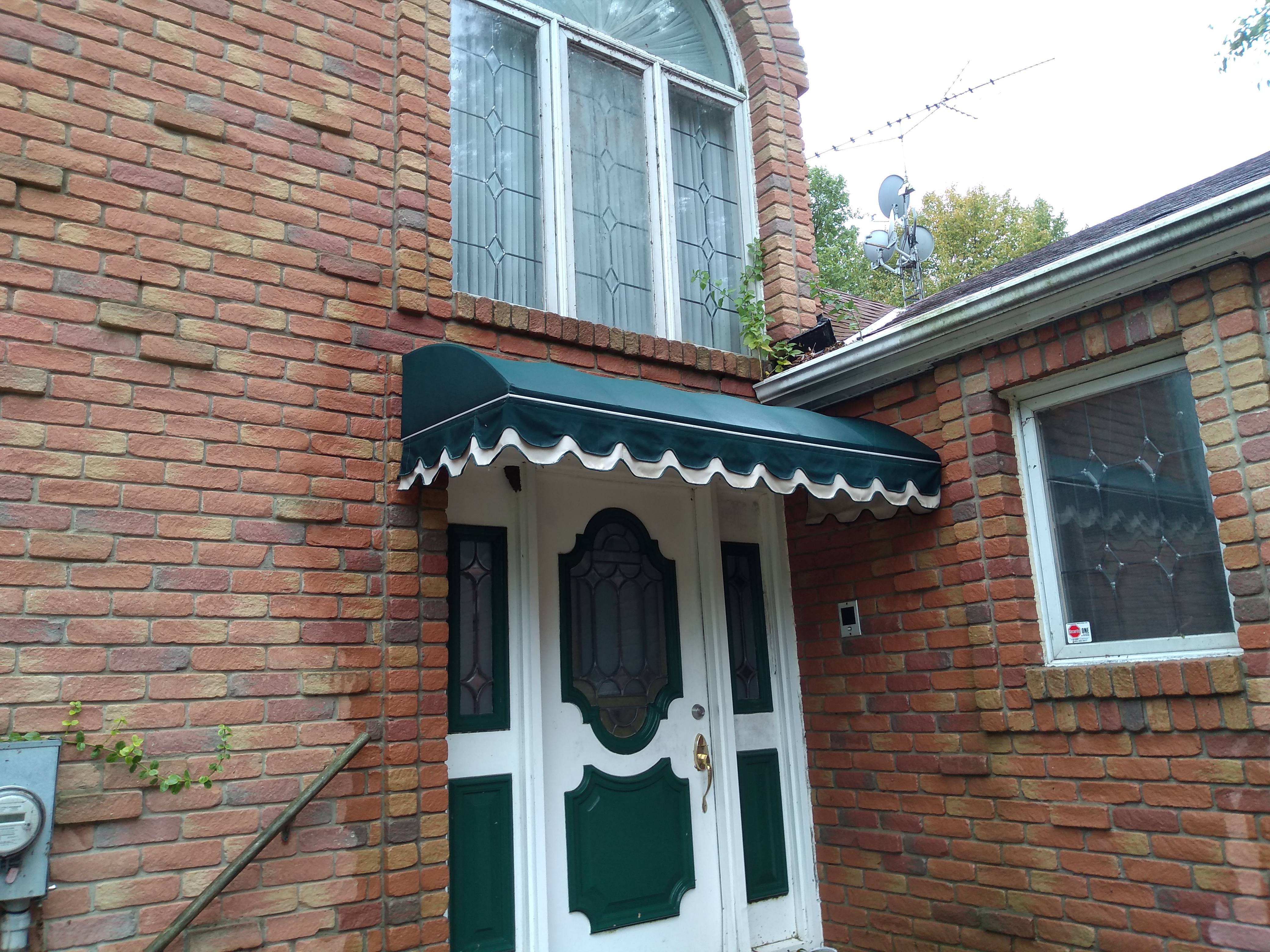

Ridiculously good looking. Did you have to scrape or just use your super hot mix and lots of scrubbing? Thx
Thanks man. Both. See the video above.

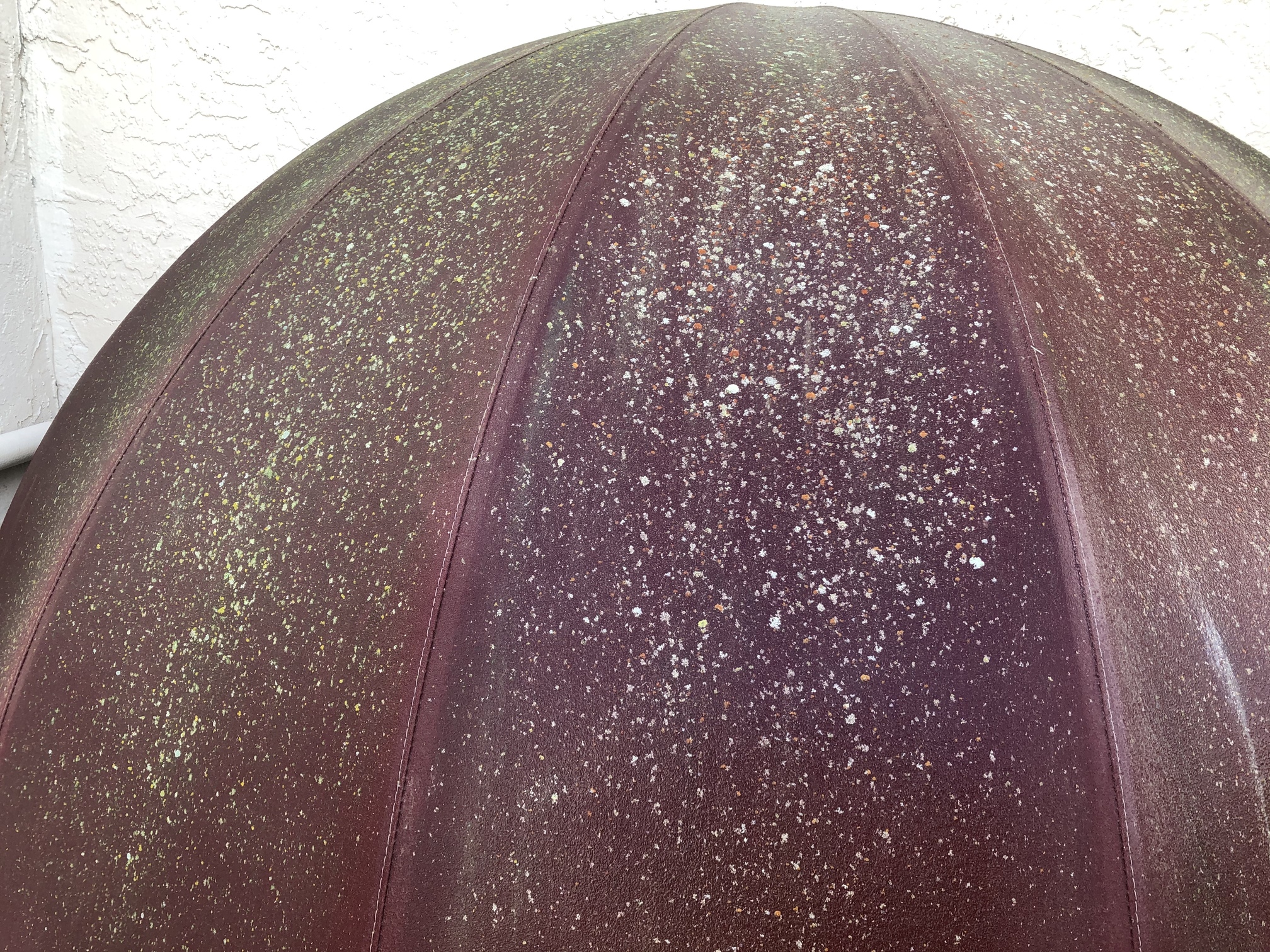

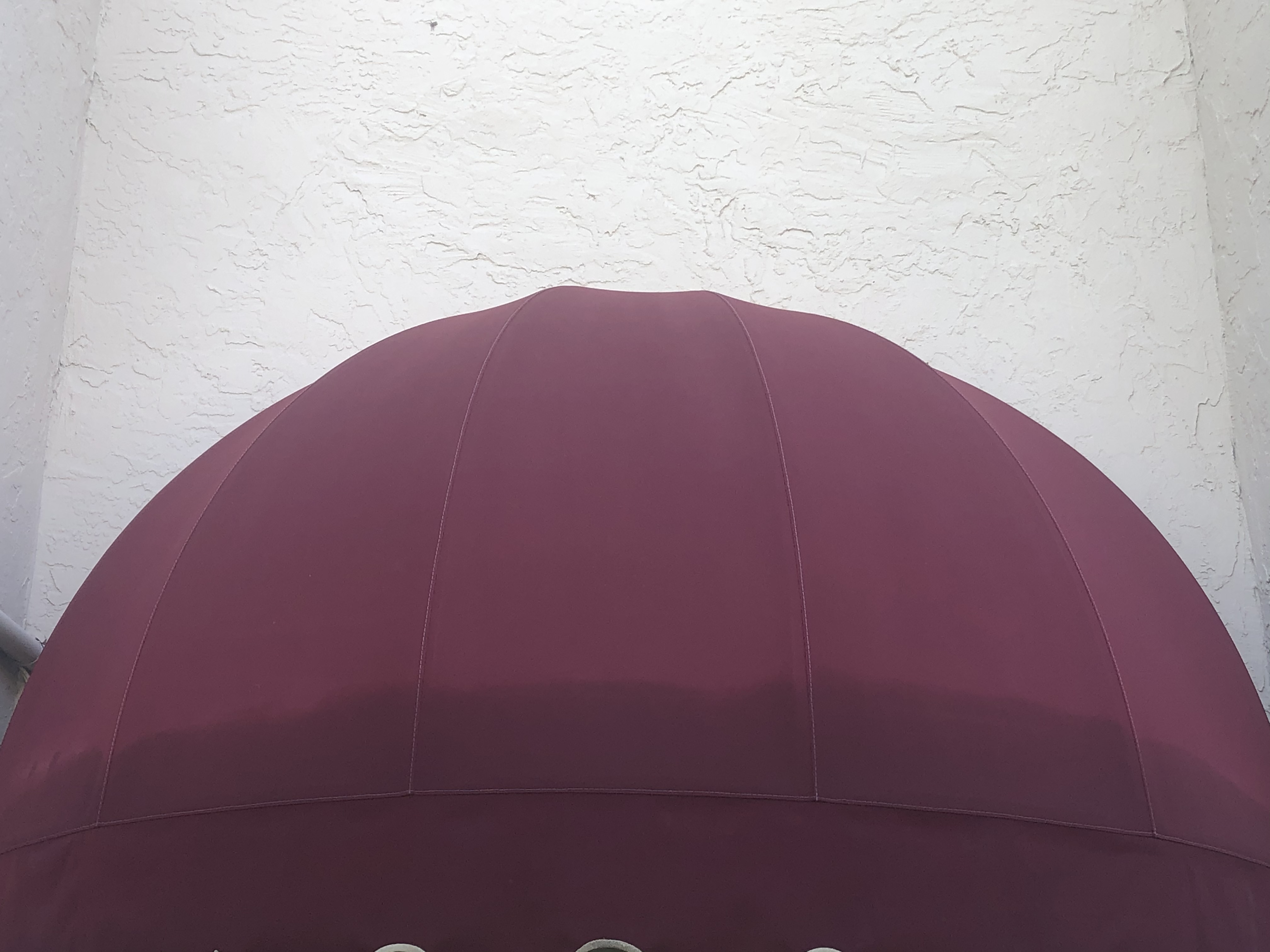

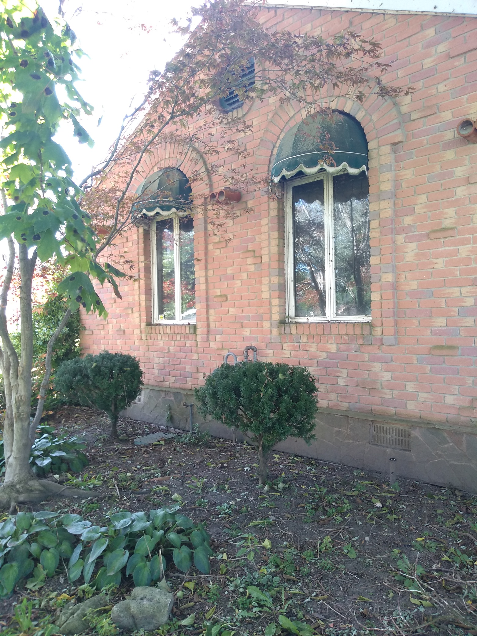

Did the job today. These ones had quite the growth on them but they turned out great. Thanks again @squidskc
You the man @anon37135677 !!
Looks awesome buddy !
Any hand scrubbing involved?
No you’re the man! Haha thanks. Yeah but it’s a simple process. Apply close to a 50/50 mix with some elemonator, use a scraper with dulled edges and end to scrape off the growth, apply mix again, scrub with stuff brush, then medium pressure rinse with around 1000psi. Sounds like a lot but it doesn’t take long and it’s satisfying to see them come clean.
Yeah , more involved than a simple house wash. That’s art work restoration you’ve done there my friend. nicely done man! @anon37135677
