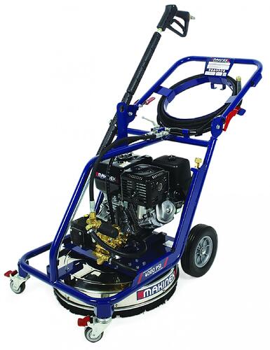

Great information. I have been thinking about a couple of these… Have any experience with them? no hot water, but entire unit is portable and only moving water hose, which is on every building…
Dual Pressure Washer | Pressure Washer | Makinex USA - Products
you will hate yourself if you buy one of those. They are heavy, will get stuck in the mud and terrible in tight areas like patios.

Thanks for the information sir. I think not having heat is a big issue for me…
Heat for resi work is nice but 99% of the time, not needed. And the ones I linked to can be used with heat.
