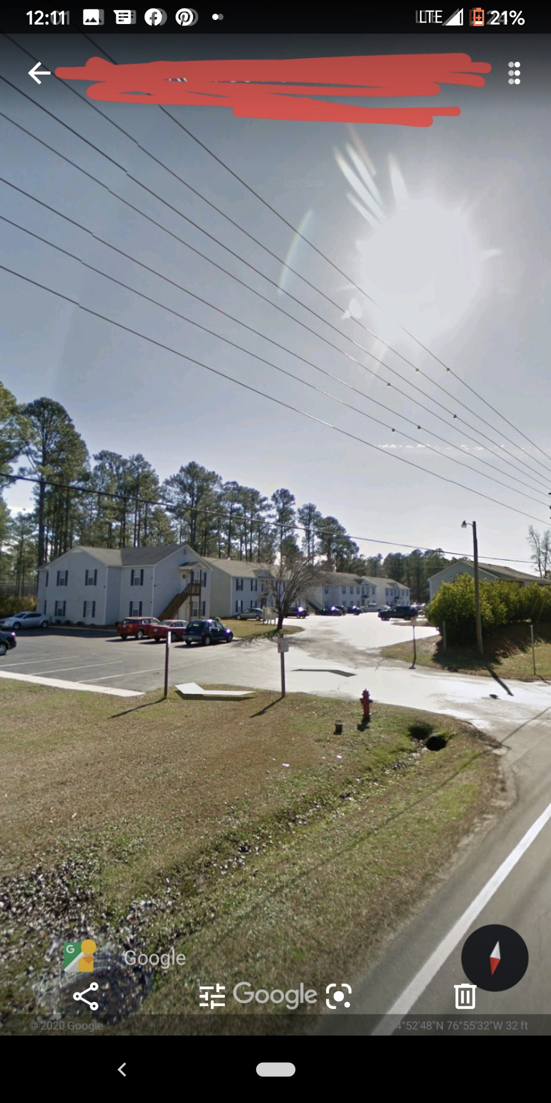

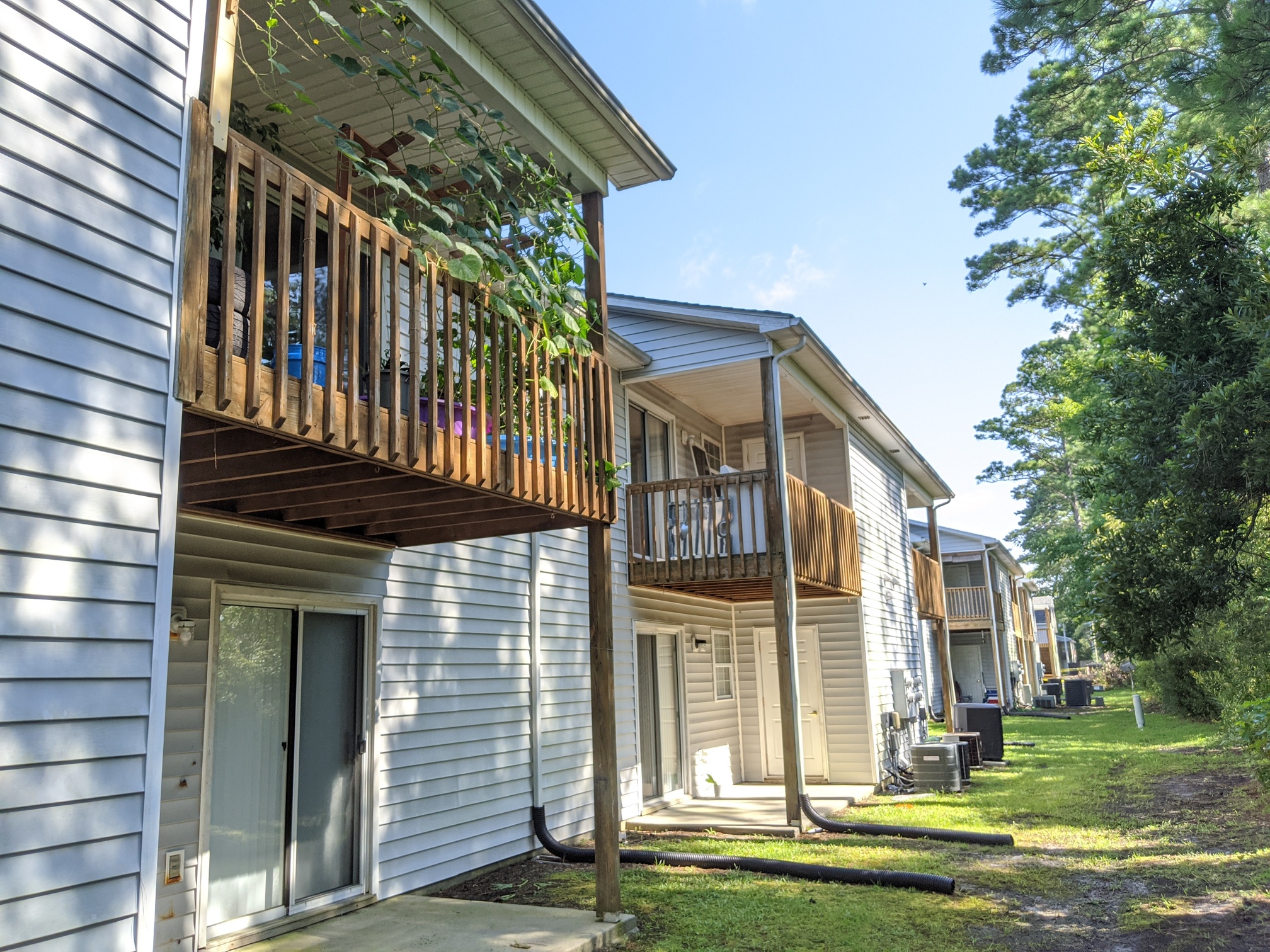

I was helping a buddy do some tree work at this complex. She saw my truck logo and asked for a quote.

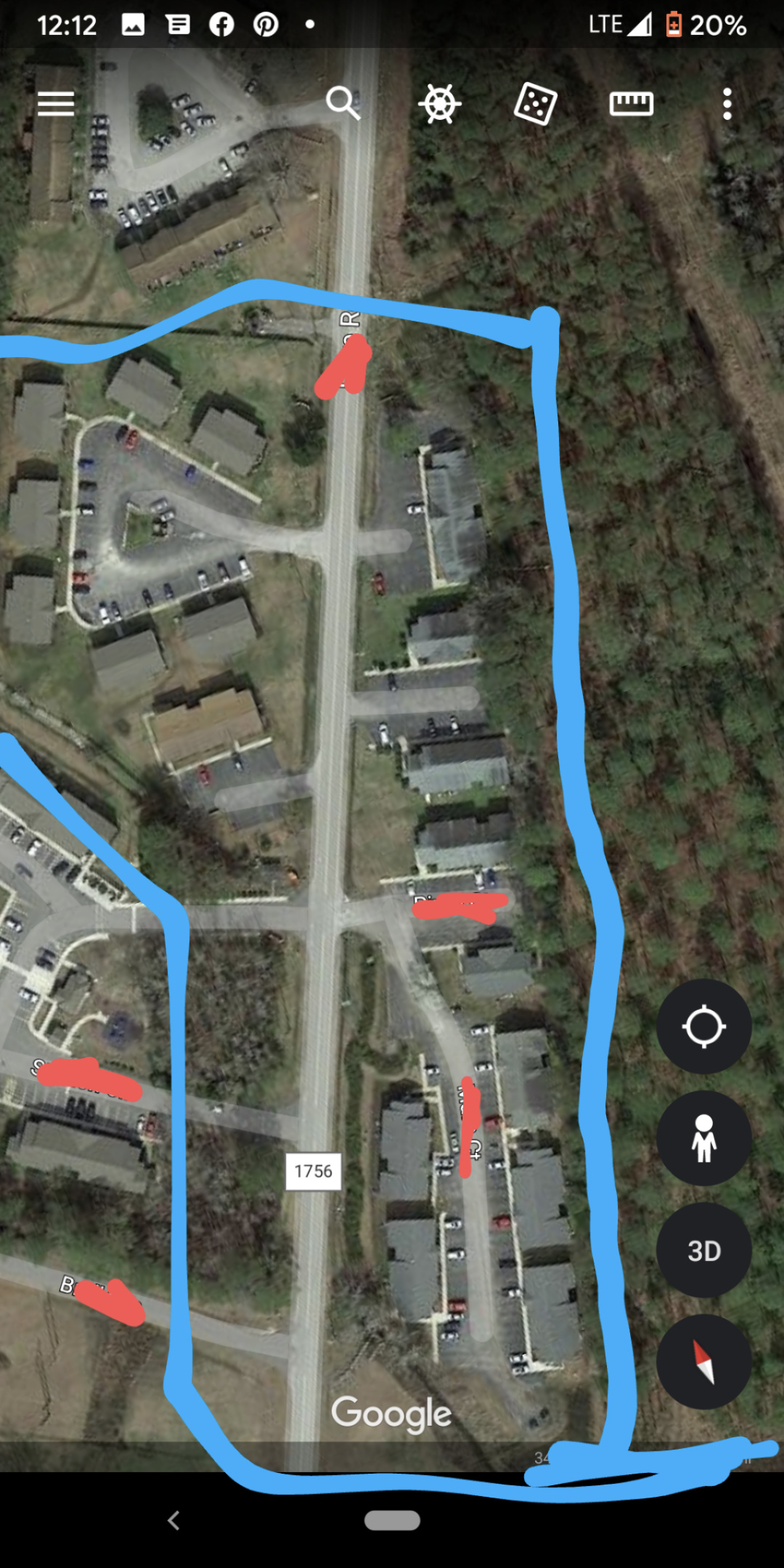

18 buildings

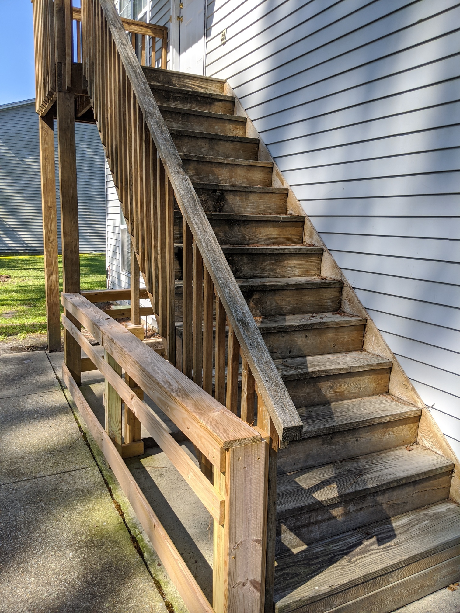

Every one of them has second story decks and atleast one breezeway stair case with failing stain.
She asked for a quote to just clean building and concrete, and another for all the wood.

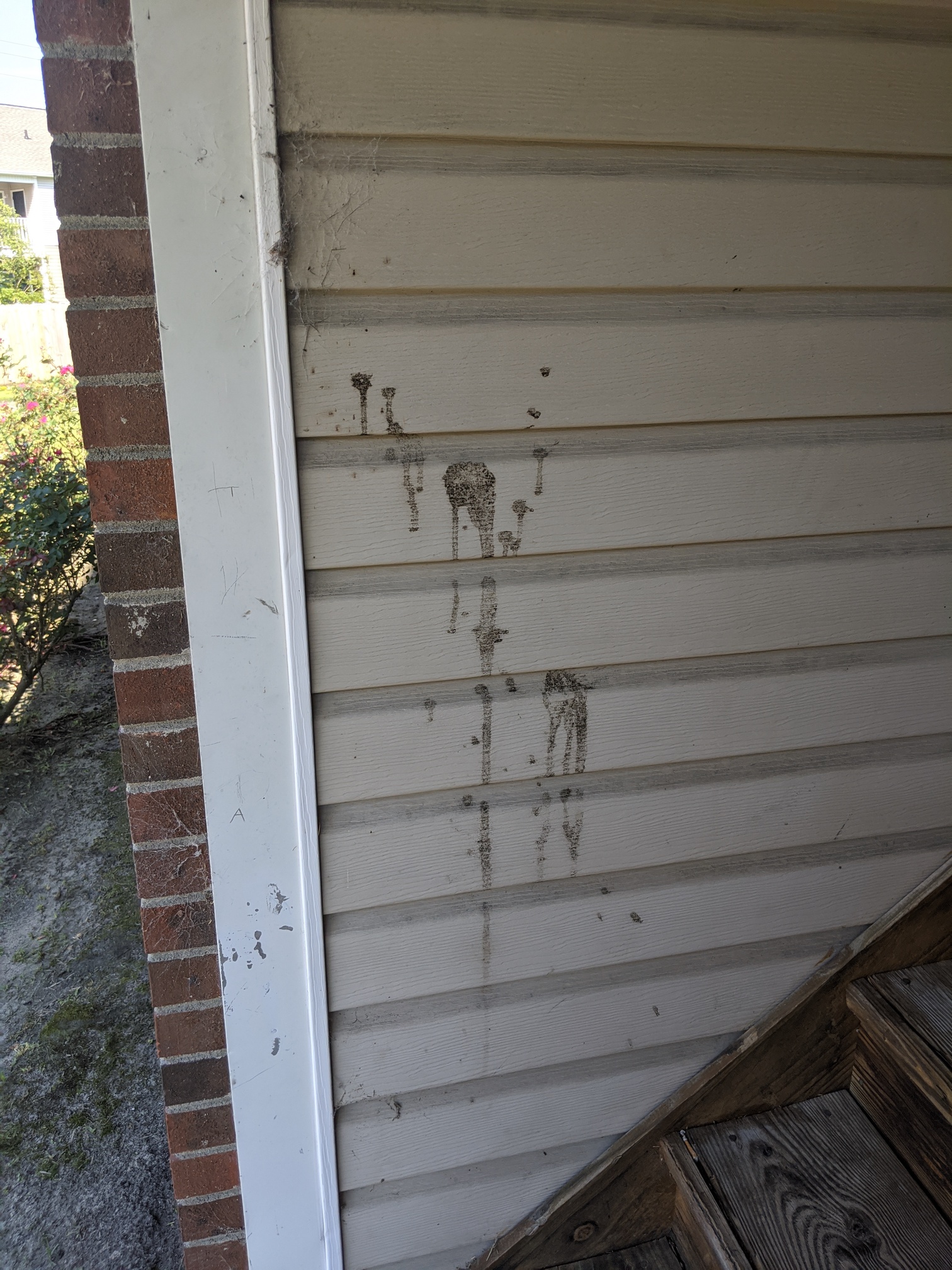

First, I found some grill grease and soot on some sections wondering what’s best for that to not disturb oxidation? I want to say I saw somewhere on here they said dragonjuice.
Second, second story decks. What’s going to be the the best way to handle the situation. If they don’t move the items off don’t clean it. Tarp the wood so the house wash mix don’t leave clean spots.
Third, they have put up new rails around stairwells the have some sort of sealer on them. I’d rather just clean the building and concrete not have to deal with 18-24 different staircases to strip, brighten, and sand like I will recommend what it is needed.

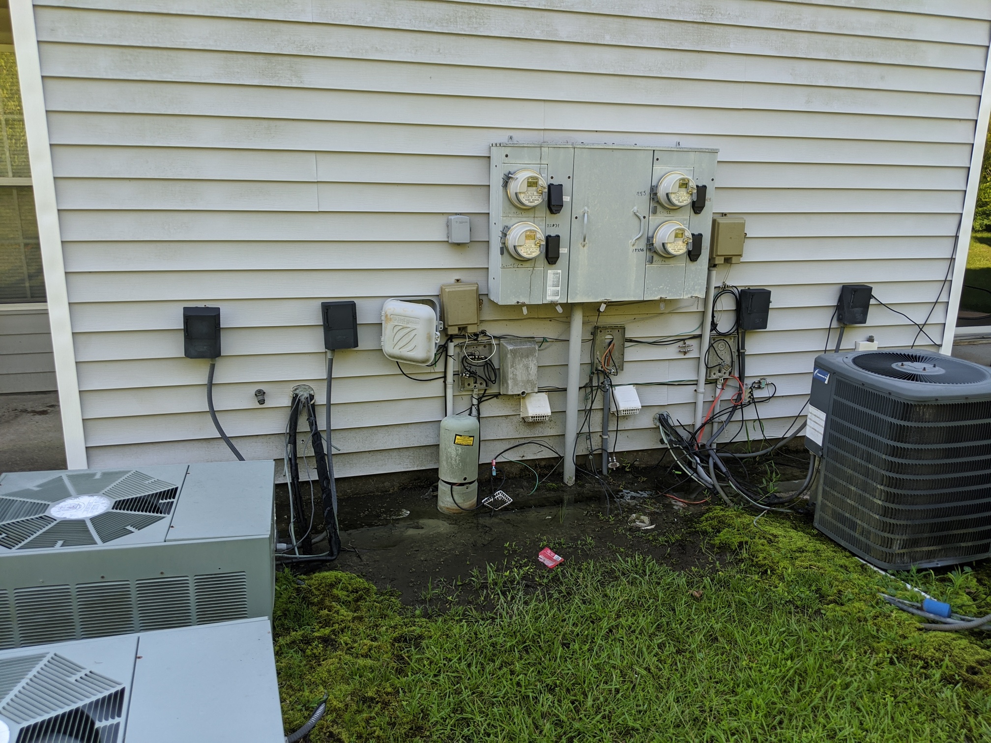

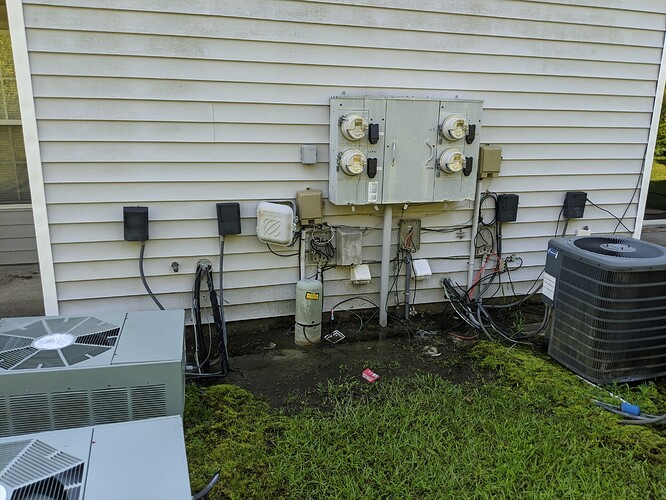

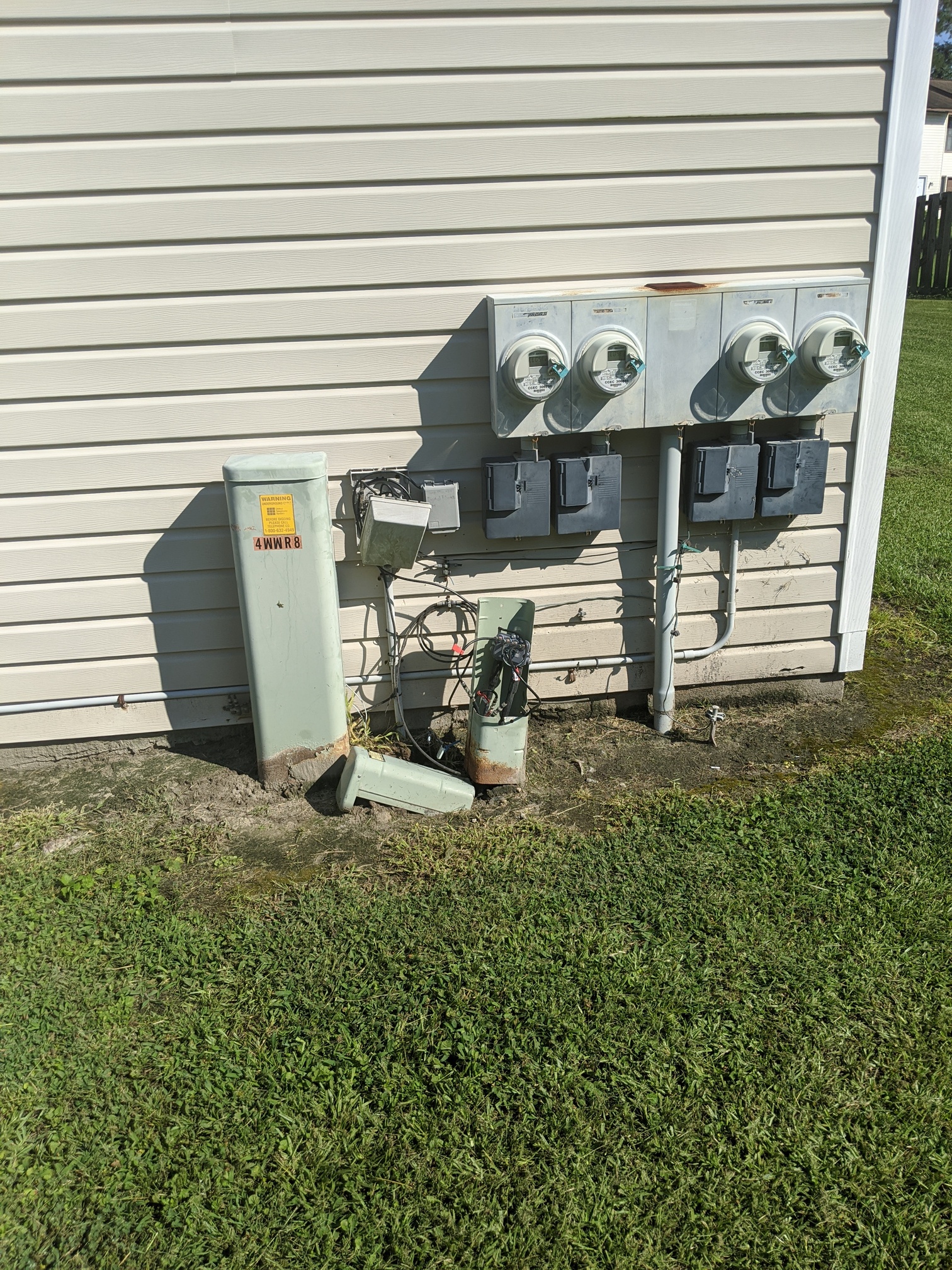

Then they have poor maintenance on electrical related stuff surrounding the buildings tons of the powerboxes are rusted.

wow, what a rats nest of wiring back there. If you get the gig, make sure you have plenty of pics of that mess.
The grump specializes in big apartments I believe, consult his grumpiness.
Yeah I walked around a was like holy sh+t

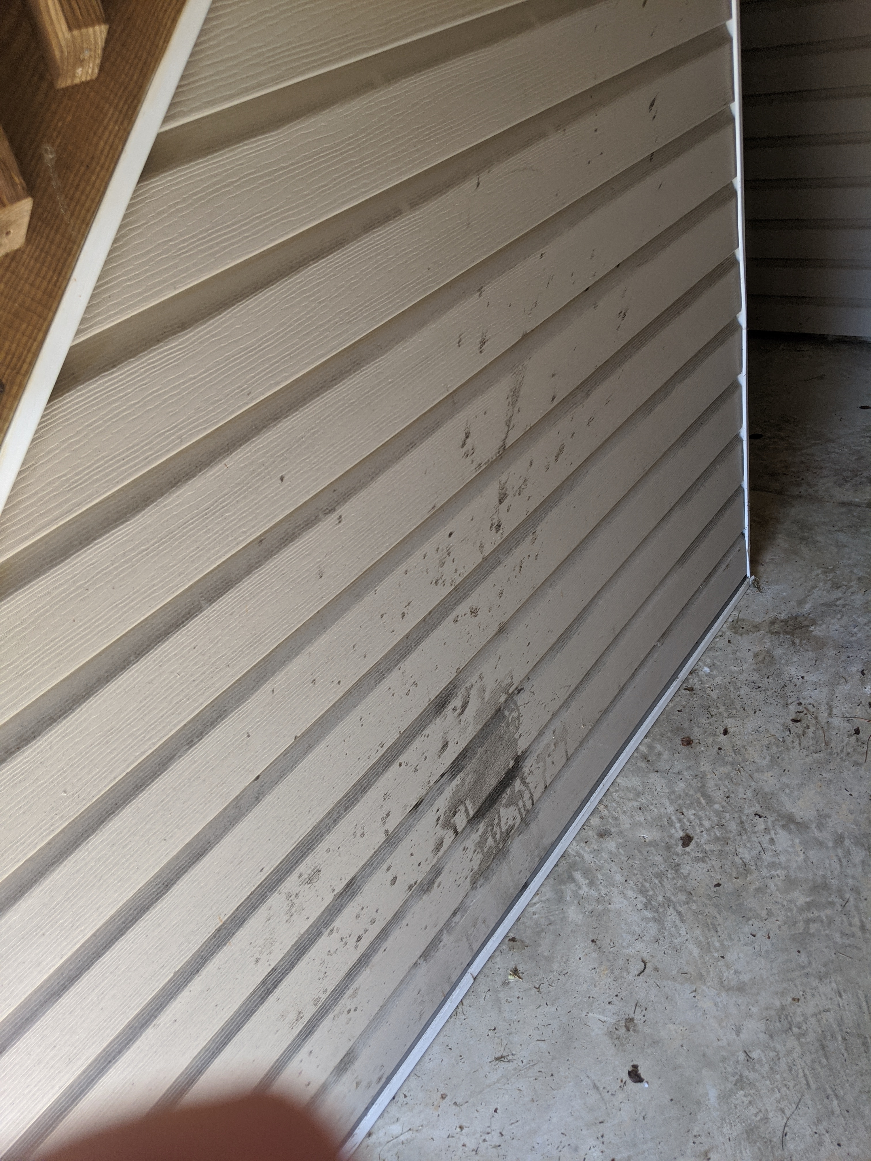

Documentation gonna be key on this one . Holes is vinyl rust here and there etc. Gonna have a whole photo book of previous issues

First off, message me and tell me what area this is in. I have several properties that are identical to those. If it isn’t one of mine, I’ll post here what I would do and what I would charge. That’s an easy property. One day with three machines.
If it’s section 8 they won’t pay for concrete or decks. Even if it isn’t I always try to pitch not doing sidewalks as a money saver for them. My estimates says low pressure soap and rinse of pressure treated decking. If you can work it so you are only washing siding, and surface cleaner inside the breezeways, one guy should be able to do 7 a day, six if you have to do sidewalks. If it’s section 8, $275 a building. $350 if not. Tape on the key holes. Any balcony with stuff on it is like free money. Just something you don’t have to wash but are getting paid for. I wouldn’t worry about taping up those panel boxes.

All the failing stained wood is going to lighten up, no biggie just rinse it off?
