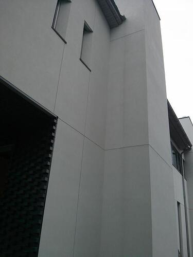

This is staining from roof runoff on brand new plaster. I already tried a brush application of 10oz. Simple cherry, 2 gallons water and 1/3 gallon SH. didn’t do much. Any thoughts on my next step?

F-13.
Tried it, no dice.
I ended up using several applications of OneRestore, with marginally good results. I think the builder is just going to have it whitewashed.
Did you try acid?

One Restore is acid.
