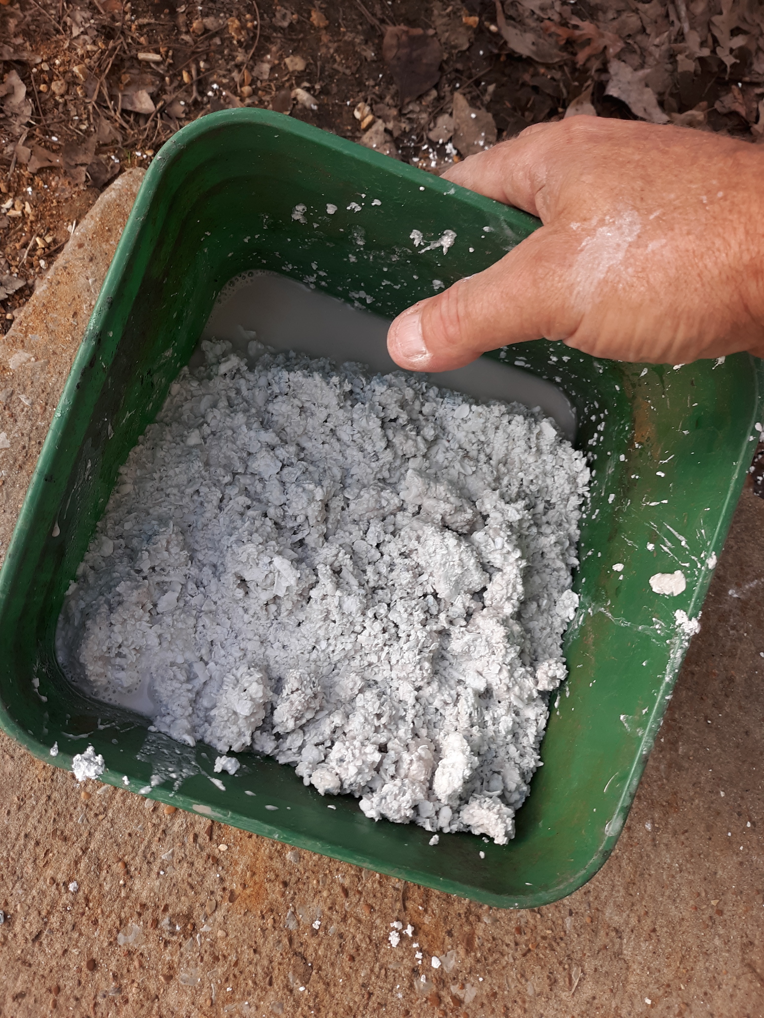

Sediment is like 6" thick. I’m going in.

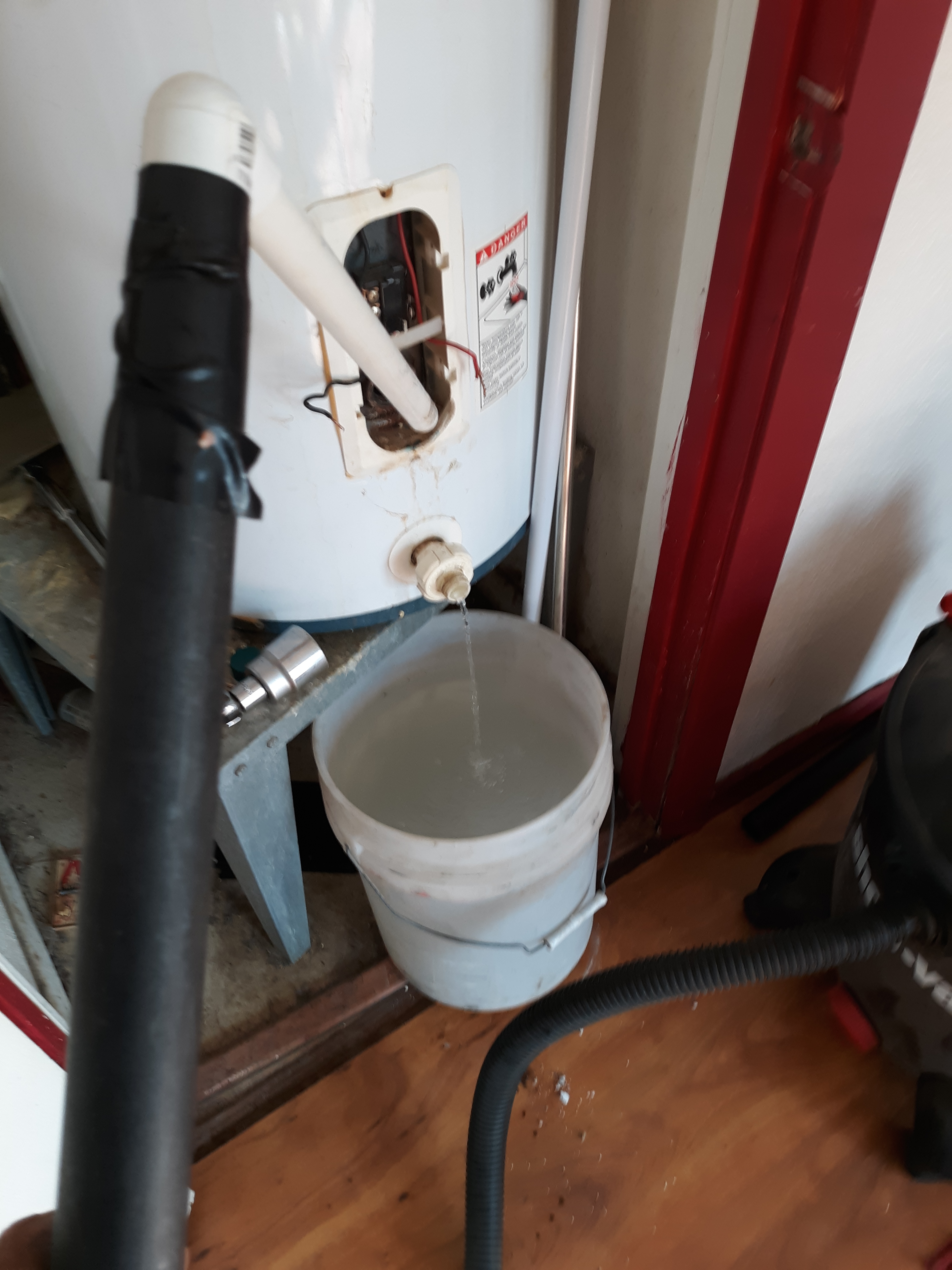

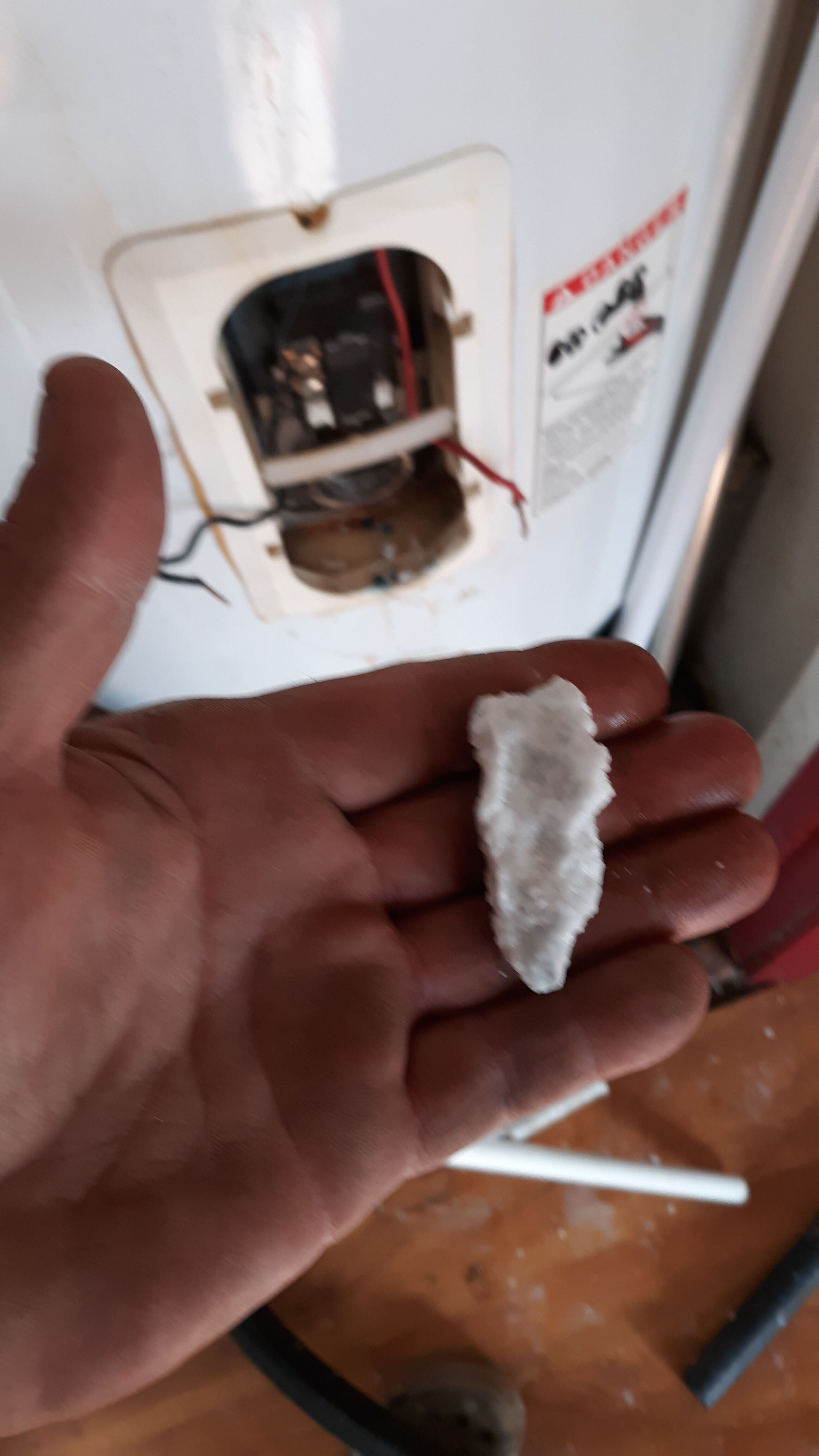

Well, looks like they hooked you up already. Just an FYI, flush out your heater periodically to eliminate sediment accruing in tank. Doesn’t matter if you have well water or city water, tons of crap in water and pipes. My area just had the water lines changed, you should see what comes out of those lines.
Personally I flush my tank every 3months. Some say it’s a lot but I look at it like this, why not do it while changing my whole house filter. Just like every 3 months I pull my septic tank spray pump and clean the screen on it. Maintenance is key to everything lasting and getting your moneys worth.
You might be just right, I’m gonna weigh this up when done

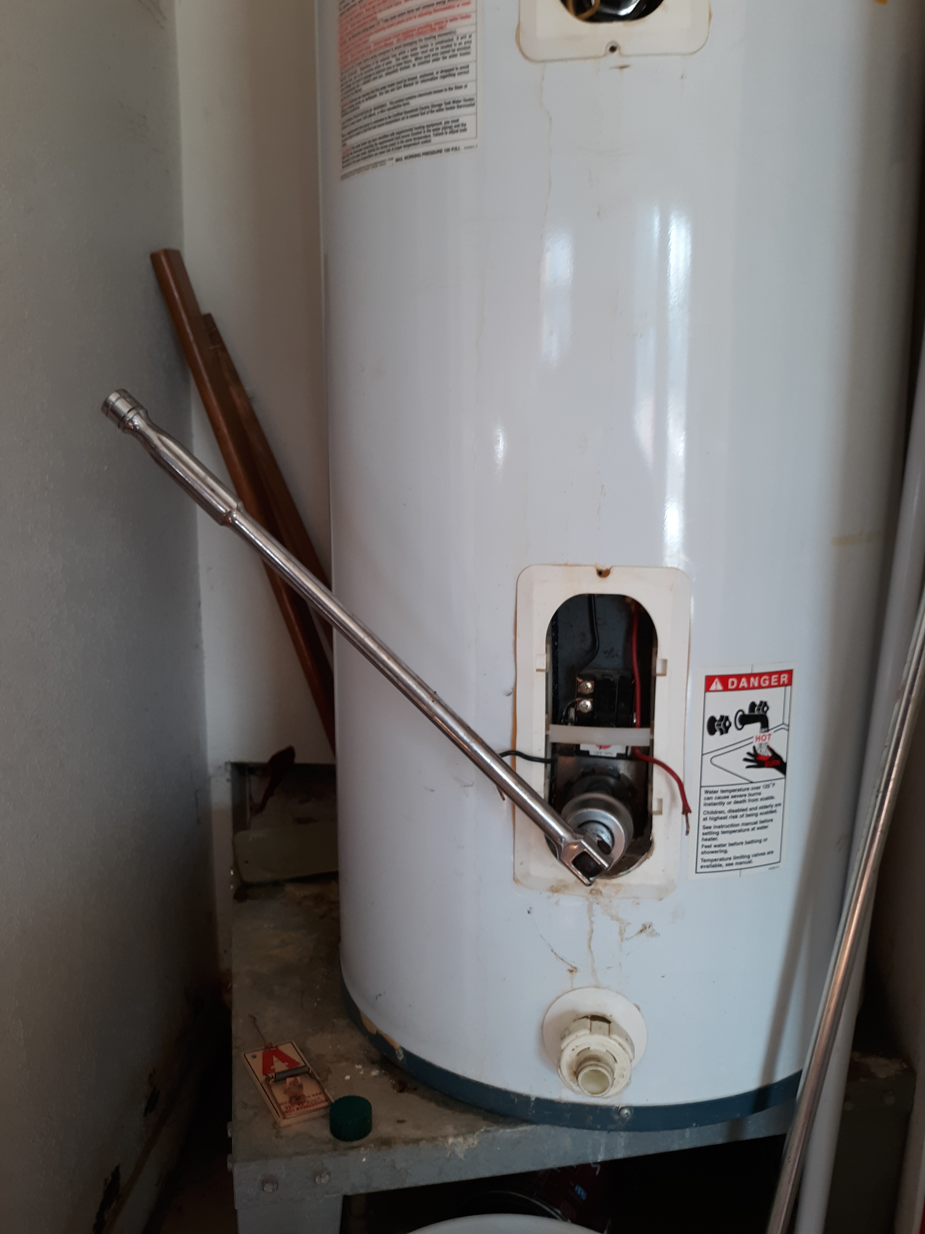

I just bought the place about 3 months ago , I gotta tell ya if I didn’t pull that lower thermostat like @Jake_Lambert said I would of never got these big deposits to drain out.

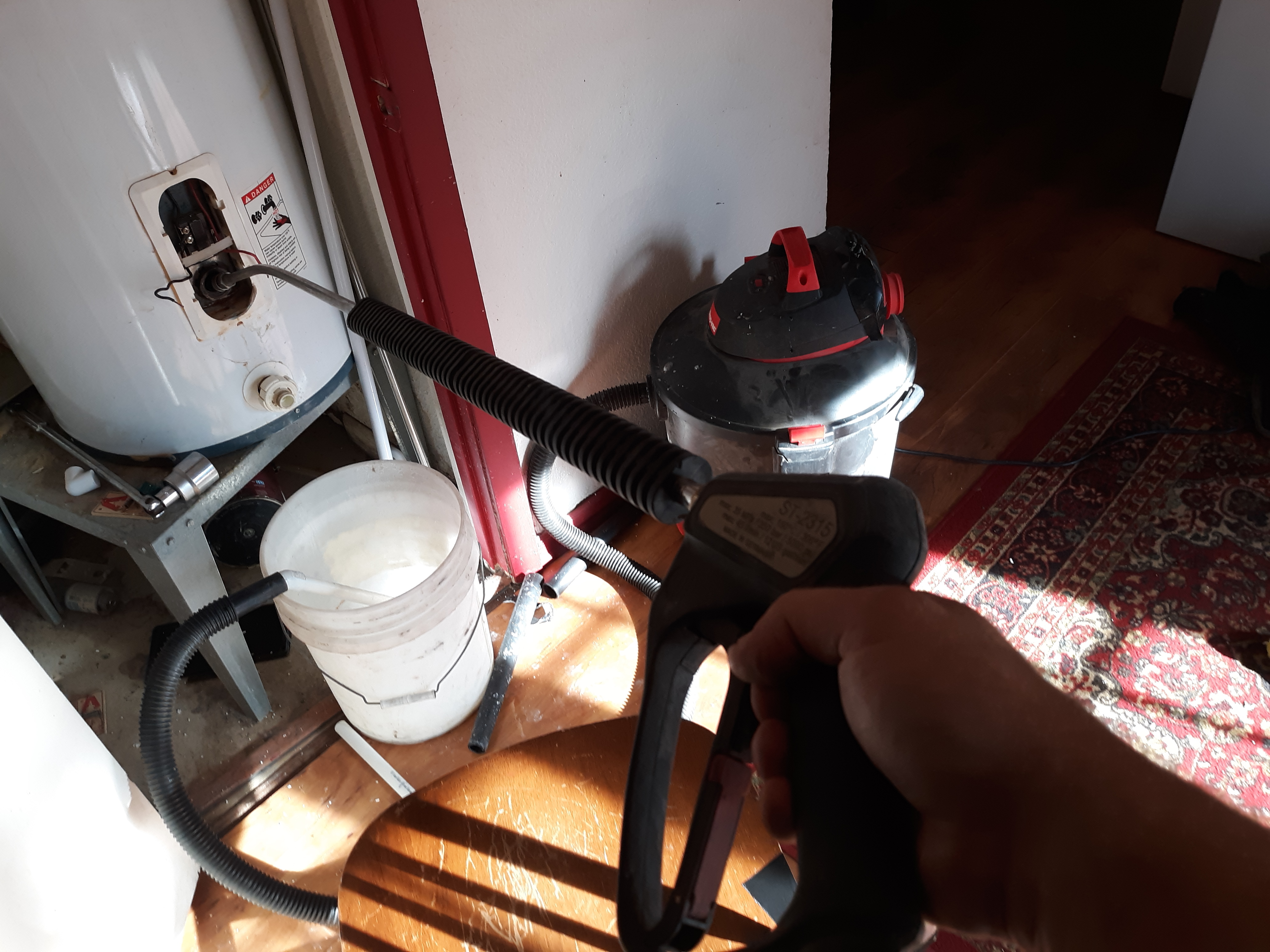

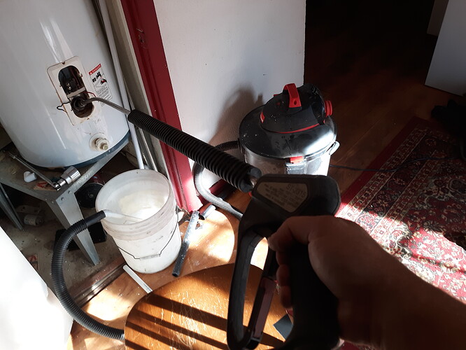

I’m pulling out the gun now to agitate it some more, What could possibly go wrong.
That was humor fellas, only humor :rofl:
Just like a wash guy! Pull out the gun and give it all she got! :rofl:

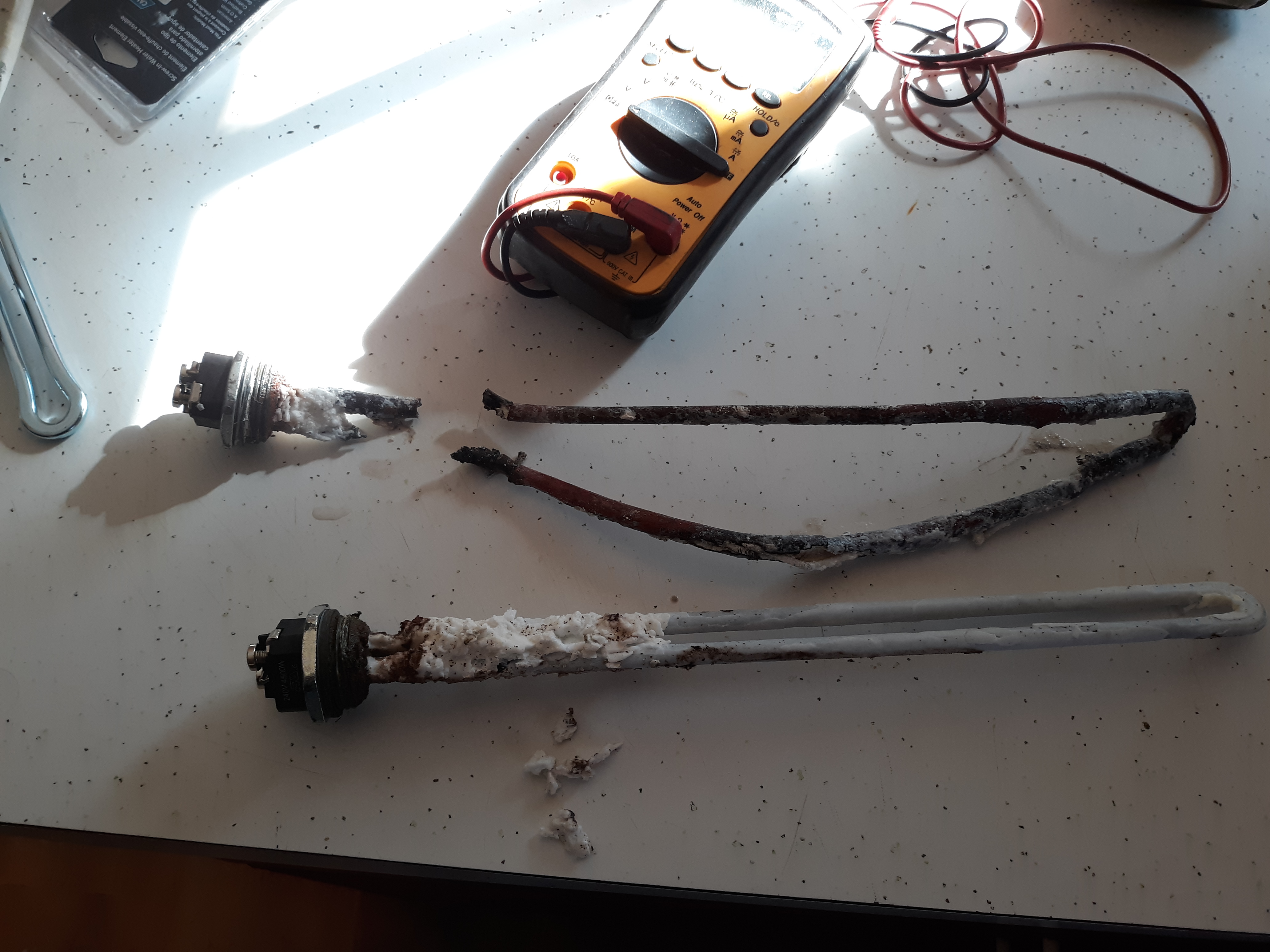

@Hotshot You might wanna check the dip tube and the stick. Before you put water in it chances that you need to replace them also are high
Its still there buddy, spent an hr Inside the HWH dodging the fill tube with a shop vac. Got hot H2O again, wife will be home shortly to test her 1hr shower :disappointed:.

Totally agree. @Hotshot Those elements are going bad quickly because your anode rod is gone by now. In that room, you’re not gonna like replacing that part; it’s 3’ long and screws into the very top. But it keeps the elements and tank from corroding.
You’ll get at least a year out of those new elements before they corrode again, but I’m willing to double down my dollar bet that the tank isn’t far behind! Galvanic corrosion is a pain on wells
Ahh the sctick/ anode rod, that’s what he was talking about @Jake_Lambert . if it gives me 1 more month or so I’ll be happy as a clam. Bought a used house in November then Christmas and purchased a crap ton of chems in December stung a little.
