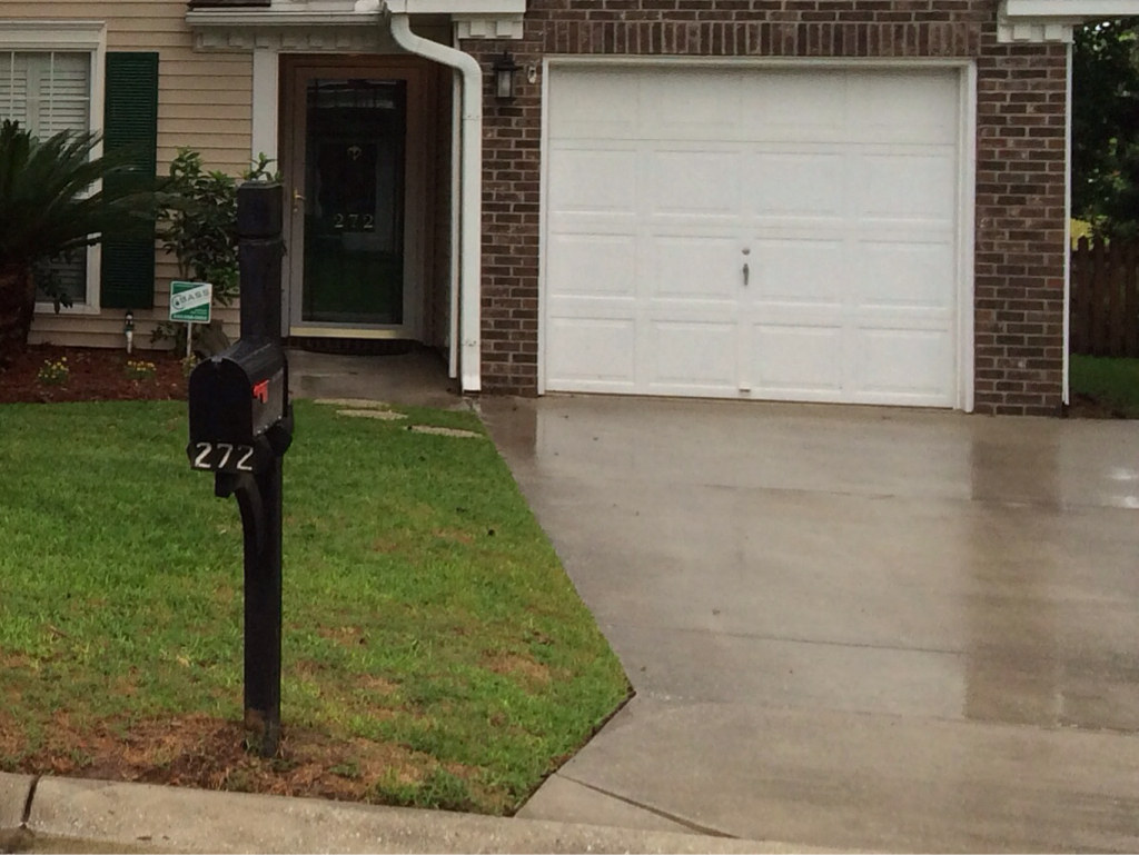

Wash a house and the garage door opener did not work afterward. This happened to me today. The customer said this had happened before a long time ago when she had her old house washed. I really want to help her get it fixed any ideas? We tried the breaker box and nothing. The outlet outside next to the garage door was closed but when I looked closer the black cushions that block the water out were missing. I told her she wait to let it dry for few days.
Happened to me a month ago. Found one of the outlets in the garage was tripped. It was a gfci. Could be a gfci on that circuit. might even be in the kitchen. But it is probably in the garage somewhere. Also could be outside.
agreed sounds like a gfci got tripped… which you should always be doing when washing a home - it is a mandatory practice for my guys to either shut off the power to all exterior outlets at the breaker or trip the GFCI’S while doing a housewash. We had an issue a few years ago with a faulty GFCI that caught on fire during a housewash, I was able to run inside and turn off the power at the breaker and extinguish the fire with a dry chem…got lucky…
She called back this morning and the garage power is back on :slight_smile: Thanks for advice about shutting of all exterior outlets!!! (Something I’ve never thought about before cleaning the house) you may have just saved my butt on future jobs. :slight_smile:
