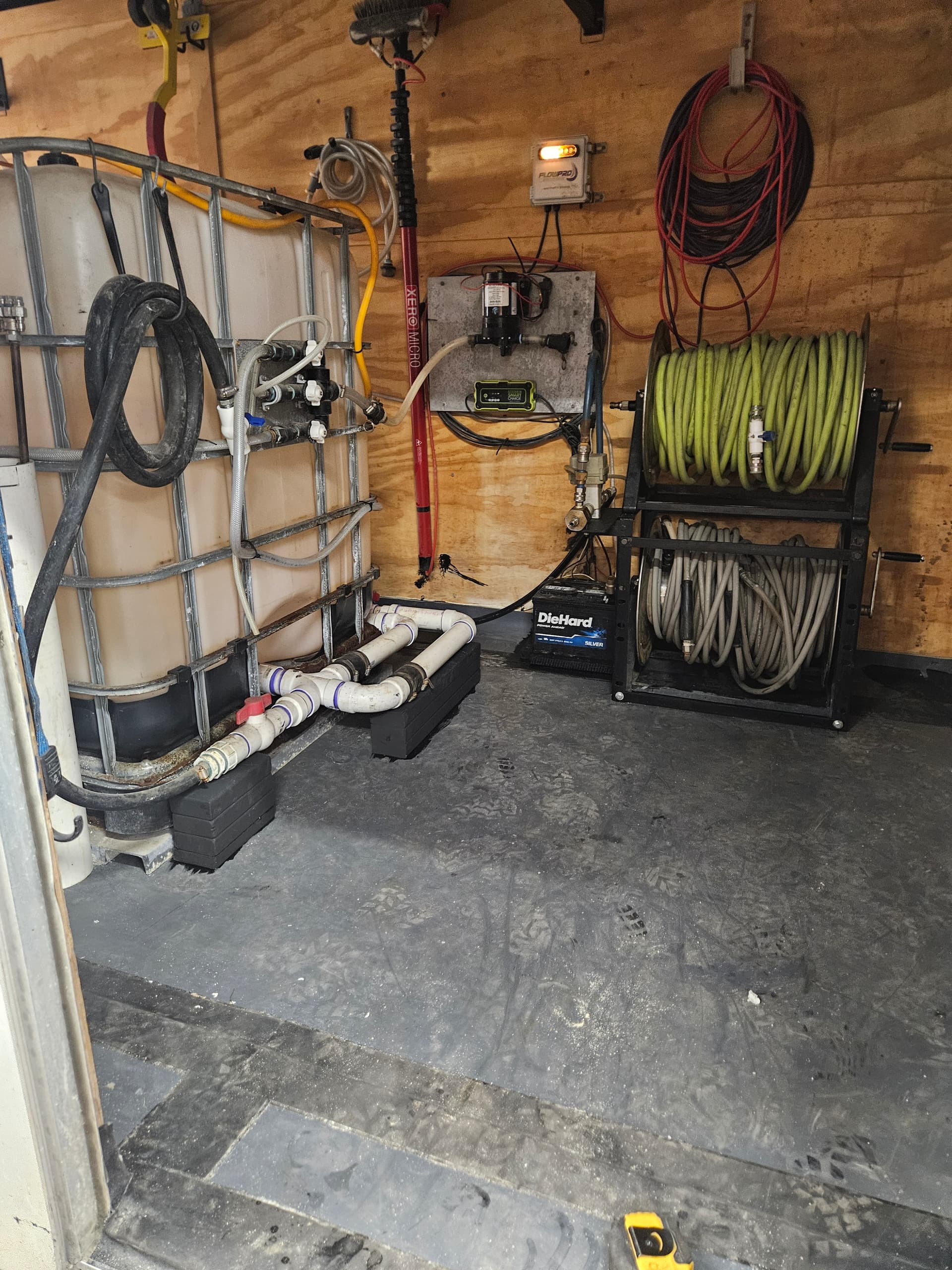

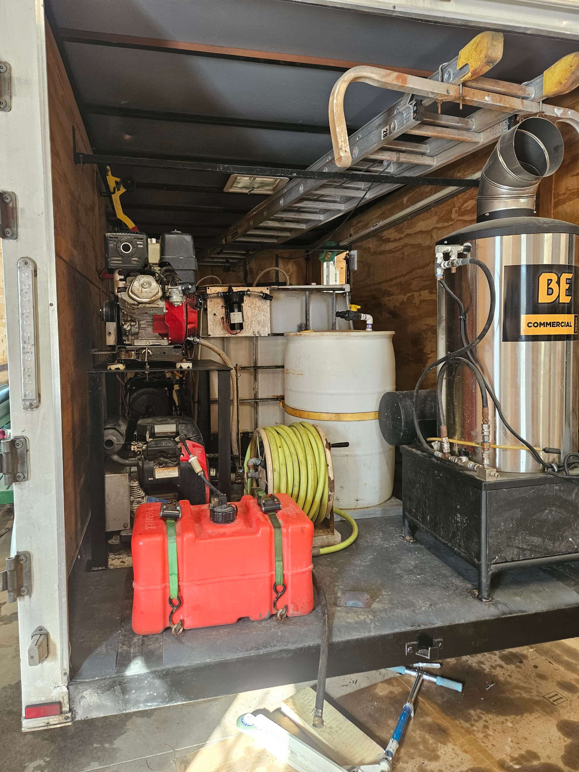

Here is my setup.

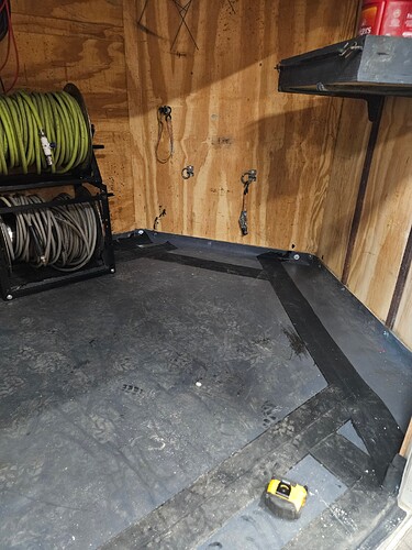

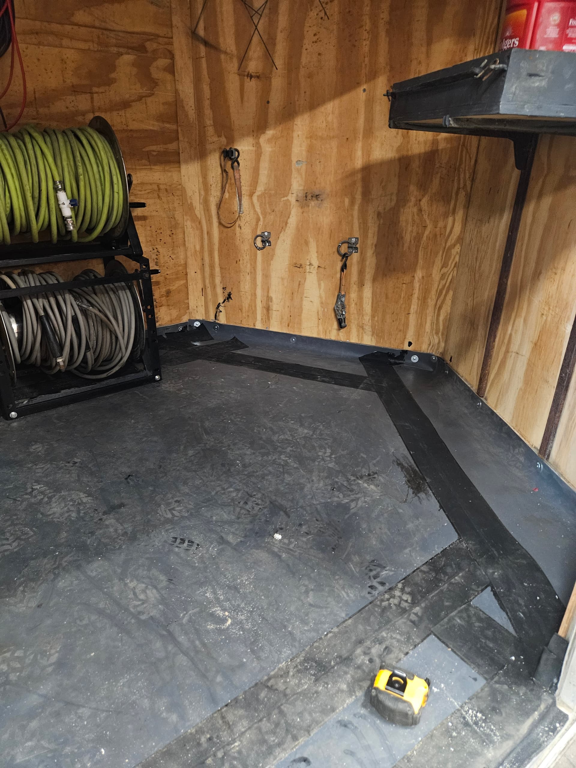

Been running like this a few year’s. Finally got tired of coatings failing on the floor, so i decided to put rubber roofing down.
Extremely durable… wish i would have done it years ago.
