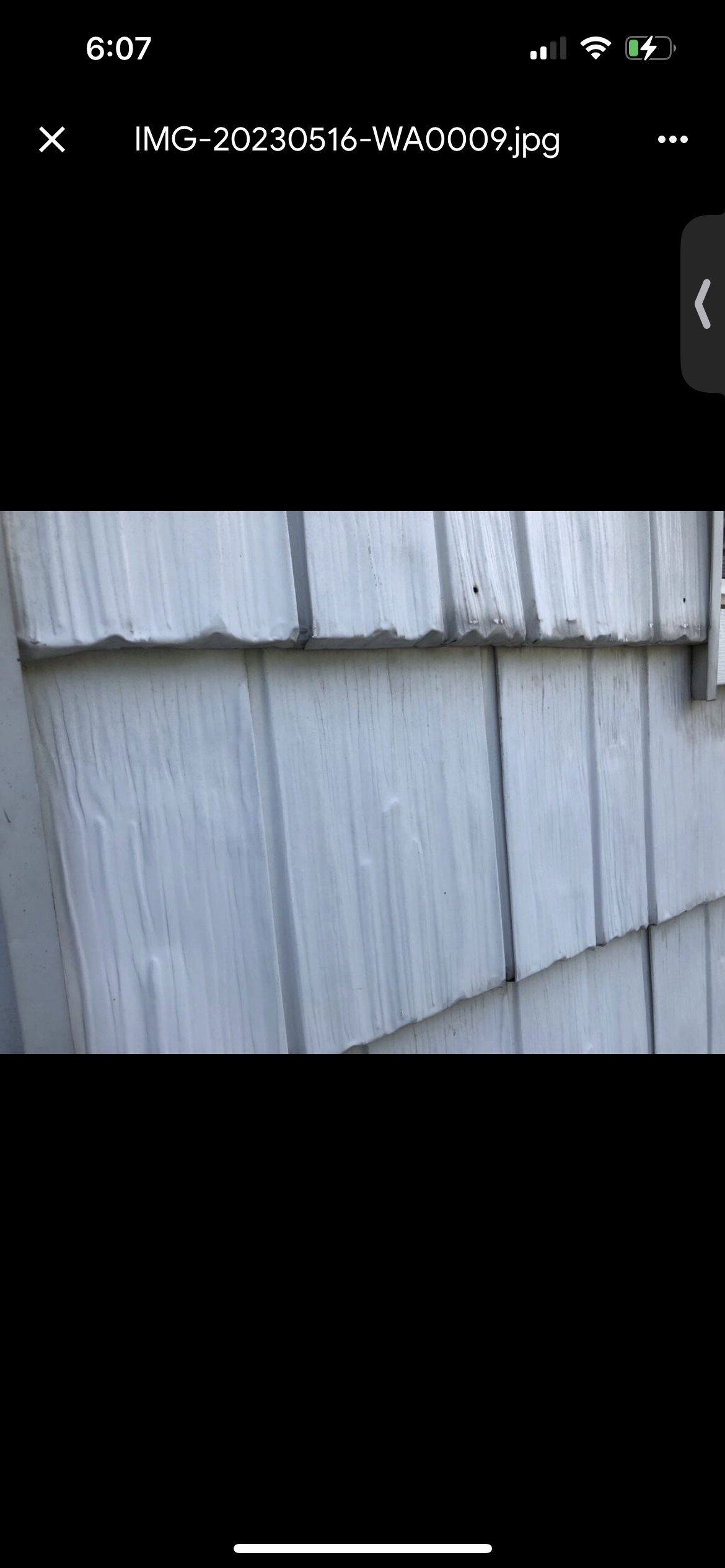

What are their expectation? Shining new ? Green and black gone? Aluminum side will be oxidized bad before you start and very thin paint. Now if they are going to paint it after you finished go for it with even thinking about but get that in writing.
if there’s easier work, run…if it’s oxidized badly (and what aluminum isn’t at this point?), run…if you insist, cut your ratio in half, apply more times if needed, stand further away while rinsing twice as much…but I’ll let someone more technically savvy confirm that strategy if you insist on punishing yourself…

I’ve done several aluminum sided homes. Most were rentals that the owner just wanted to clean up as best they could as there were spots with the paint completely gone. I always set expectations and let them know the possible outcome. To me it depends on the overall condition. A 50-80 year old house that needs new siding is just that. They can risk streaks/bare spots from oxidation runoff and get a much cleaner look or they can save their money and put it towards new siding.
One of the things I do is I team up with a painter and deoxidize aluminum siding so he can paint it. Try and find a person to team up with periodically if you have any interest in this. I’ve washed aluminum, but I have also people that it needs to be painted. Aluminum washing experience will kind of teach you which to tackle and which ones to walk away from. As @Cougar_Bait said, you have to set the expectations if you take it on. I wouldn’t quote an aluminum job without looking at it first, especially the aluminum that has already been repainted.
