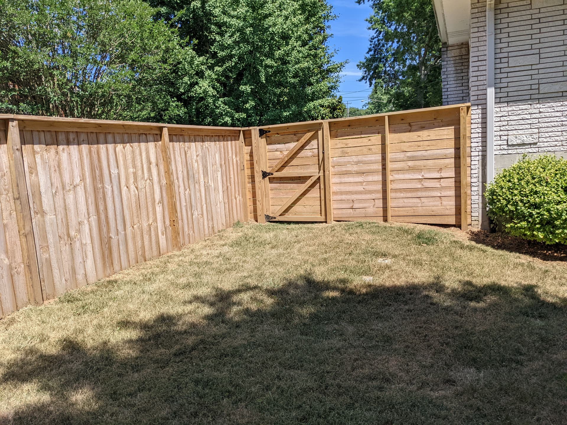

I’ve got a fence to prep for sealing and it’s damn near clean already. Any advice on method? I’ve got some powder sodium percarbonate, powder oxalic acid, SH of course…
But this is so pretty already… think I could get away with a low dose SH and some as needed fan tip action on the panels with the black marks?
Suppose I may need to treat everything equally?
There’s 285 plus 100f of fronts… Maybe only 150f has any algae/mold.
