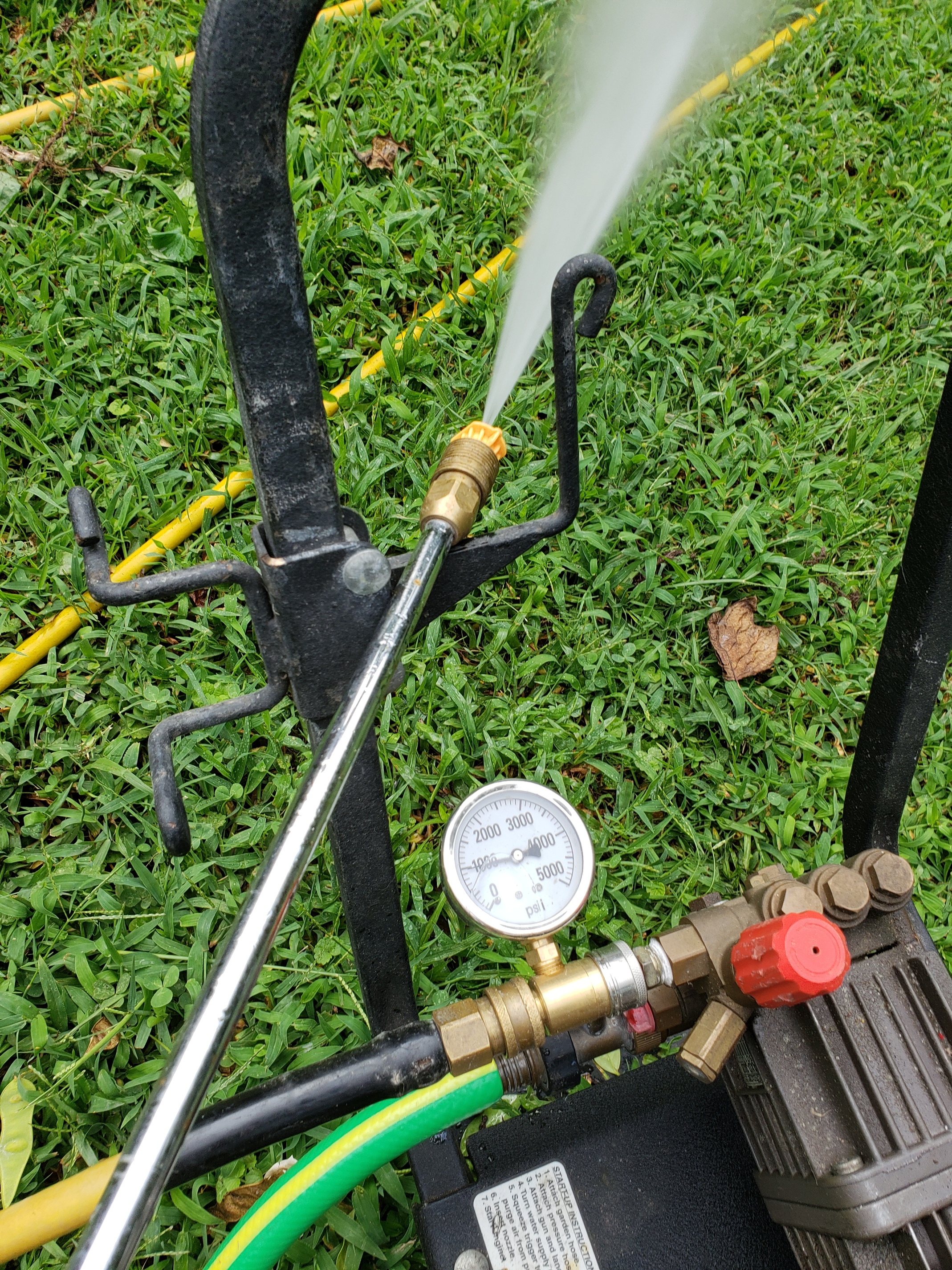

So I “revived” this thing, after my dad had trashed it. New carb, new oil in the pump, some fittings blah blah
It’s advertised to run at 2000 psi at 3 gpm. I’m only getting about 1000 when I’m operating it with a 15 degree tip (cleaning my brick house) with the correct orifice size. See pics. I should add by rough math my water supply is upwards of 6 GPM via 5 gallon bucket and stopwatch test.
It DOES hit 2000 psi when it’s idling, but under what I would call load, or spraying, it sits around 900.
Is this how it’s supposed to work?
edit attached pics this time

Unloader issue?
Make sure the throttle is wide open. Then crank that red knob to the right till u get 1800-1900psi
on the trigger
Also make 100% sure u have the right tips. Bucket test the pump and match the tips to your actual flow, not what you assume the flow is, trust me on this one!

I will try to get a new spring in the unloader and see if that helps…
