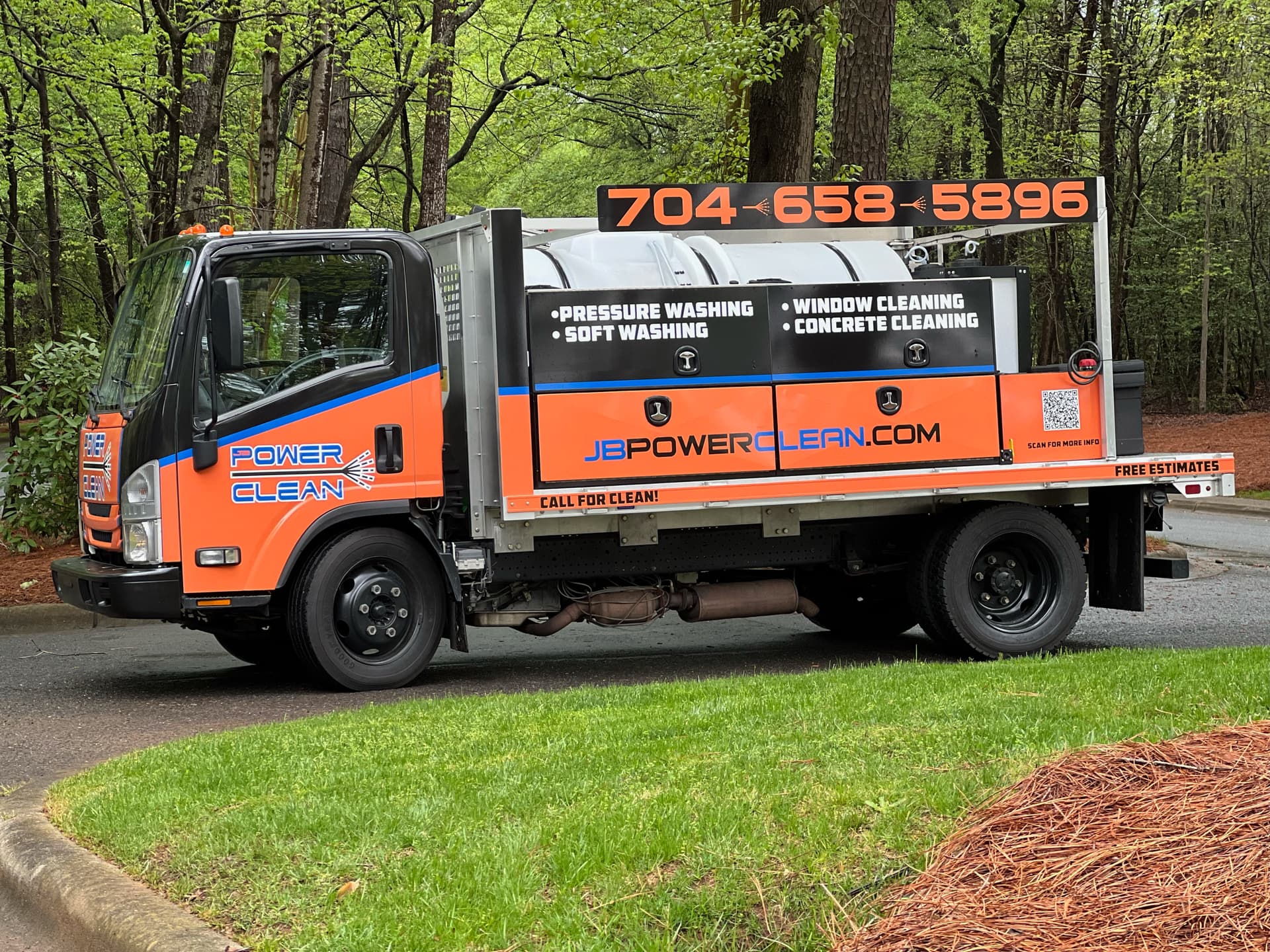

Man, I love this, keep posting. Is that a new Isuzu chassis or did you clean it up and paint?

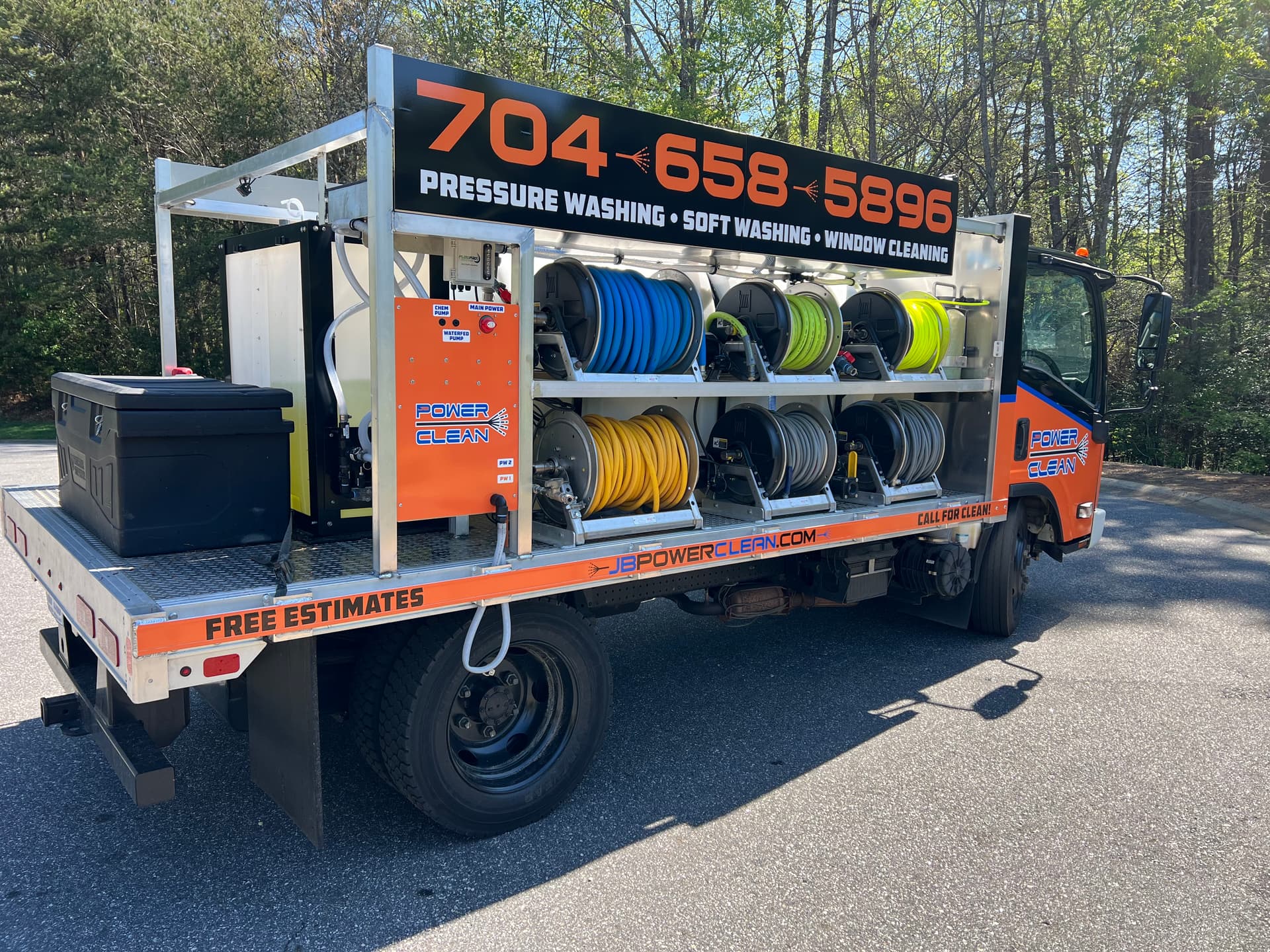

Who’s flatbed body is that? And who the heck is doing all the aluminum fabrication?

The Isuzu is a 2016 NPR HD has a GVWR of 14,500. I cleaned the chassis up with some Hot Stain Remover. It cleaned up surprisingly well. I have had a few ask if it is a new truck. I shopped having the aluminum flatbed custom fabbed vs. production unit. I went with the EBY body for price, time (still took 2 months for delivery), integrated hitch and overall look. Not a fan of the bump rails but they came with it. The additional aluminum welding is being done by a local fab shop. I considered getting a spool gun, but talked myself out of it.

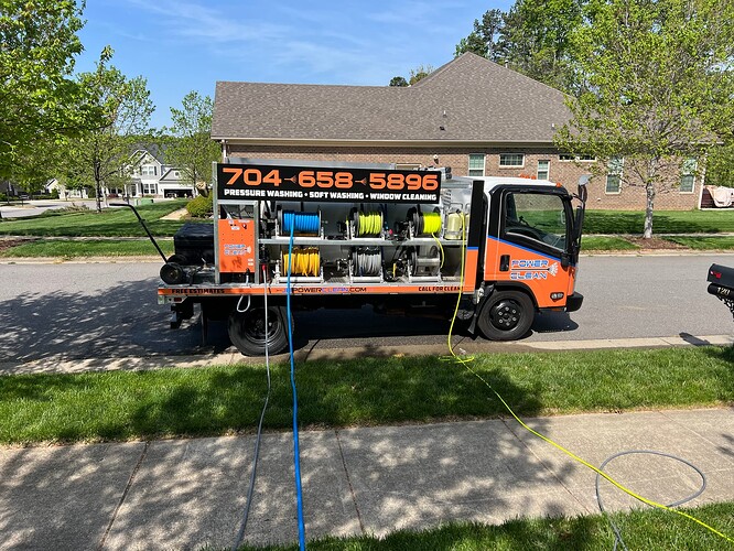

As for the hot water, I have a hot water unit on my current (see pic) primary trailer. I just don’t use it too much. If that changes, there is room for a hotbox on the flatbed.

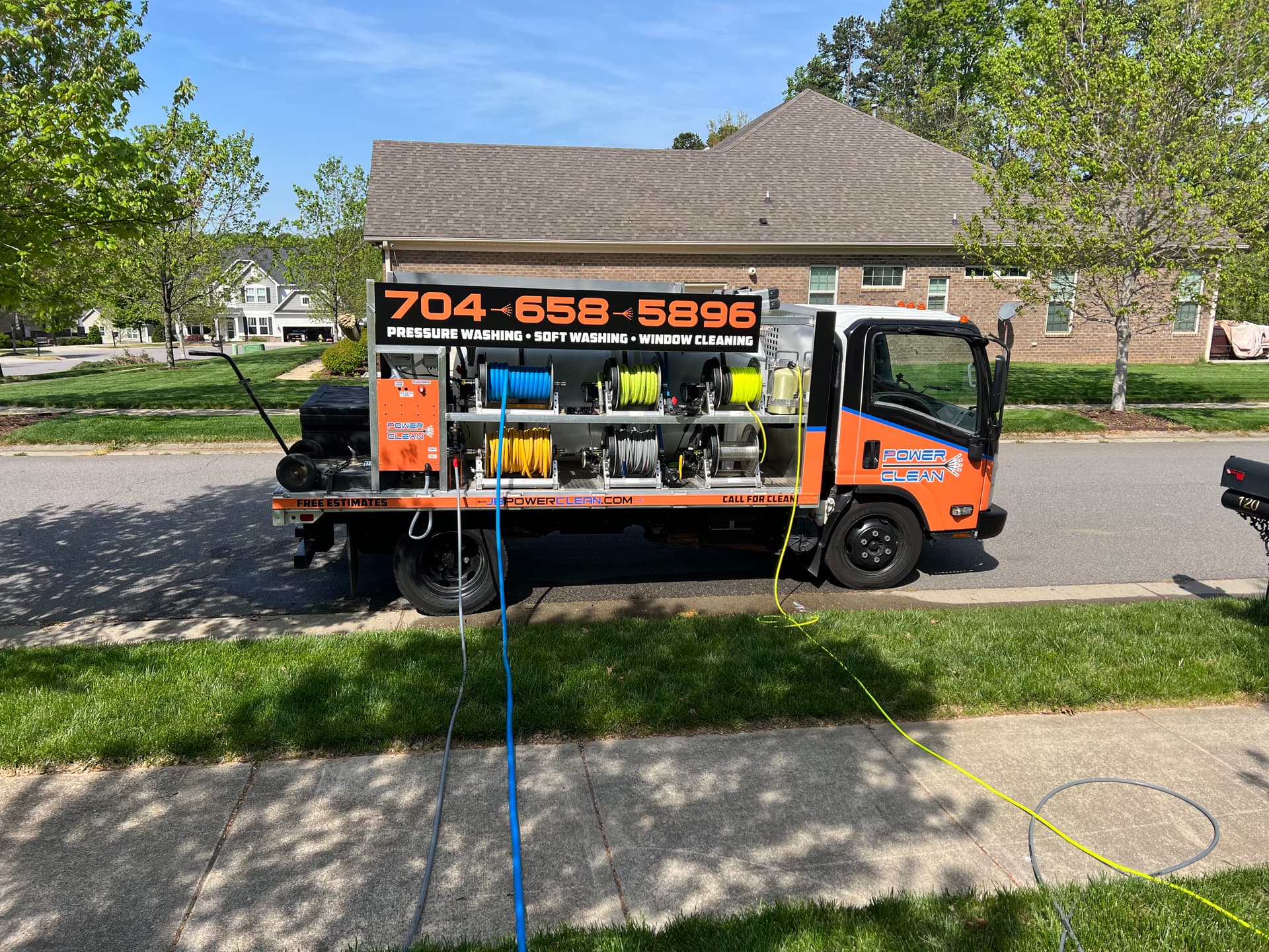

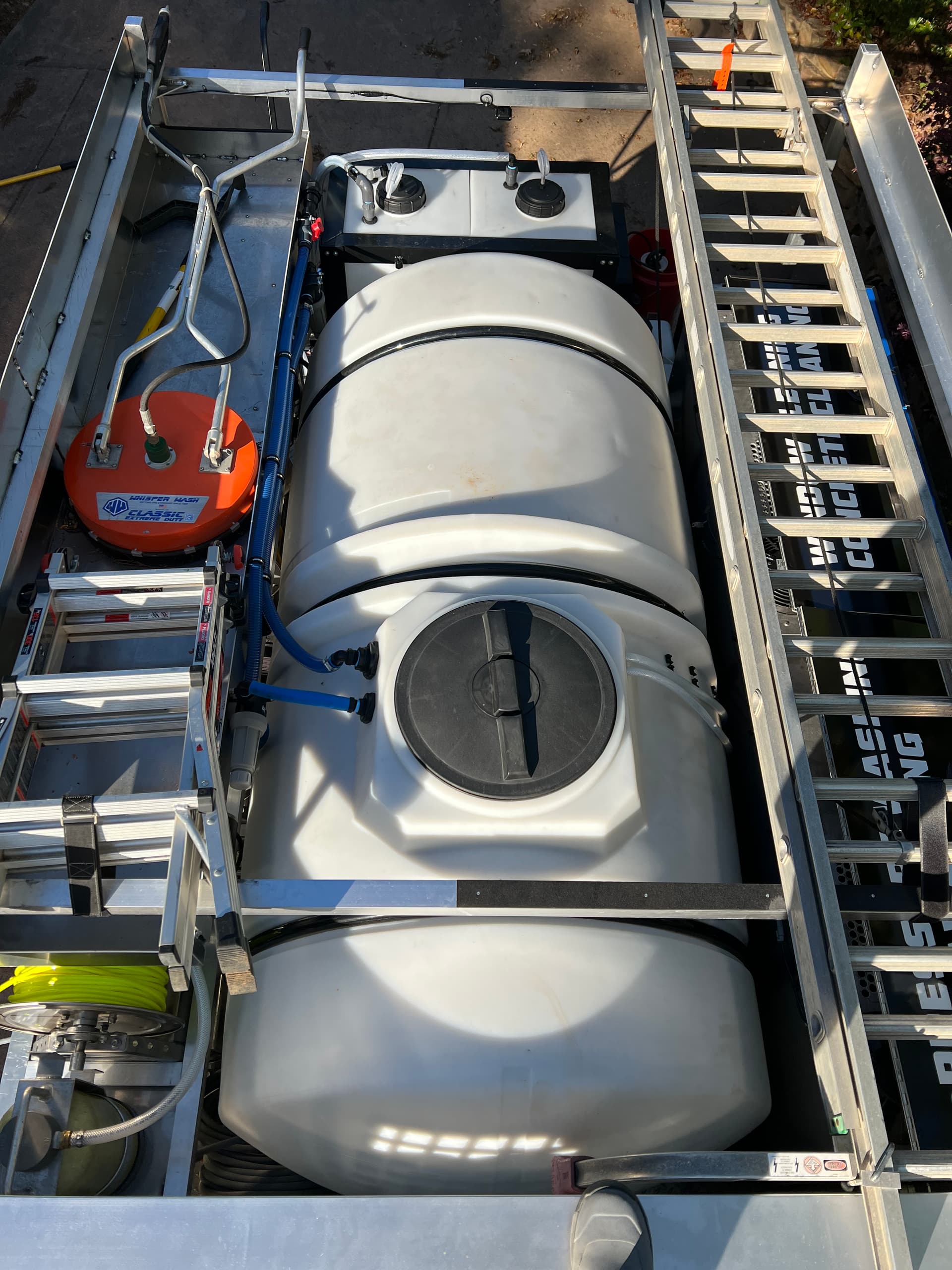

Here’s a little update. I have been busy getting this thing completed on top of the start of the season. I just got it back from getting a wrap last week. Next goals are a surface cleaner drawer/storage and gun storage.

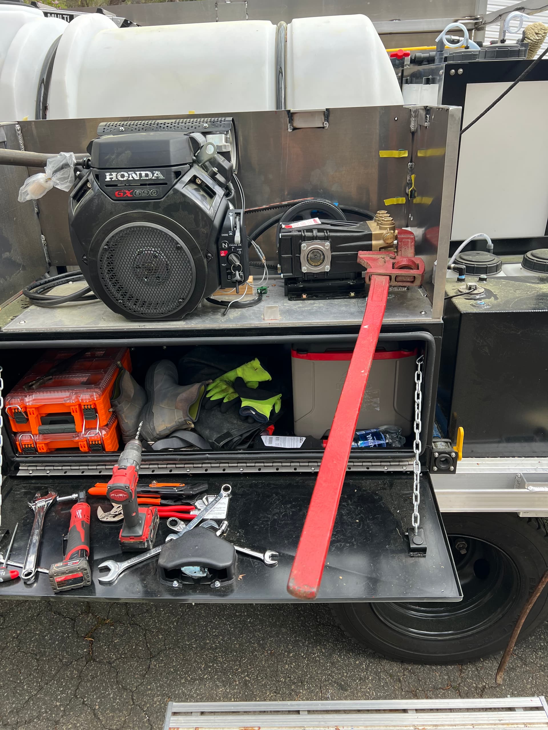

I hope Off Duty doesn’t yell at me for mistreating this new Udor with a 48" pipe wrench!

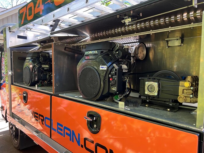

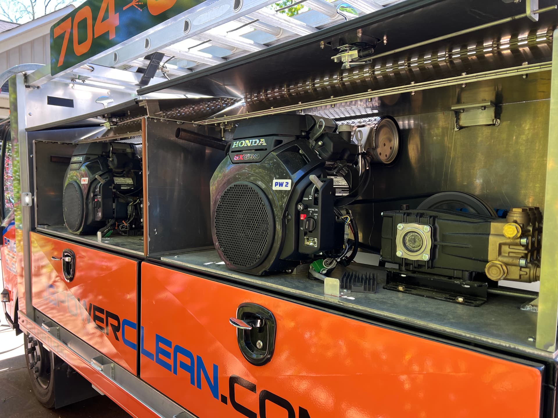

Looking great. Where are machines mounted? Got a top down view?
They are in the black boxes with blue stripes. I will get a picture today and post. That last picture shows one of the units before the box was assembled.

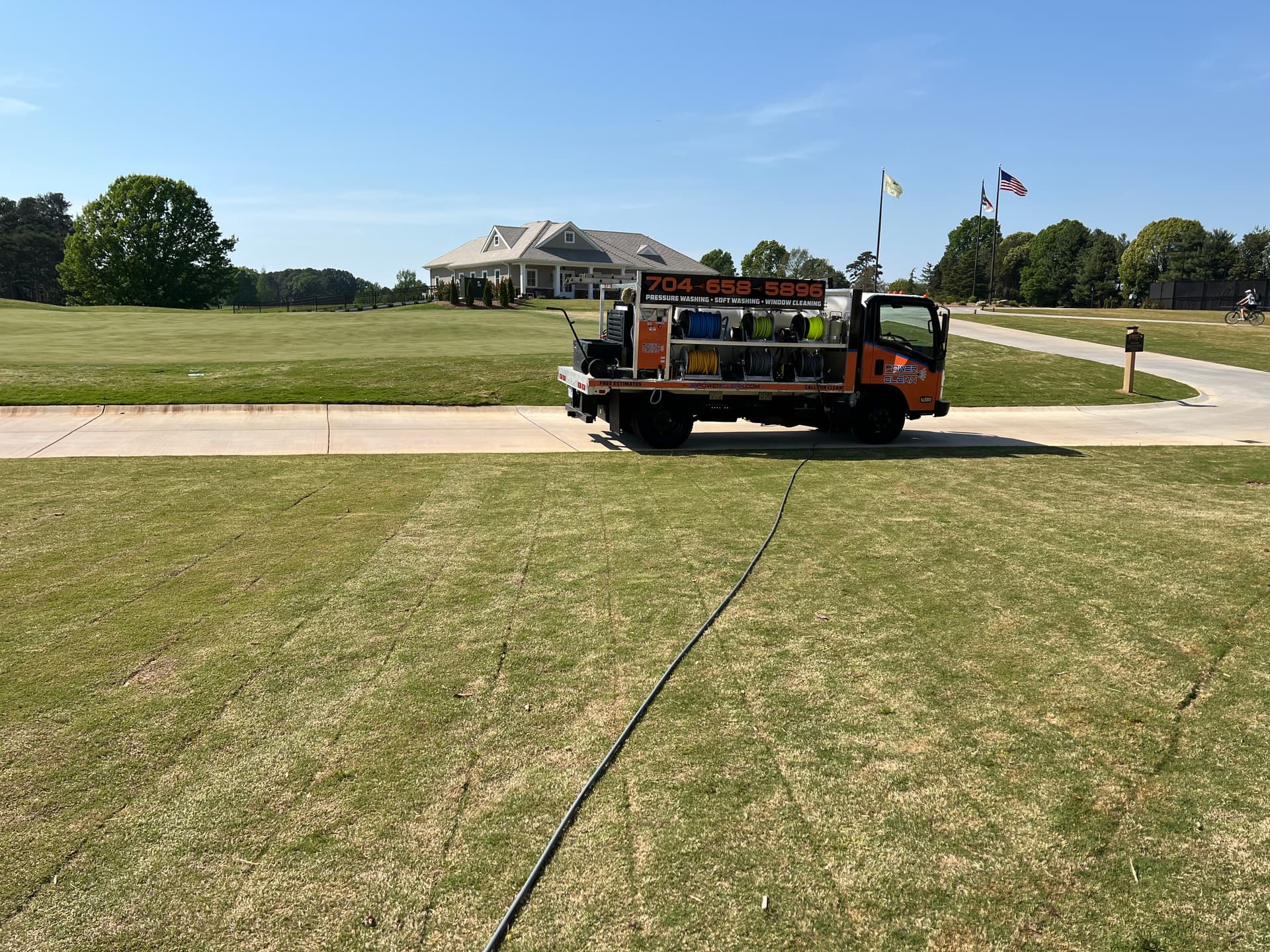

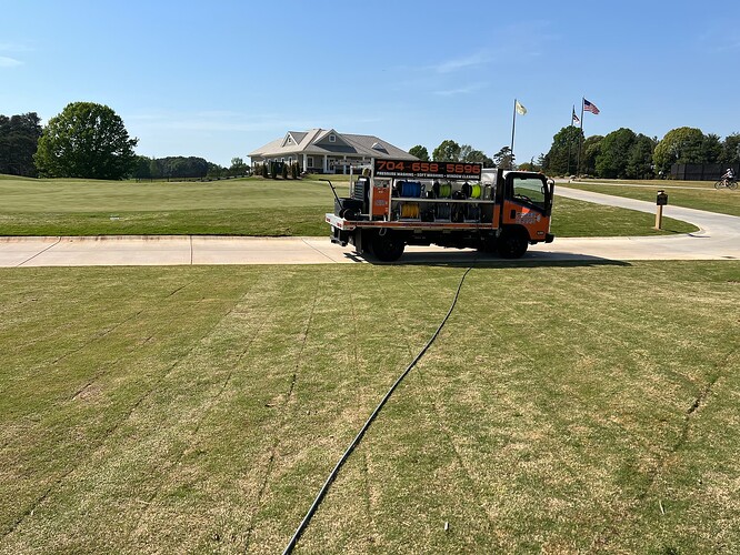

I finally got a video of the truck uploaded. https://youtu.be/BZwUpAAtQOw?si=UYk4EjET0PN17CBm
Awesome rig!
Definitely get those waterfed poles inside some pvc or something else to keep them out of the sun, though. The UV will eat up the carbon poles over time.
