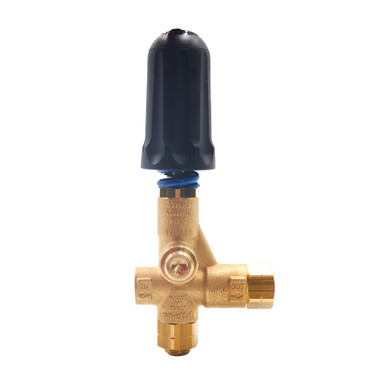

Could one just place a cap on that unloader and replace a cap/bolts for a k7?
Maybe, but he’s asking about bypassing, he’s got a direct drive and the K7 would be worth more than the pump.
K7 $120 plus parts and labor…
Better save and get a belt drive.
Here you go, kit for less than $100
greencanpump.ca storewide free shipping
PA Unloader Valve Pulsar 4/Rv – 4500 PSI 10.5 GPM – Plumbed unloader with bypass kit US $85.00 / EA
