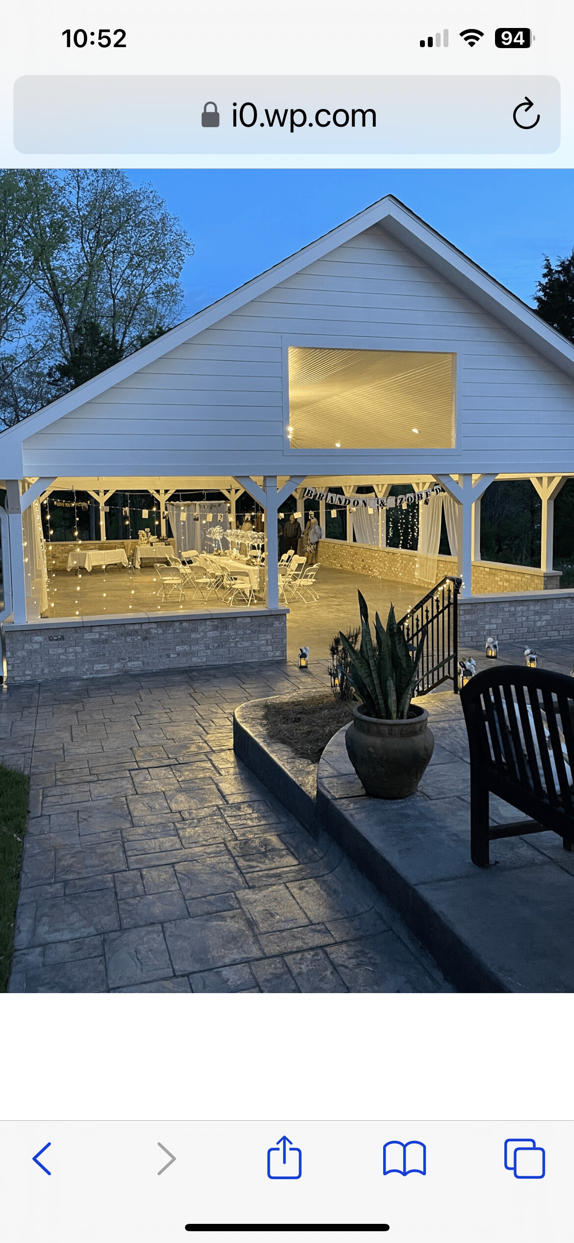

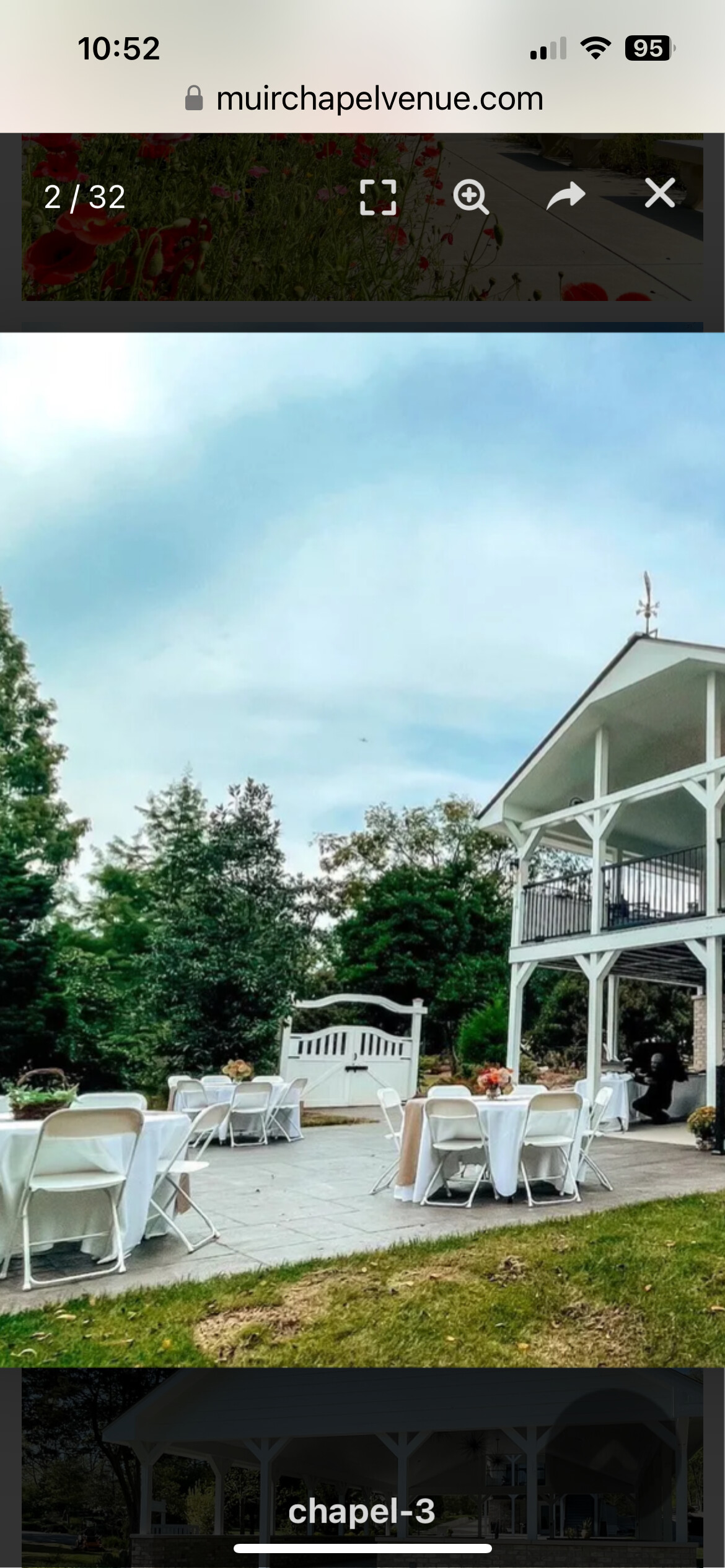

I’m headed there now, will take some pictures and get more information. By the website pictures it looks really glossy.

He said it was done a year ago, unknown sealer but definitely glossy. Stamped and colored concrete. The ‘high traffic’ areas are obviously worn down and need resealing but a walkway on the side in the shade still looks pristine.
