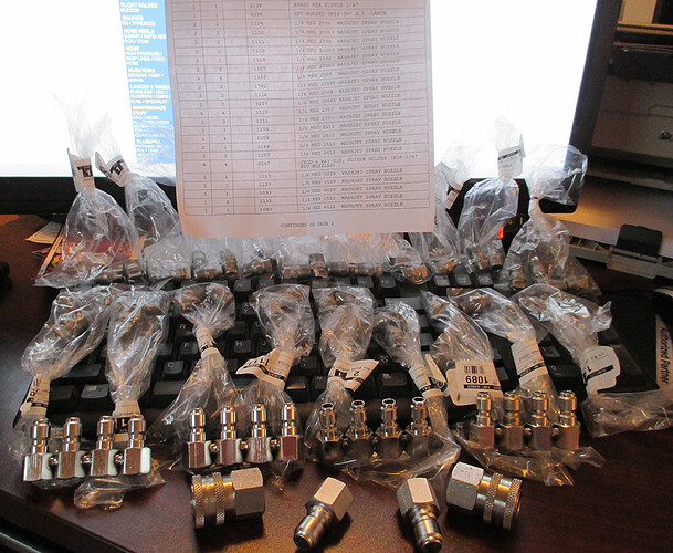

And I just got a couple of bags of tips from Bob.
