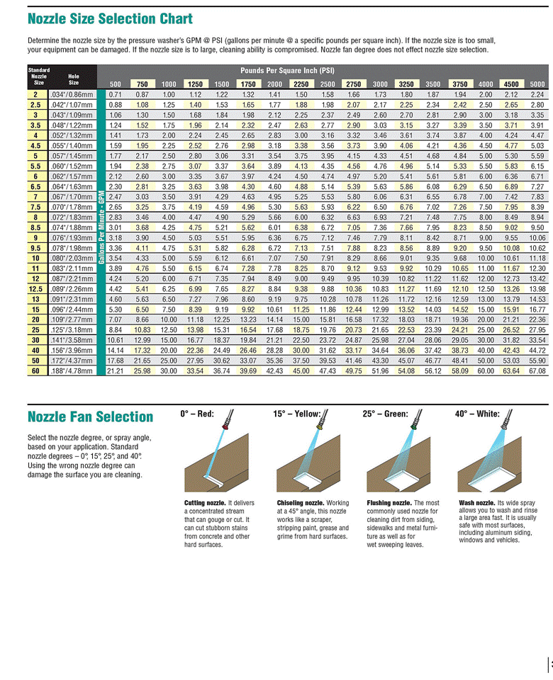

Take a look at a pressure washing nozzle chart…
Lets say your pump is rated for 4 GPM and 3000 psi… If your unloader is set properly, regardless of what fan spray (0, 15, 25, 45, etc) using a 4.5 sized tip you will be putting out near max at 3,000 psi… but if you move to a bigger sized nozzle like a 5.5 your pressure drops down to 2,000 psi.
Heres the numbers i found on the spray tip 357 , 4.130 and it says 1/6 but i know that doesnt matchup with hole as i cant get a .040 drill bit in there as 1/6th of an inch is .166.also pump is rated at 3400 and 2.5 gpm supposidly.
So according to the nozzle charts, for a 2.5 gpm pump to output 3000 psi you would need a size 3 nozzle (.043)… which it sounds like you have based on the markings you posted. If you aren’t reaching the rated psi with that tip, then you need to adjust the unloader so it’s set to peak at 3,000 psi. YouTube is your friend for learning how to do this.

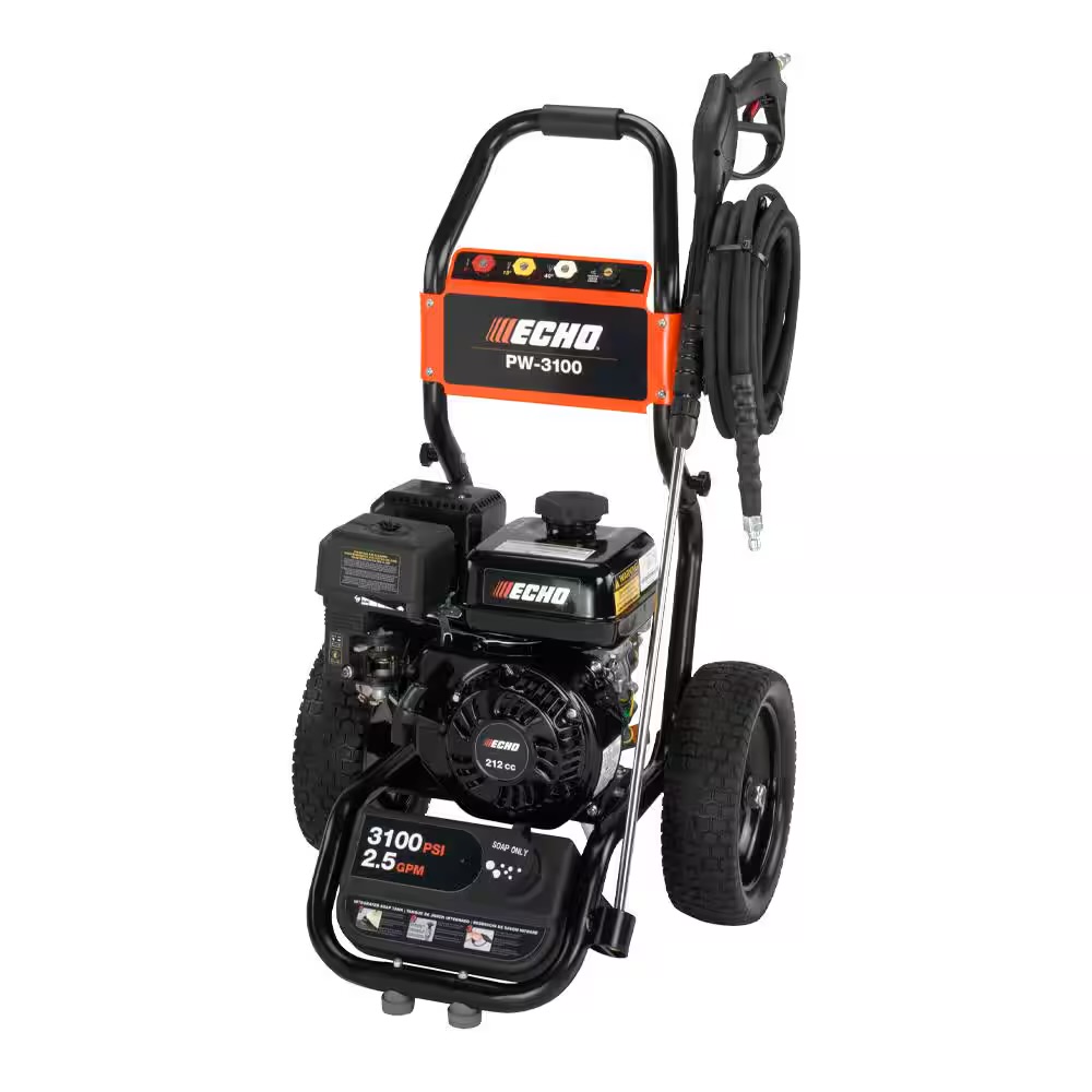

I think we’re trying to diagnose a homeowner grade 2.5gpm machine. If it was more in the commercial side of things we could help better.
I suspect this is close to what he has.
Ya its a home unit,I pulled out the unloader and center pin is free and the rest of it moves freely, thats bout all i did today watchn pre season FB

No, It’s completely dependent on the nozzle size you are running
Buy this set in a size 3.0
Put the yellow or green tip in your gun
Set the unloader to 3000 psi and never touch it again
Use different size nozzles to decrease the pressure
