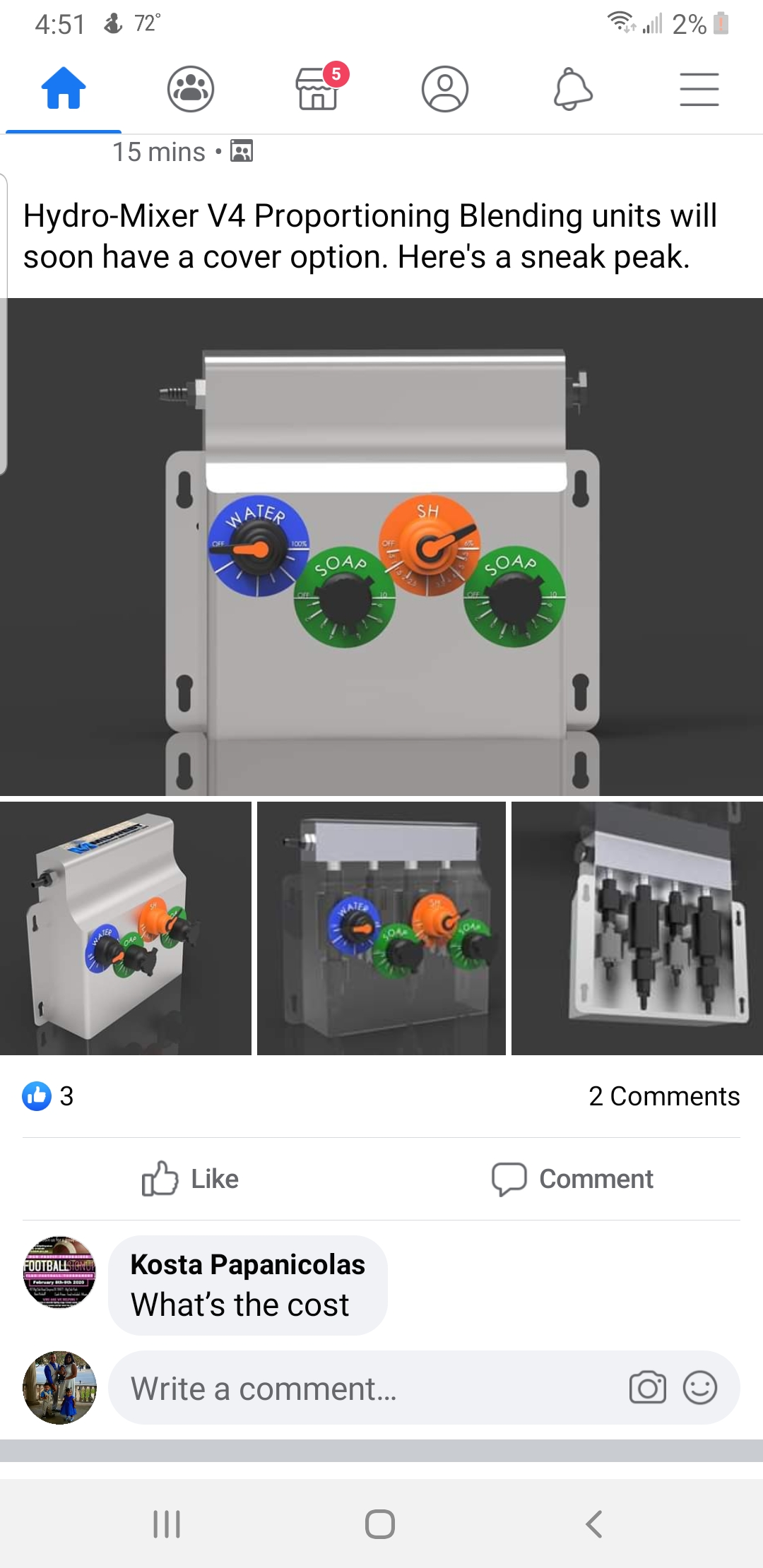

Bahahaha. Sorry but i had to
I knew I wasn’t the only one!
